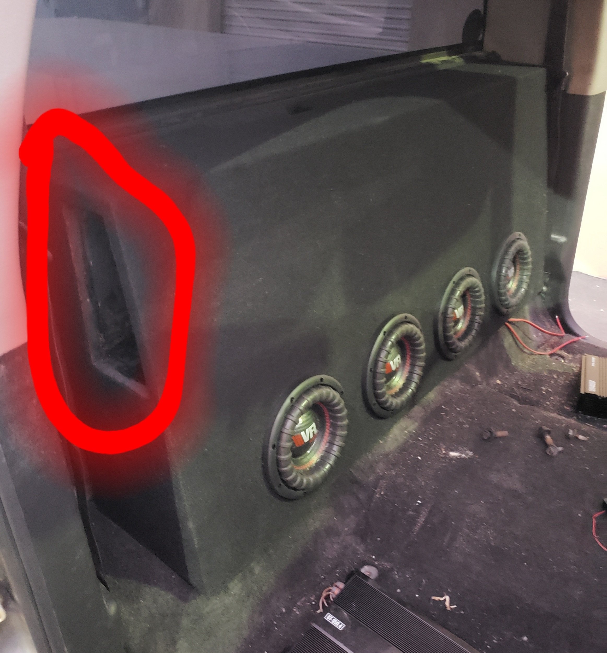

To be honest, I have a very large box for four 8's. I have over 4 cubes net after sub and port displacement. Plus, I have a small cab and 3,000 watts on them. But, two of them in a standard cab on 1,000 watts should get down. I got the VFL's because the mounting depth is about 5-⅜" with a good size magnet (120 oz.). And, they were only $110 each.

Also I looked up the video and he states he has an octo port. What is that?
Octoport is fine, just meaning an 8 sided port that saves a little airspace. A simple slot port or an aeroport is all you need. I have a "simple" port and it tears shitt up.
