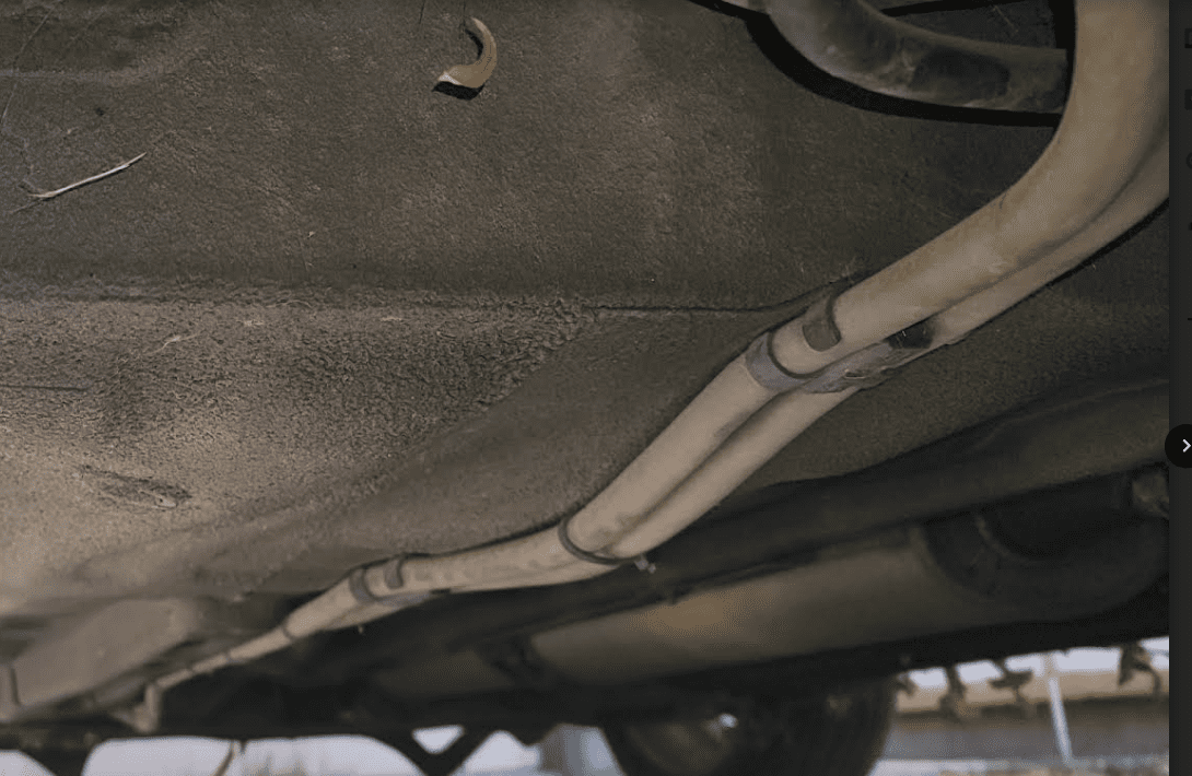

I do run Ancor marine grade tinned high strand OFC copper 2/0 from front to back, etc. As long as one provides the plumbing, the current will flow.

My 2/0 gauge was already there, If you got it, use it is the motto I live by. ;)
