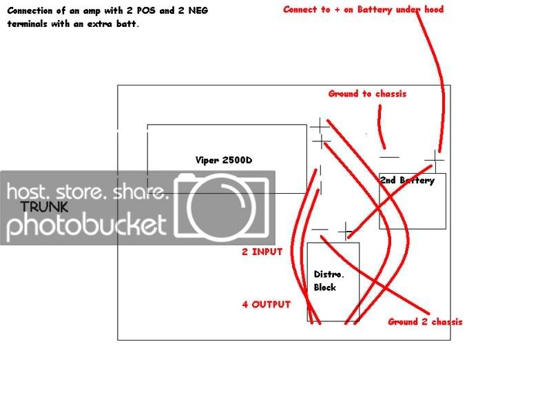

I need amplifier wiring help.....
you will need to run the 2d bat in series with the front one so it is part of the cars charing system.
there will only be 1 remote wire terminal on the amp.
I would run 1/0 from the front to the 2nd bat then from there into a distro and split it into 2 4 ga to the amps power terminals.
ground the 2nd bat and the amp to the cars chassis
ok i was wondering how the batt would stay charged...ur steps are pretty self explanatory....I may have got it.
Preciate the help.
you will need to run the 2d bat in parallel with the front one so it is part of the cars charing system.
fixed
Am I in the ballpark..........
