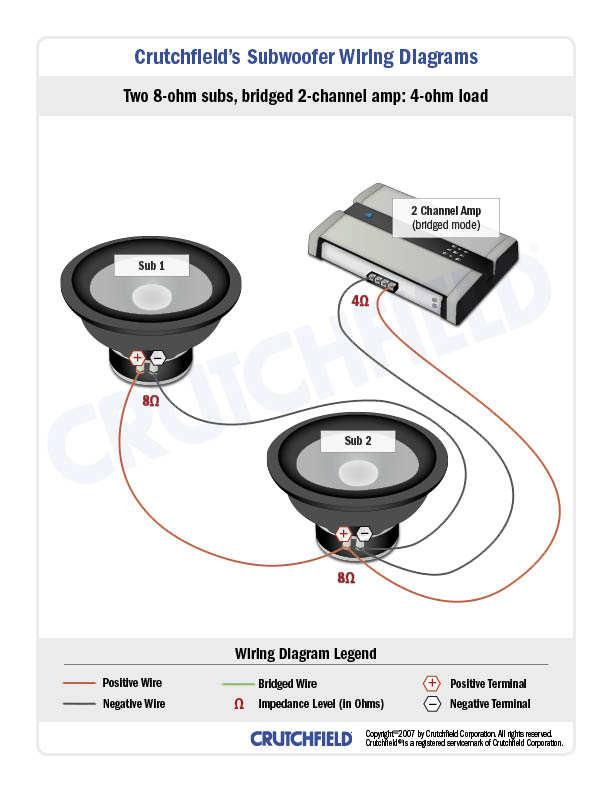

Ive also already got 2 amps I can use for these, Ive got a Scoche 2 chanel that does 65rms @ 14.5 X 2 and a Dual 4 chanel amp that bridged does 150 X 2 @ 4ohm
So I should be ok for powerring them with one or the other

Oh ok didnt know that never works with 8ohm before. It does 250 bridged so that should be ok.
