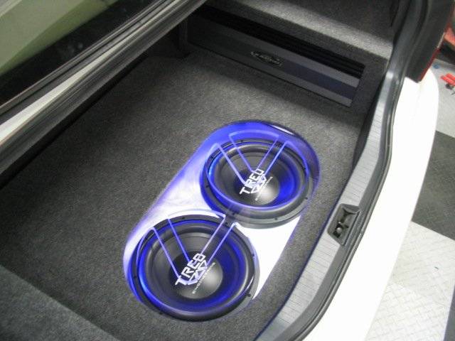

my DREAM for the trunk would look like this... but i dont know what it would cost to do something similar
or this
not so much the custom design on the glass... just the overall clean look

What I'm not sure about is your sub idea from the picture. I don't know much about flushing subs into the spare tire space, but I can tell it's mostly geared towards aesthetics. Make sure whoever does it, ensures it is also good for SQ and not just looks. Having a great sub in the wrong enclosure will make it sound like crap.
