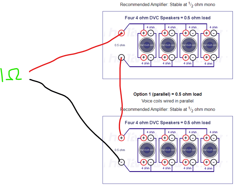

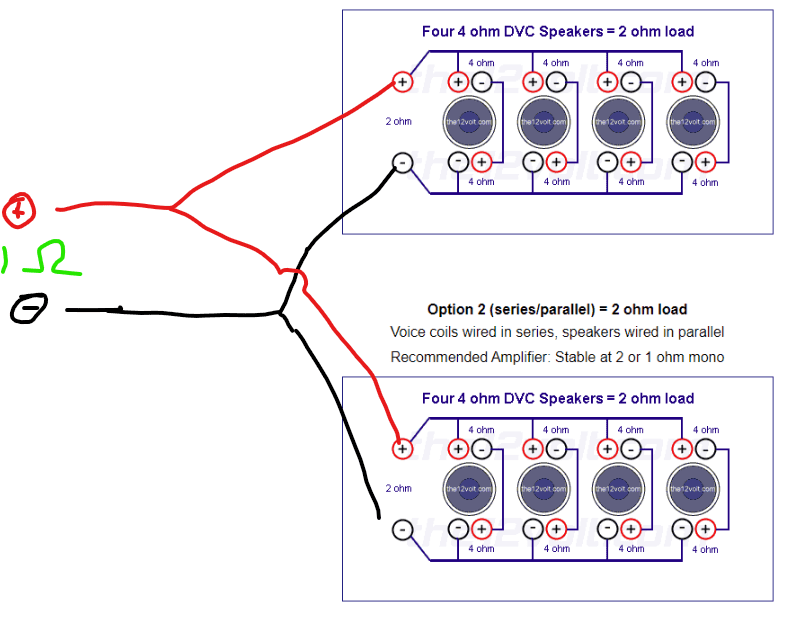

I have 8 Rockville W8K6D4 V2 dvc 4ohm 1400 peak 350 rms 8” subs. I’m gonna wire them to a Taramps bass 3k 1 ohm 1 channel amp. I’d like to wire everything to 1 ohm
Geez, my brain hurts. It's a series parallel configuration. You will need to run a 4x4 and parallel the two groups.
2 groups of 4 woofer series/parpelle like this then the two groups in parallel should get you to 1 ohms.
