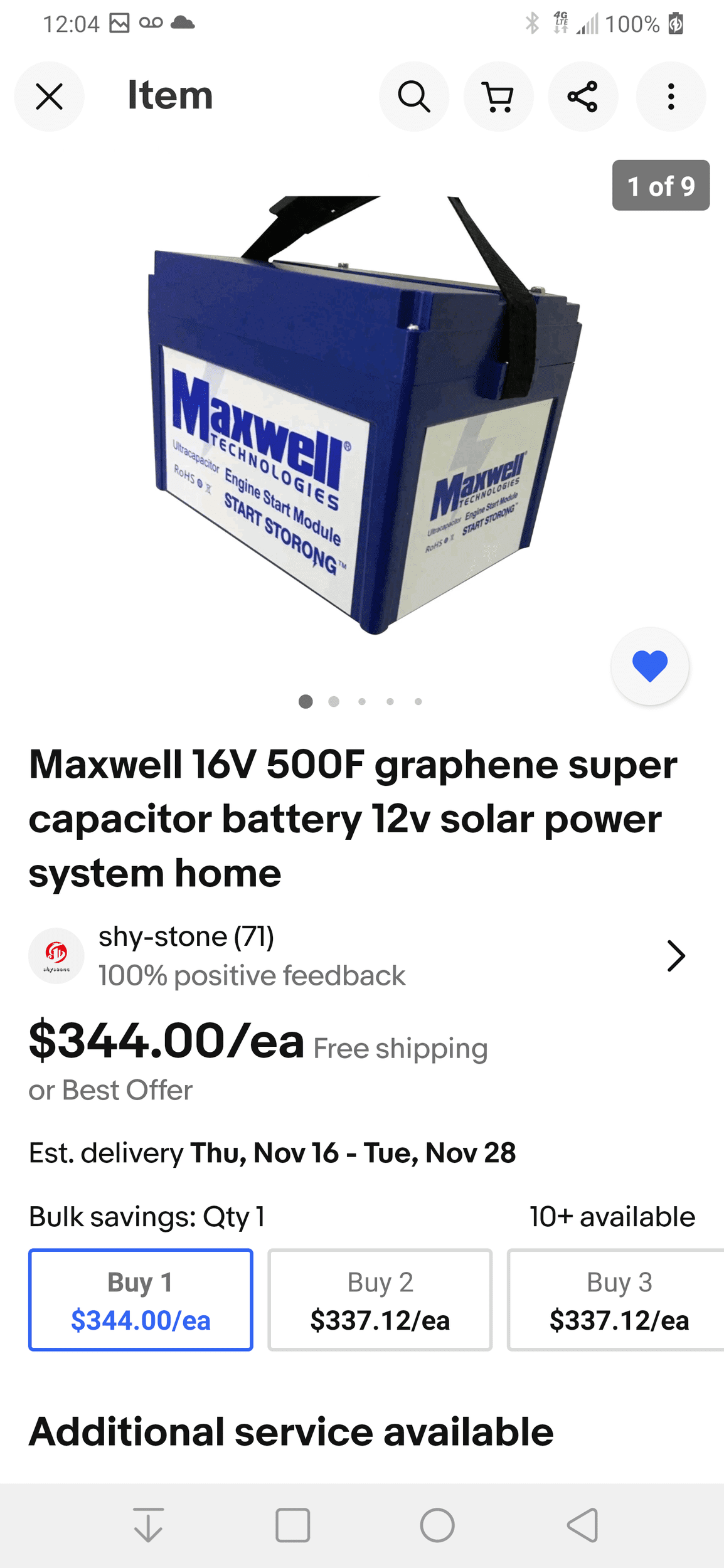

Not a LiFePO4, but Pops mentioned a Maxwell graphene supercap a few weeks ago. The YT video made it sound very convincing. TBH, I am not stoked with my Ioxus supercap so I have been eyeballing this product.
Question... it may have been you who mentioned why this is not a good option but I can't remember when. Thoughts anyone?
The battery that you linked to is not made for high current discharge. They are made for steady charging and discharging like for a camper. If you look at the FAQ section of the link, you will see that they don’t recommend using these batteries for starting a car. If it can’t take the amperage of a starter, it can’t handle the peaks of car audio either.
That's right, that's what I recall too. What kind of specs would one be looking for regarding in/out discharge ratings?
99% if not 100% of the cased lithium batteries you find online will not work for car audio. They are all solar batteries with low charging and discharging rates. The only one I can recommend is the Glowe Voltage.
