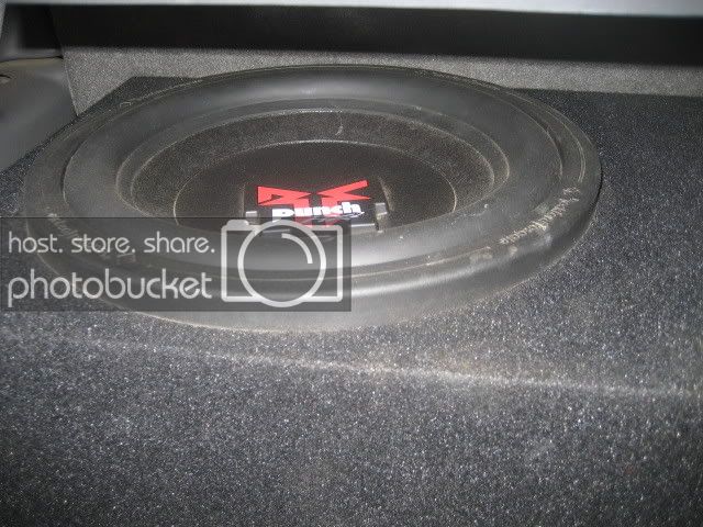

I love mine. Had them since 00 and they have been great. They get low and loud enough for me. Each one of mine are in 2.0ft³ with a 4" aero port tuned to 32hz.
Here is a pic of mine.
