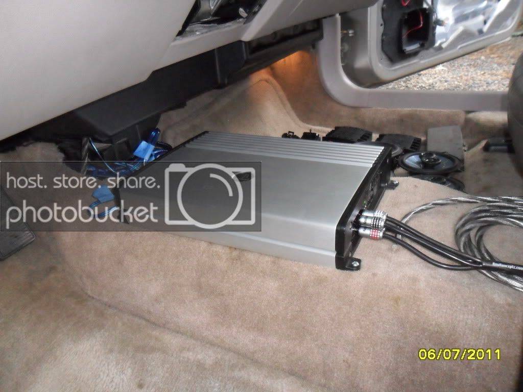

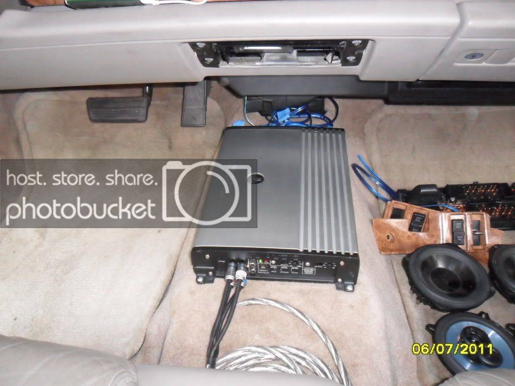

Well I've got my amp grounded to one of the mounting studs for my drivers seat. Look below ive got pictures of how the amps set up. I didnt have the whine before I put the amp in, and I had been running that deck for a few months. The deck is a Pioneer DEH-P8300UB. My power and speaker wires are a little bit bunched up as you can see, and my RCAs drop right down out of the bottom of the dash, running under the carpet to the other end of the amp.

Looks like a Buick.
I'd build a shroud to hide the amp wiring.
I agree that seatbolts are not safe nor adequate grounding locations. too much resistance. you're that close, just ground the amp and head unit at the same point on the chassis (floor).

I talked to my friend today who had the same problem and he agreed to just go to the floor. So I think Ill just cut a hole in the padding thats under the carpet, wire brush away the paint, and just screw in the ground right there.
