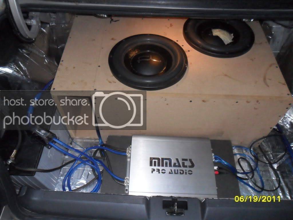

this is how it is now. its in there alot tighter and the board that its on is screwed to the trunk floor in the back. and what do you mean trunk or hatch? haha its already in my trunk
And i got that noise filter hooked up but the daamn thing makes my bass quieter! its basically acting as a high pass filter set to like 40hz //content.invisioncic.com/y282845/emoticons/verymad.gif.3f39c5c2fd57527b671fad3efdfac756.gif so now i have to head up to radio shack and get some couplers and stuff to hook it into my 4 channel rca's. cuz the input is a male plug and the output is female plug. and i have no room where my head unit is to put them in there so i gotta hook them in right before the amp
Did you try the red on both sides, then the white on both sides. It may be a bad cable.

You just found your own solution. Move the DSP elsewhere. The RCA is triple protected but not the RCA plugs. I do not know if there is a mesh or...

Disconnect the RCA's or hi-level input to the JBl amp. turn the system on, If the noise continues, it's a ground or noise issue with the amp.If it...

Yes i know that's what i was planning on. Unfortunately the rvca's are a little difficult to gain access to. My other thought was to wrap a wire...
