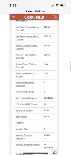

I bought a ported sub box for my 07 f250 crew cab with .7 cuft airspace for each 12"sub (×2). Bought polyfill to make up for the recommended .8cuft for the subs. If I wire the subs together(+ to + ,- to -) and wire that to the amp will I be pushing 2 ohms at 500rms? Or should I wire it a different way?
Pioneer TS-A3000LS4 12" subs ×2 12"
4-ohm shallow subwoofer
Sensitivity 88 dB at 1 watt Frequency Response
20 - 1000 Hz Max RMS Power Handling-400
Peak Power Handling 1500 (Watts)
Max rms power handling: 400 watts RMS (1,500 watts peak)
frequency response: 20-1,000 Hz sensitivity: 88 dB mounting depth: 3-1/2" cutout diameter:
10-15/16" sealed box volume: 0.5-1.0 cubic feet ported box volume: 0.65-1.0 cubic feet
Pioneer GM-DX871 AMP
mono subwoofer amplifier 300 watts RMS x 1 at 4 ohms (500 watts RMS × 1 at 2 ohms) 800 watts RMS x 1 at 1 ohm
CTA-2006 compliant Class [ V amp technology frequency response: 10-240 H variable low-pass filter (40-240 Hz, 12 dB per octave) wired remote variable bass boost (0-18 dB
I myself would wire to a final 2 ohm load on the subs. follow the wiring diagram as it shows. No short cuts on the wiring. id use a minium of 12 ga OFC wiring from the amplifier to the subs as well. Thats me though. I think youd be pleased at that ohm load and the amp will work fine, though may be lacking some power for my liking. Though, may be all you need. if you havent bought that amp yet. Id recommend a CT Sounds class d 1k giving a little head room to run a bit cooler and giving the RMS final power load without maxing the amp out.
not if you set the gain correctly. heres how. theres test tones at the very bottom too...
