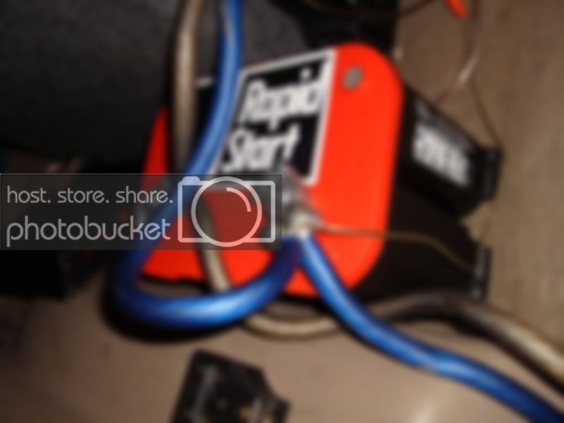

mine goes from the bat to the amp. and i have it grounded at the same spot my amp was grounded to and it works perfect
ok cool, any more pics? and, then would a hifoics amp be good? i was thinking of buying one. or what other amps would be able to power the Rs?
