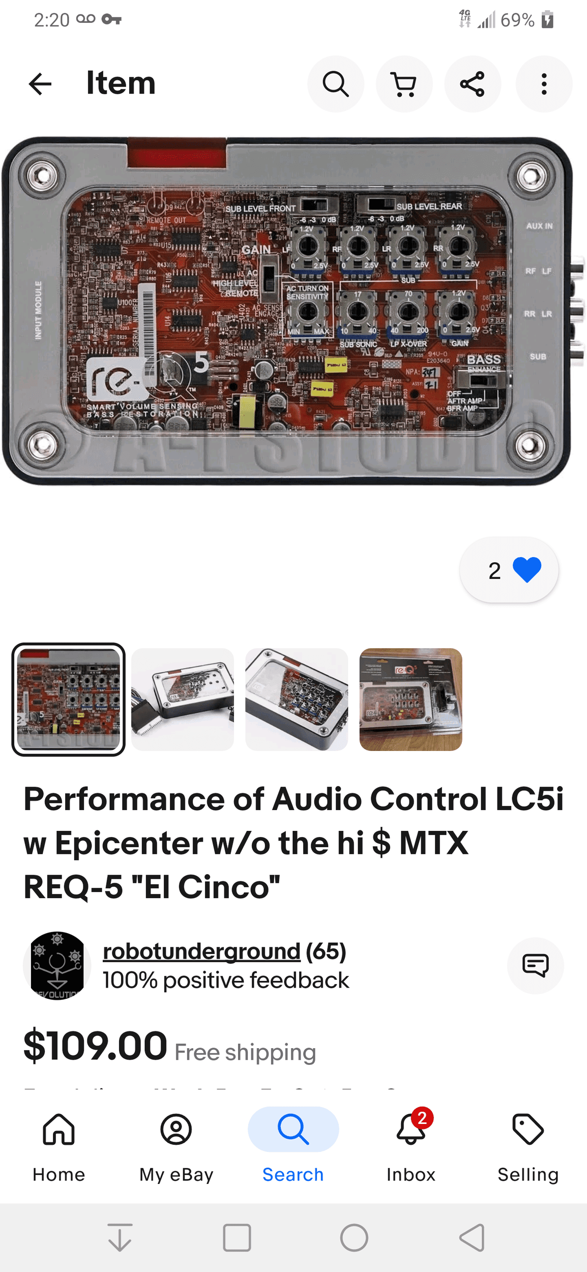

No need to bypass the amp. Most use an LOC that takes the full amped signal and turns it into a flat RCA level signal. Here is the newest I have found that promises the sky.
Connect all your speaker outputs to this and you will get 5 RCA level channels.
