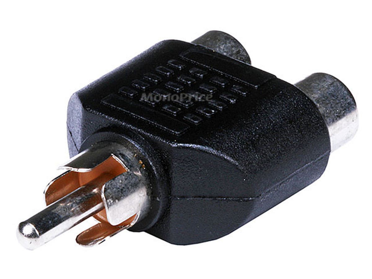

Does anyone in this thread know what they are talking about, jeez. Just take the two wires that come out of the back of the box, and connect them to the amp exactly how it tells you to in the manual for the bridged mode. Because you are using a 2-channel amp and only using 1 channel (bridging combines 2 channels into 1) you have to use a y-splitter. The y-splitter takes the 2 channels from the amp and combines the signal into one when it plugs into the back of the head unit (or vice versa, takes 1 channel and splits it into 2). That way you'll get a 4ohm load from the amp to you speakers and everyone is happy. Yall are making this way too complicated.
You need one of THESE big spender... //content.invisioncic.com/y282845/emoticons/wink.gif.608e3ea05f1a9f98611af0861652f8fb.gif
Since your amp only has one RCA input (mono) and your HU has two (stereo), you will need this adapter to turn the stereo signal into a mono signal. Big ticket item bro.... $.60. //content.invisioncic.com/y282845/emoticons/fyi.gif.9f1f679348da7204ce960cfc74bca8e0.gif
