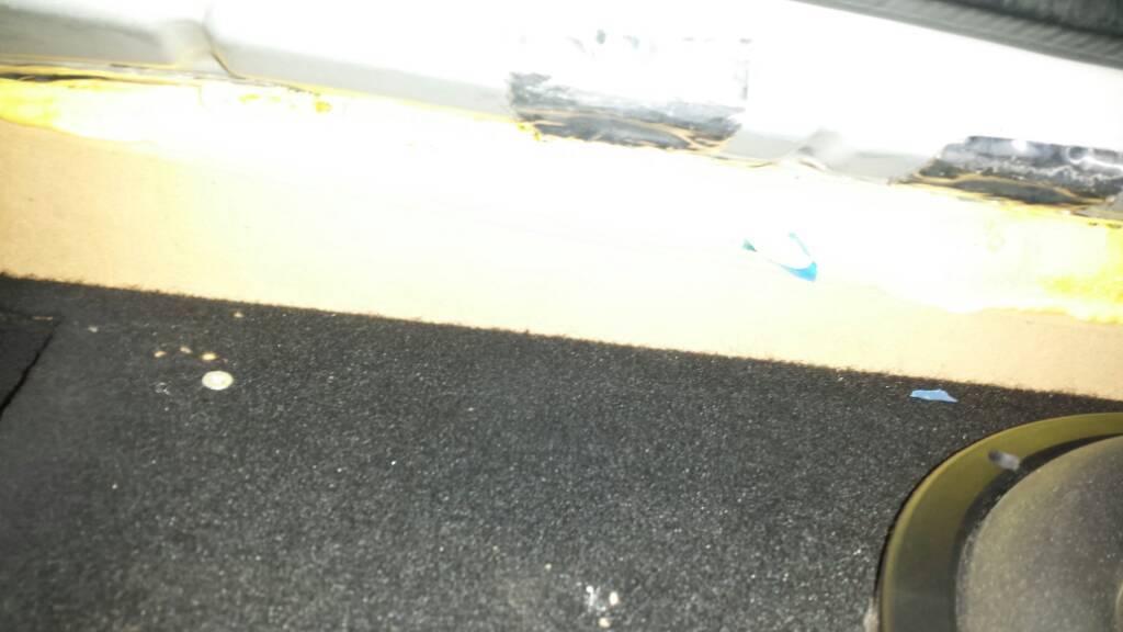

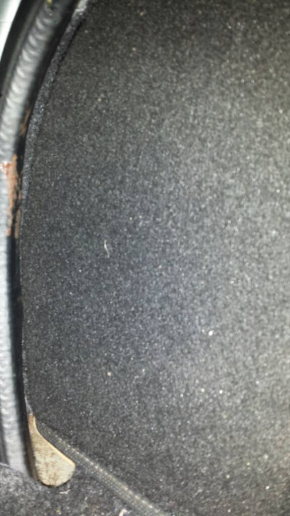

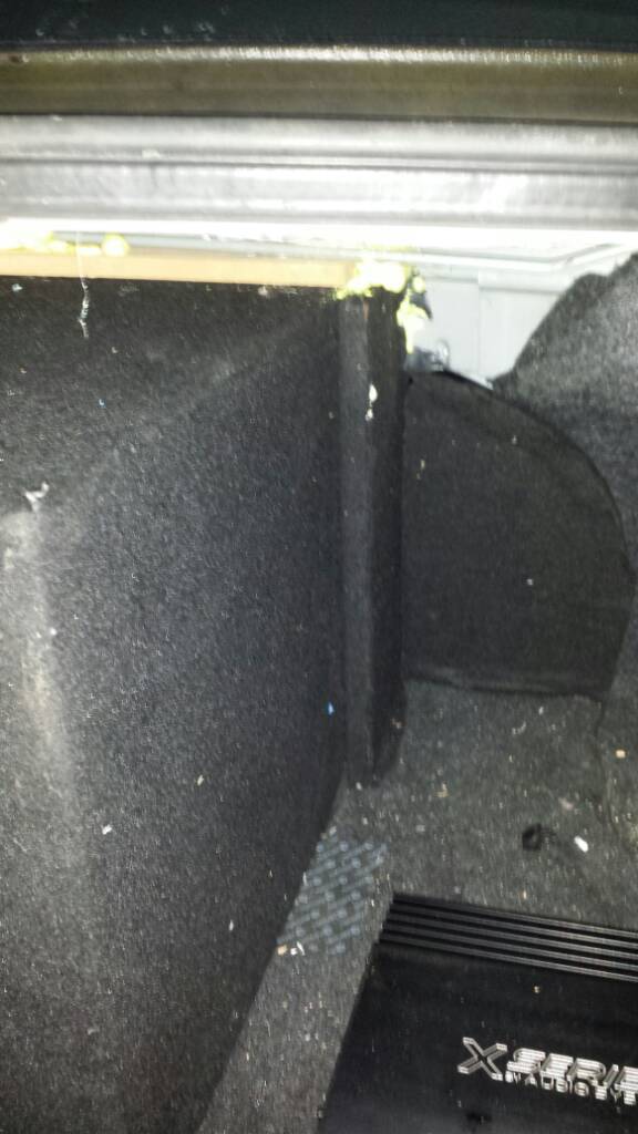

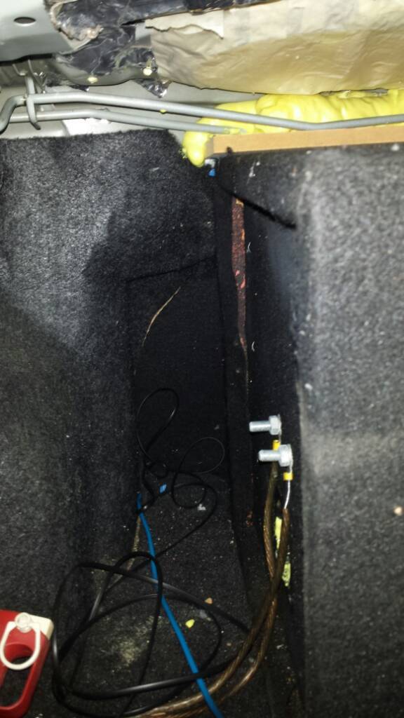

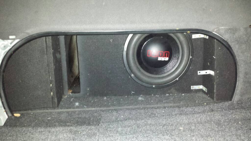

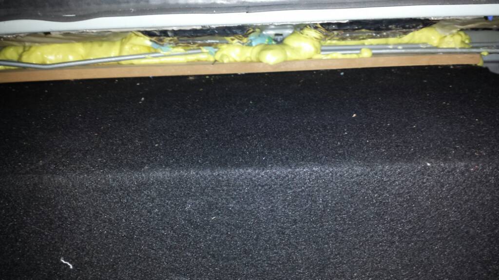

Camera plus night shots make it look way worse than it actually does. I basically just threw the box in there. Measured the big holes left. Made bigger covers than those holes and glued them to 90s that were then screwed to the box. For the top. i had to use expanding foam on top of a long piece of wood but the foam is only on the top of the wood and the metal so the box can slide right out. All the back deck has been 100% sealed.

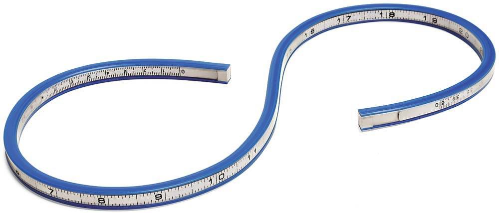

If you wanted perfect shape. You could get pretty close with something like this
Its a ruler than holds shape when you move it. There are lots of variations and thinner ones. You'd just get the main curve of the back of your trunk wall. trace that onto wood. Cut. That'd probably give you no bigger holes than 3/4 and at that point you could fiberglass.

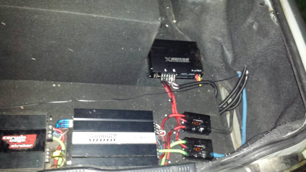

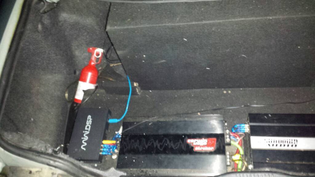

OP, you're losing a lot of output by having so little space around/between the box and the opening to the cabin. Also that amp will die from vibration mounted to your box.
That camry is hard to get good numbers from.
If I decide to wall off the box I'll definitely get that. I had a shop make the one I'm using now. What do you use to cut the speaker holes? Saws All?
