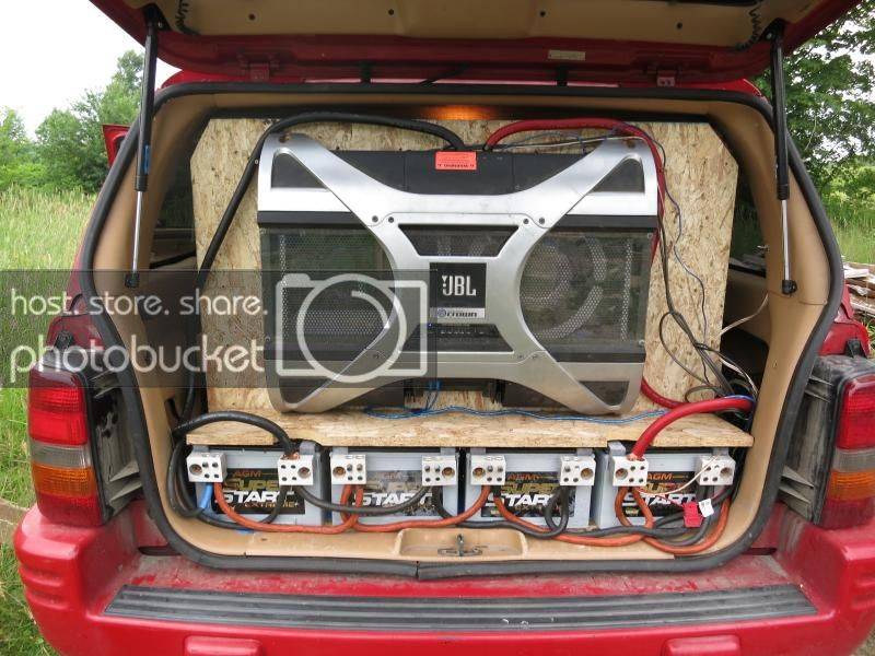

I had no idea jbl made an amp almost the size of a car door. I thought the original guy was talking about typical jbls that I see that put out maybe 1/8 of that power. I've never seen a jbl that put out over 800-1,000rms in person. I guess I've been living under a rock.. also I understand pretty much everything you said, but when u got to the semiconductor part at the end, you lost me..
Actually even the small JBL amps are pretty good, though they have made only a few larger than 1200W. Overall JBL/Infinity/Harmon products are very good. Their amps (most of which are small these days) are reliable, good quality, and do what they claim. They have made some highly regarded component speakers and subwoofers, and they have a very popular digital sound processor in their MS-8 which is rather well thought of around audio circles. JBL makes some solid pro audio as well (stadium and stage type amps).
