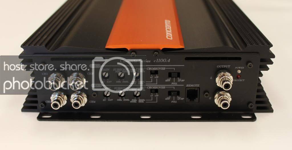

trying to understand, what i should set my x-over setting to on my amp..
I WOULDNT BE WASTING YALLS TIME IF SHI* WASNT REAL! i sent in my doors to epicenter to get the 10" pwx and the (2) pwx 6.5s put in each door..
havent looked much into it, what should the settings on the amp be for the midranges, HP/or LP-BP.. i dont really get the LP-BP switch, i know its low pass bandpass i understand the low pass not the bandpass, but ITS ONE SWITCH give me some clarity here.. if your confused on what im asking look at the crescendo audio c1100.4 crossover settings thats what im using..

I can't pull up a good enough picture of the crossover network on there, but I'm assuming BP will look at both the dial for HP and for LP, so set each to match what band you want those midbasses playing and use the LP/BP switch setting

Not entirely sure since my experience with Crescendo is pretty much nonexistent. Can you possibly post an up close shot of the crossover network so I can better help you?
You can also do some trial and error on the crossover points. Start with the 6.5s and play with the HP on some bass-heavy music until your doors start buzzing or the speakers are getting overstressed and back off a smidge from there. Then start messing with the BP on your 10s to your tastes.
i dont really understand what your saying about the bandpass option for the 10's.. if i set it to lp-bp, how would i set the cross over freq.
Thanks for the picture. Definitely helps. In BP, your subsonic will act as the HPF and the next dial over as the LPF. In HP, only the one on the right should do anything. I might be wrong, so hopefully someone else can chime in here.
