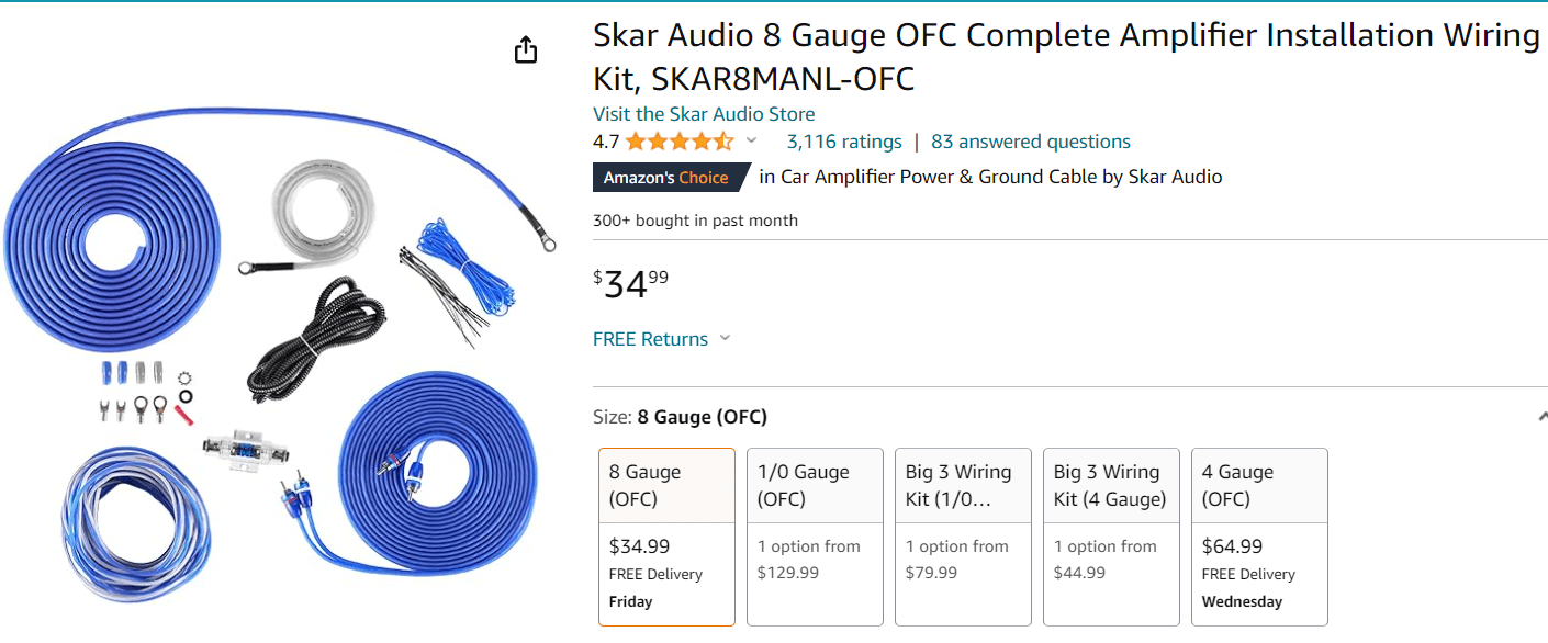

$35 8 gauge OFC wire kit

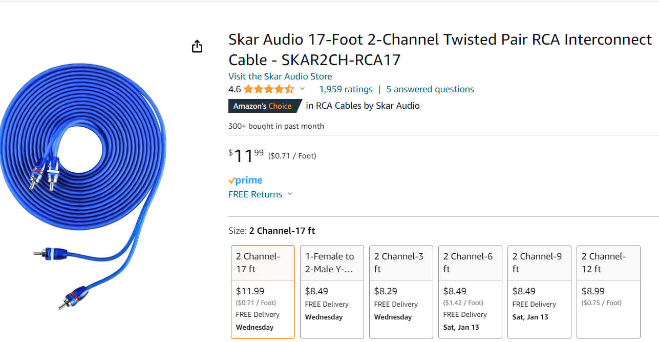

$13 4 channel RCA - use the one in the kit for the sub!

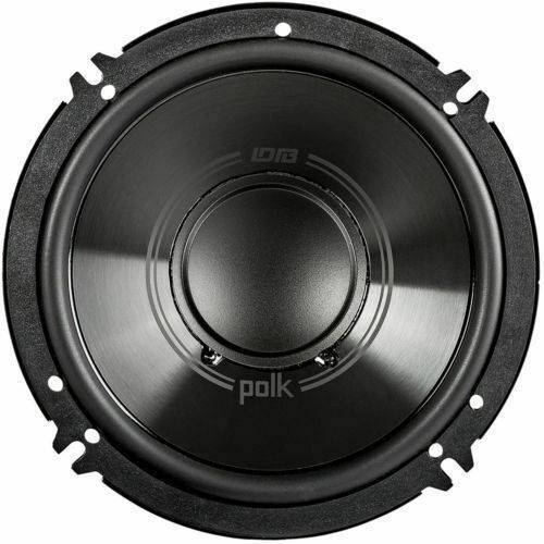

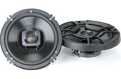

You can find better pricing with a search on the speakers,and some 14ga speaker wiring for the extra speakers. you could even do two sets of the Polk DB Coax 6.5s that also sound fantastic with 60+ rms to save on funds and installation. Though components sound so much better imo.

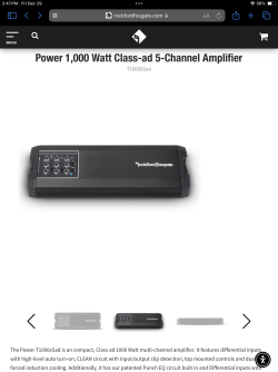

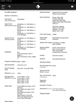

I found that by buying a new mini fosgate t1000x5ad it ran everything perfect. And has immense crossover capabilities….as for powered sub, I’d go with a hyanka 10” underseat …their cheap, and have good tone for the price….components, you’ll probably want to go with coaxial speakers…..on amazon you can get 4 alpine S 6.5 coaxials for under 75.00 …..but if you go with the new mini fosgate, you won’t need a powered sub…as it has 600 watts designated to just the sub ….and 100x4 for the high end speakers……infinity isn’t what it use to be…..their ok, but for price range you can get a lot more bang for your Buck with brands like alpine, Rockville, kicker, hifonics, or something of that caliber….if you decide on buying a fosgate t1000x5ad…get a 2 ohm subwoofer…that will give you maximum power to the sub channel…but run your component speakers at 4ohm per channel…good luck! Btw, there’s also JL audio and DD that make the new hybrid mini amps aswell…their nice because they hardly take any room up…I installed mine behind the dash….

What do you like about the Polks?
I heard some probably 25 years ago and they sounded smooth.
