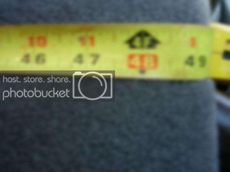

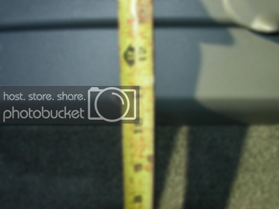

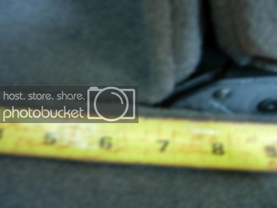

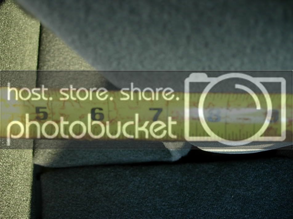

My available dimensions work out to about this:
Height = 10-11" (11" only if I remove the plastic, if necessary I will do it)

Bottom depth = 6.5- 7" (7" would be a sqeeze, but is probably easy enough)
Top depth = 5.5" (6" might fit but it would be a sqeeze)

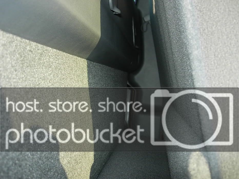

Available space
Showing Height
Showing Length
Showing bottom depth
Showing top depth
So what do you guys think? I need to make sure the REs have enough room to extend out, so what should I do? Mount them flush to the box?
Does this seem like it will work out alright? Or should I think about taking it a different direction? This is what I really want to do and plan on making this box myself with a friend.
Also, if I must I can go another inch or two lower giving myself a little more height on the box, but I have these little air ducts behind the rear seats that I would have to refab.

On those trucks I've down fired 6.5's since the tuft carpeted piece at the bottom back of the seats can be compressed. We've also done rear firing by removing the carpet panel on the back wall, HIGHLY RECOMMEND sound deadening there! As for (4) 8's, you can squeeze them, but you'll have a good bit less than 1 cubic foot of net internal volume after bracing and subs. That's gonna be a midbass-monster unless you have some serious EQ going on. Just a heads up there. The only other that we diddeded was a single 8" ported. It was equally as loud as the (4) 6.5's as far as I could remember. Hope that helps some.

Well I talked to a buddy of mine and we are going to use as much space as possible behind the seats. We are goig to follow the rear lines of the plastic panel with the box to pick up a little more air space. We should be able to get 1.5-1.7cu ft after bracing and everything else! That will be plenty of air space for the 4 RE 8" subs I am planning on running! The thing I like about putting the speakers back there is the option of dropping the rear seats down so the subs are firing into the truck as opposed to into the seat!

Glass the back wall and use that as the rear of your enclosure. Then build an MDF frame and use an MDF front baffle. This will maximize the most area. Somewhat like this here. BTW...these are 10 behind the rear seat of an 05 Chevy Silverado CC.
As I recall you have more height under your seats that I did. That should allow you to fire two 8's down on either side of the rear floor "hump". I know that probox and subthump offer boxes for under the seat on your truck so you could model after those.
