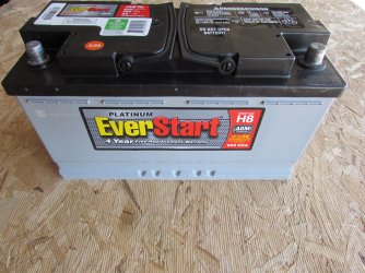

What would be a good battery? Preferably a big enough one so that I don't have to buy two
So it doesn't have to be the same group size? My current AGM is a group 34 and it's about 7-8 months since I bought it
No, group size indicates the actual amperage and size of the battery. All 12V batteries will play nice together (except some lithium batteries) so you don't have to worry about that.
