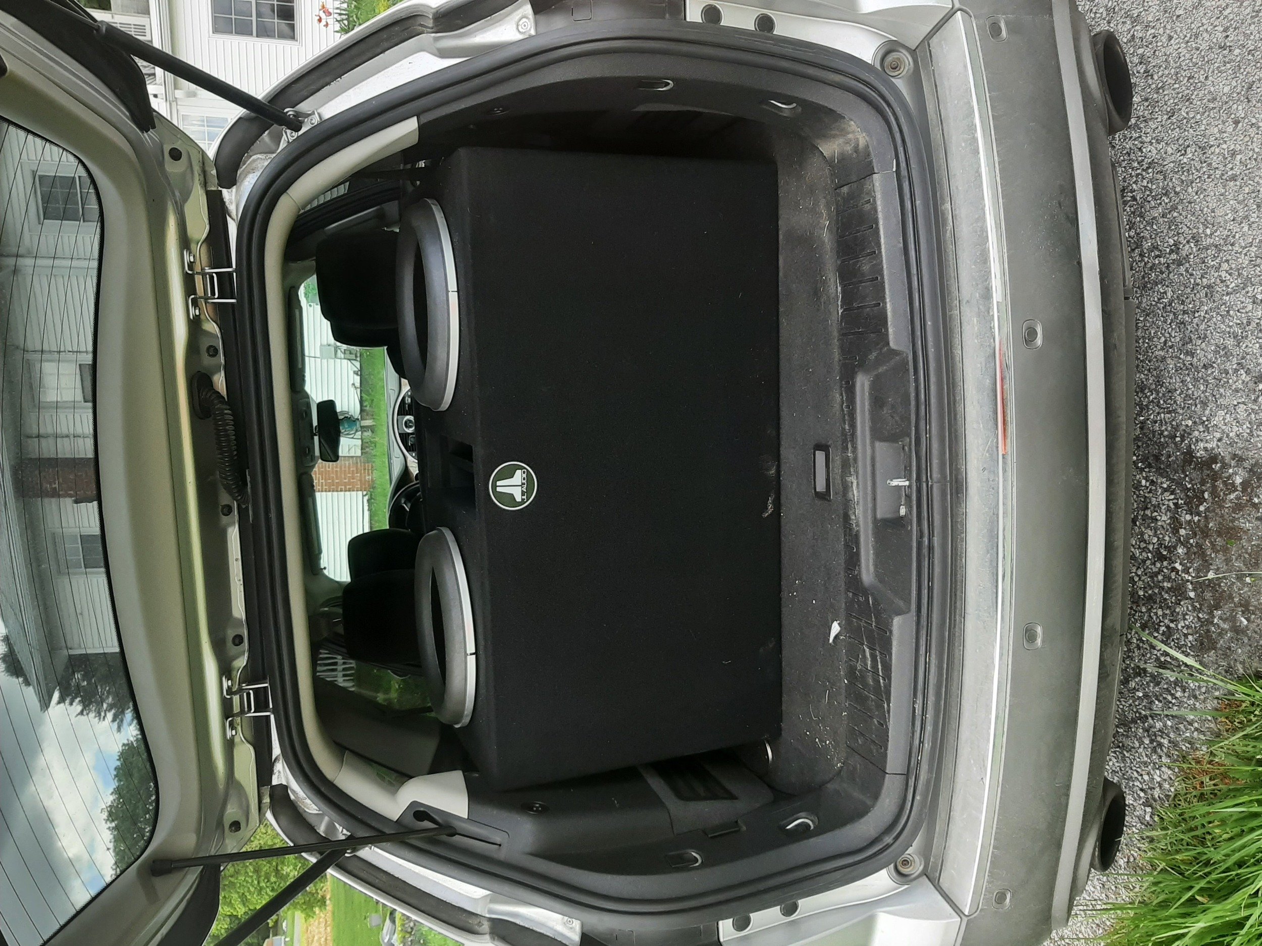

Any suggestions would be appreciated. I'm pushing 2 13.5 w7s with a 1200 1v3 slash and a stinger 2 farrad cap. In a 2012 buick enclave. Bought a box from sonix enclousre stage 3 for the pair of w7s tuned at like 34hz. Do I need to upgrade my electrical? And what else can I do to make these bad boys shine?

You may have shot yourself in the foot buying prefab box. W7 likes a large-ish low tuned box. W7 is very capable of getting loud and they're pretty well indestructible up to about 1000W

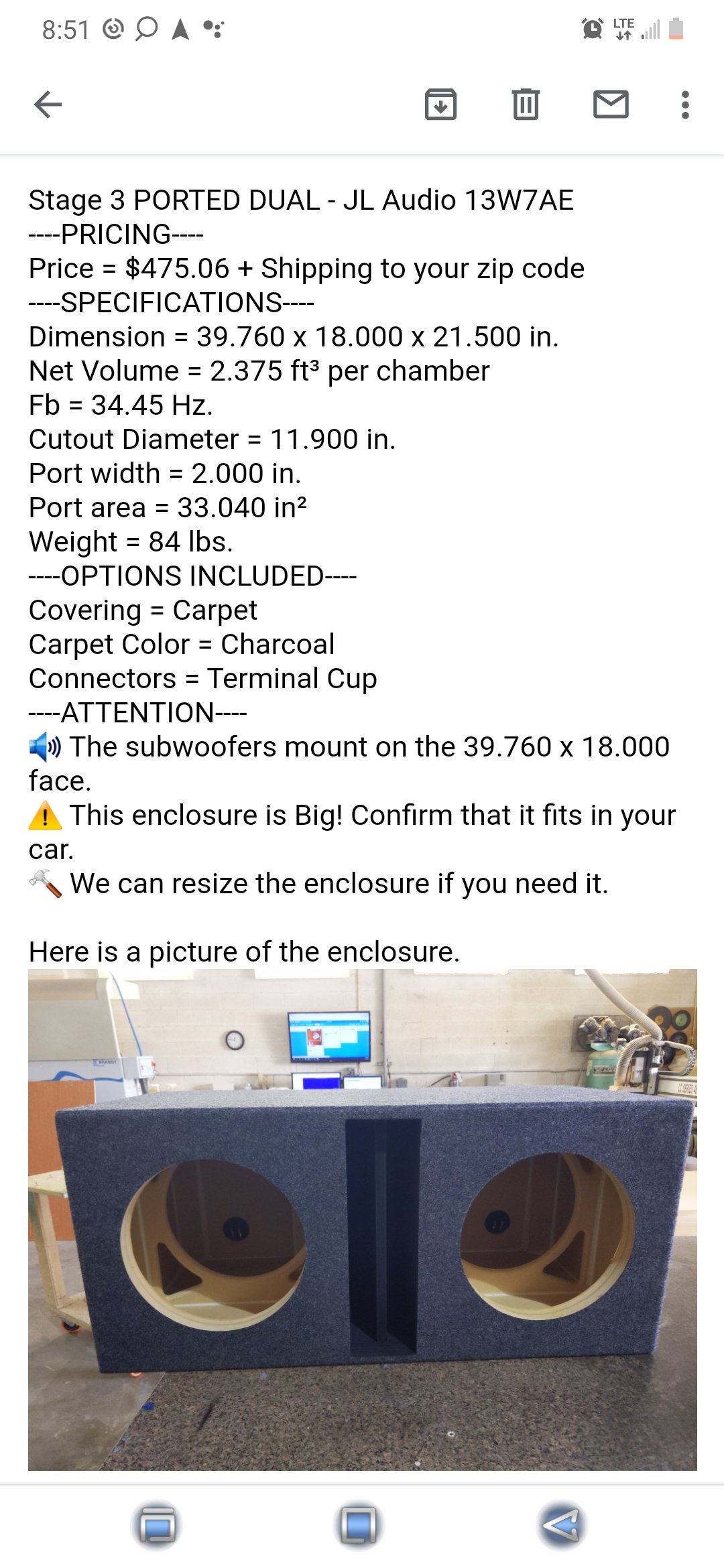

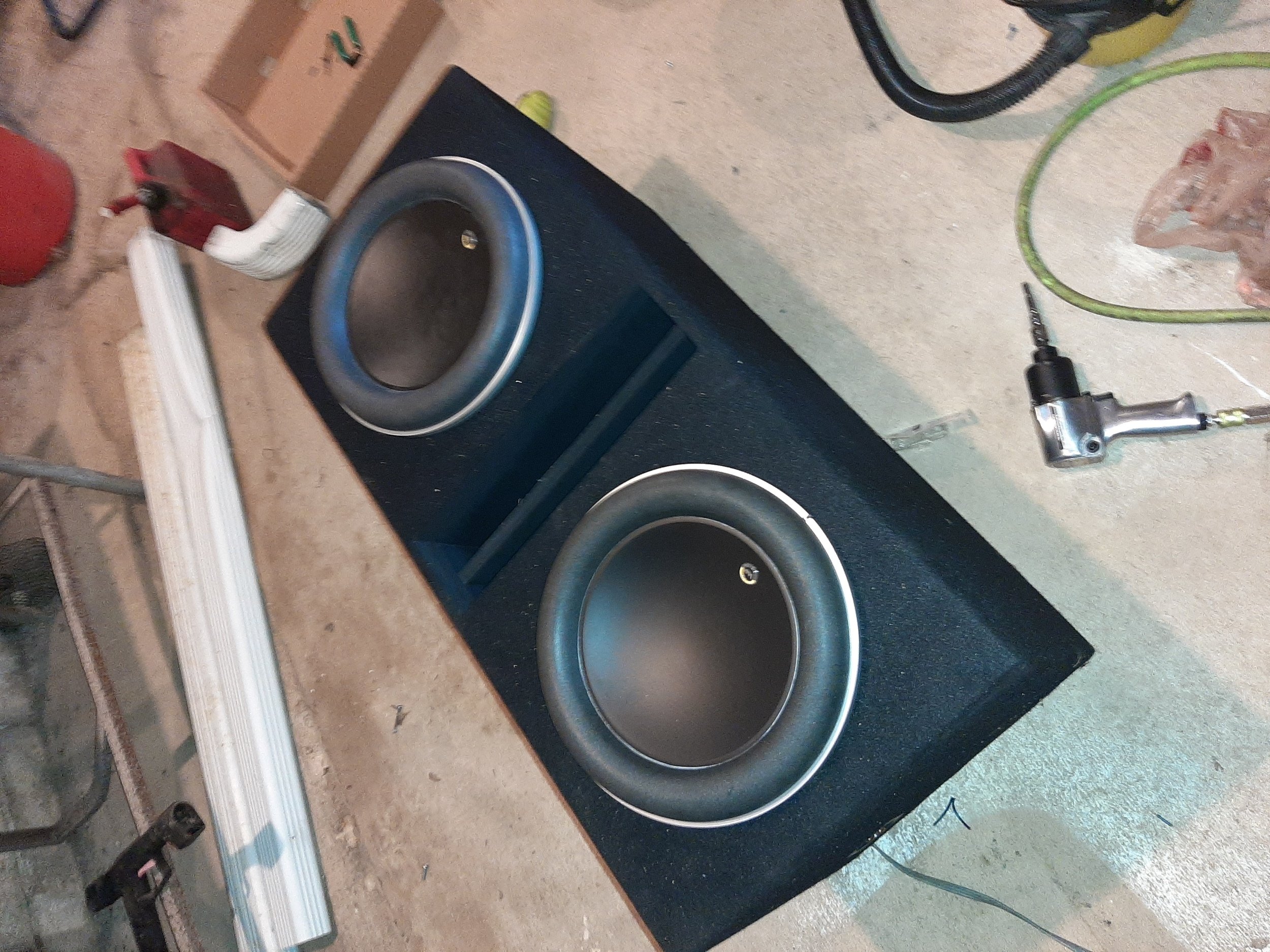

This is my box
Looks well built, but I'd feel better with 3.5 cube per sub or perhaps more. The last box I built for 12W7 was very close to 3 cube and tuned around 28hz which modeled very nicely.
Tuning should be OK but W7s can tune down a bit more to play very flat.
I've designed a lot for JL, and there's some truth to this for sure. JL's can do big boxes. The issue is around power and what people expect, and then there's also warranty type issues, as well. I've done 2-2.25 cubes safely for the 12's and I've done 2.5-2.75 cubes for the 13w7 before, that works well for those woofers, seemingly maybe better than JL's recommendations. I think JL recommends a more old school type box, such as maybe a sub box for higher pounding bass, punch bass, vs heavy rap or droning bass. If I was running JL, I'd probably do a hair over recommended and I would tune those fairly low, and try to get a lot of range out of them with the tuning and port design, make them flat.
I actually really really like w7's in 4th orders. They will do well in those, at least they have in the past.
Issue with oversized boxes is electrical. A lot of subs will still resonate fine away from a low tuning frequency, but when you have a big box and the subs start moving a lot, then that's when you get electrical issues for sure, all of the woofer movement can really strain the amp, away from tuning frequency.
That box looks fine to me. Idk I don't like JL's higher tunings, that box may be at 36 hz or whatever. I don't like that type of bracing either, personally, at all. To me, that's like the worst way to brace a box, the flow of that just doesn't look good to me, but I'm sure it works fine. I also don't like the port splitter, that's just wasted space and usually the port will perform better, the closer the height and width are to 1:1 ratio. Having that splitter makes the 2 ports really skinny, instead of having 1 fat port.
