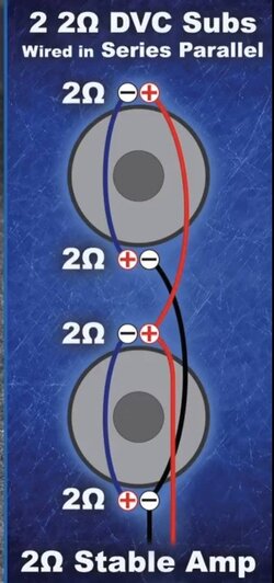

I wired the speakers to keep them 2-Ohms. I'll include a diagram of how I wired them.

yes...sorry....LOC gains than amp gains, be conservative with the gains as you are using your "untrained ears" and no measuring equipment....check back with us when you fry your subs/electrical...haha
adjust the gains on the LOC
Op's on stock electrical? Love it. I don't know much about using factory hu but is there a chance he may have tapped into the wrong speaker wires and not getting a full range signal?
Adjusted the LOC gains, that helped very slightly but almost not at all. Will be trying AMP gains later. The wires I tapped into were the rear speakers. They have the regular 6.5 inch woofer plus a tweeter. My assumption was that was full range but I'm new so I could be totally wrong.
id have the LOC gains at about 75 to 80% of full then turn your gains on your amp loooooow AF and bring your volume up to where youd never turn it past (mine goes to 40, and i set my gains when at 32 even tho i usually cap out at 30 on the volume dial) then adjust the gains on your amp. Also, might want to take the subs back out and make sure one of those wires didnt get disconnected. That happens all the time. Youd be surprised
Thanks for the input! I'll try this out.
Yes, it came with a factory sub. I took it out though so it doesn't get destroyed from the new subs.
Why didn't you tap into the sub wires?
Also if you are stock electrical you are done before you even get started. Your little Kia is not going to be able to power that system.
np
ok, then dont tap off the rears, tap off the sub. itll already be eq'd and x-ed over and all that, but itll probably work the best with your otherwise stock stereo. When i had my 03 Maxima, i went to the scrap yard to get the opposite end of the molex plug so i could get straight signal that was intended for the sub and put an rca end on it, worked like a charm
