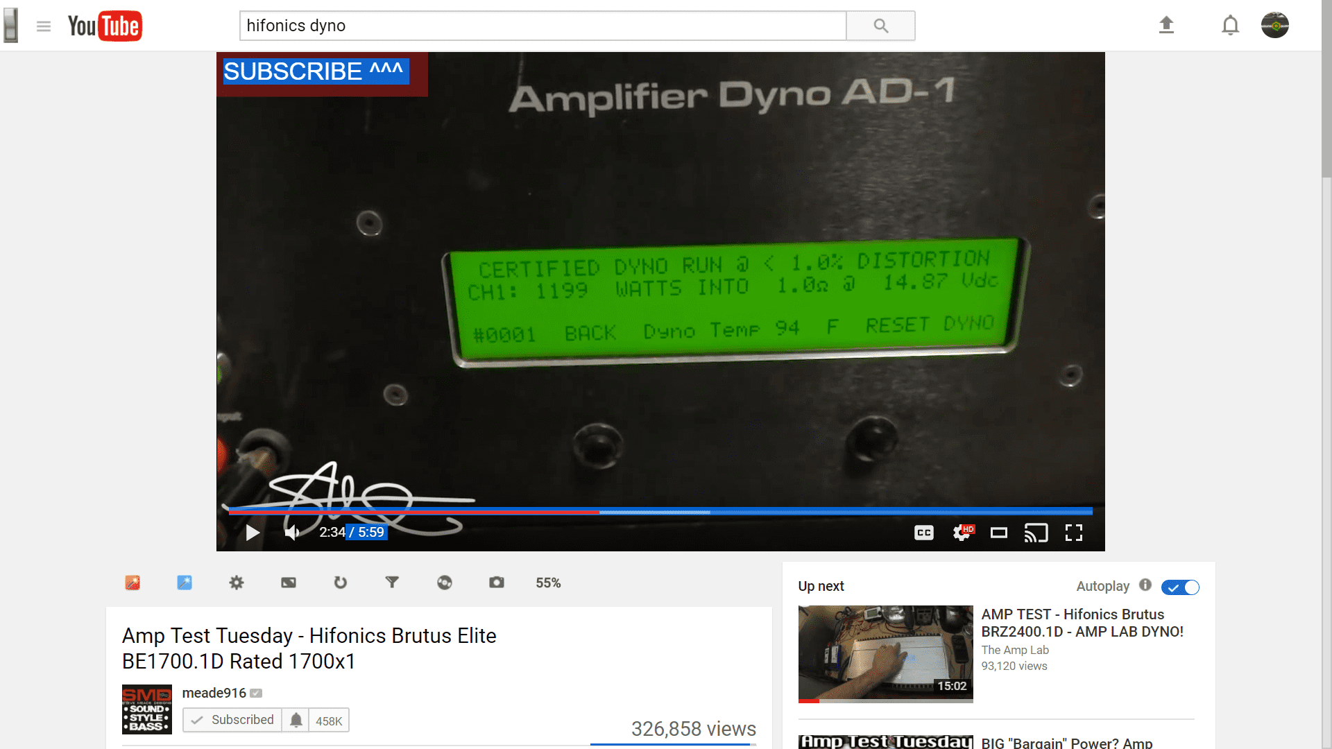

Here's a test of the brutus ELITE which basically costs way more than the brx and is of much MUCH higher build quality, CEA certified and everything. Rated for 1700 watts rms and what did it get? 1199 watts at 1 ohm on EXTREMELY good electrical. If the voltages were around 13.8v like most peoples rides rest at, he'd be more around 1000 ish watts. the BRX series are a lot less louder than the BRE series from direct swaps so yes my power numbers are pretty spot on if you factor in these REAL results at 1 ohm loads.
