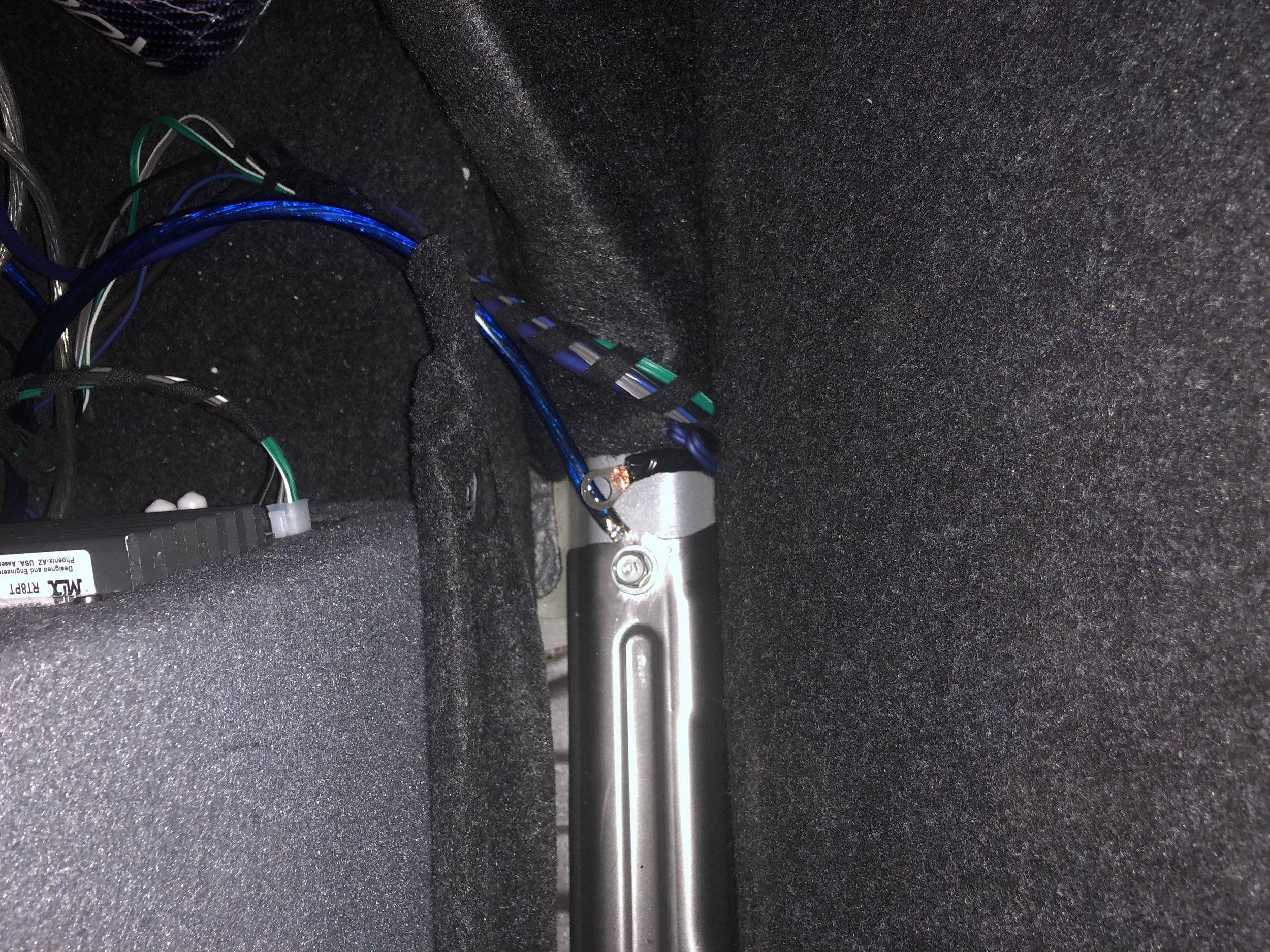

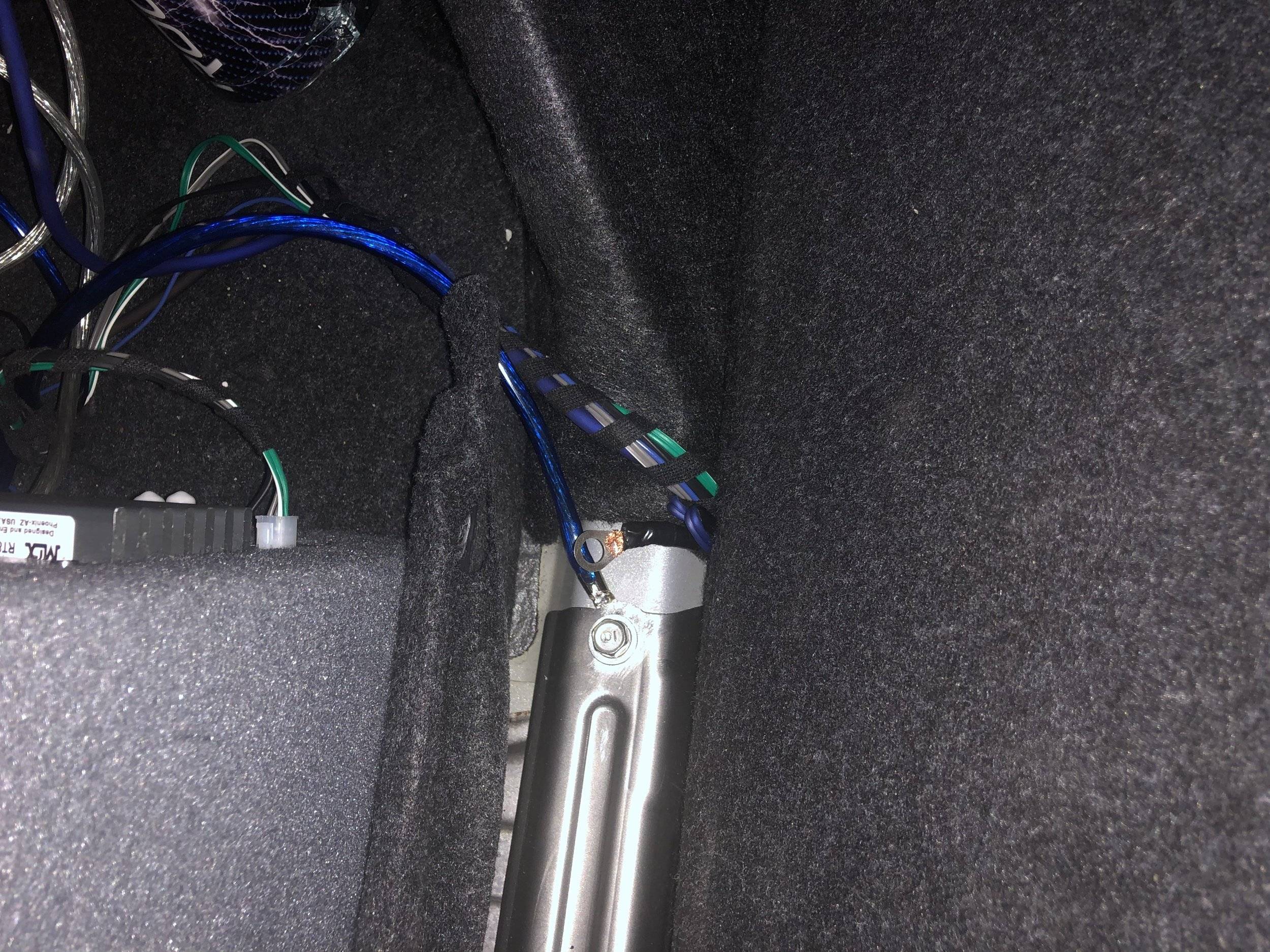

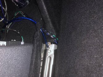

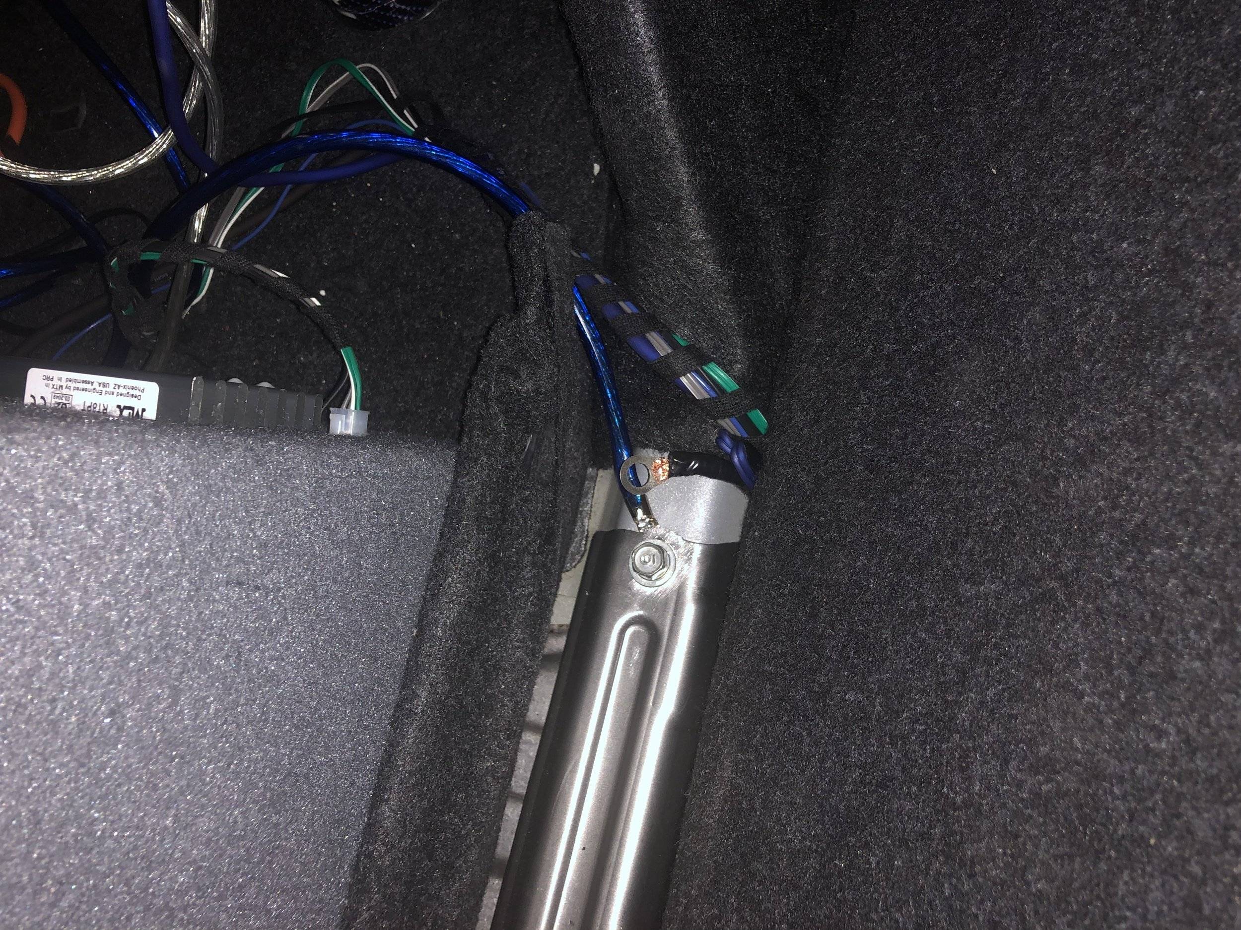

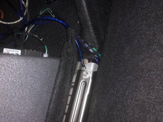

I replaced the battery the battery and the headlights still dim. Anyone knows where to properly ground the subwoofer in Honda Civic 2012? The shop I got it installed have mounted the ground wire in the frame under the carpet. Any ideas?
I have 2014 Corolla and my rear ground is grounded to the frame by a bolt that holds the rear seats to the frame.
Also make sure all paint/dirt/grime is removed from your ground point. You want to see bare metal at your ground point.
