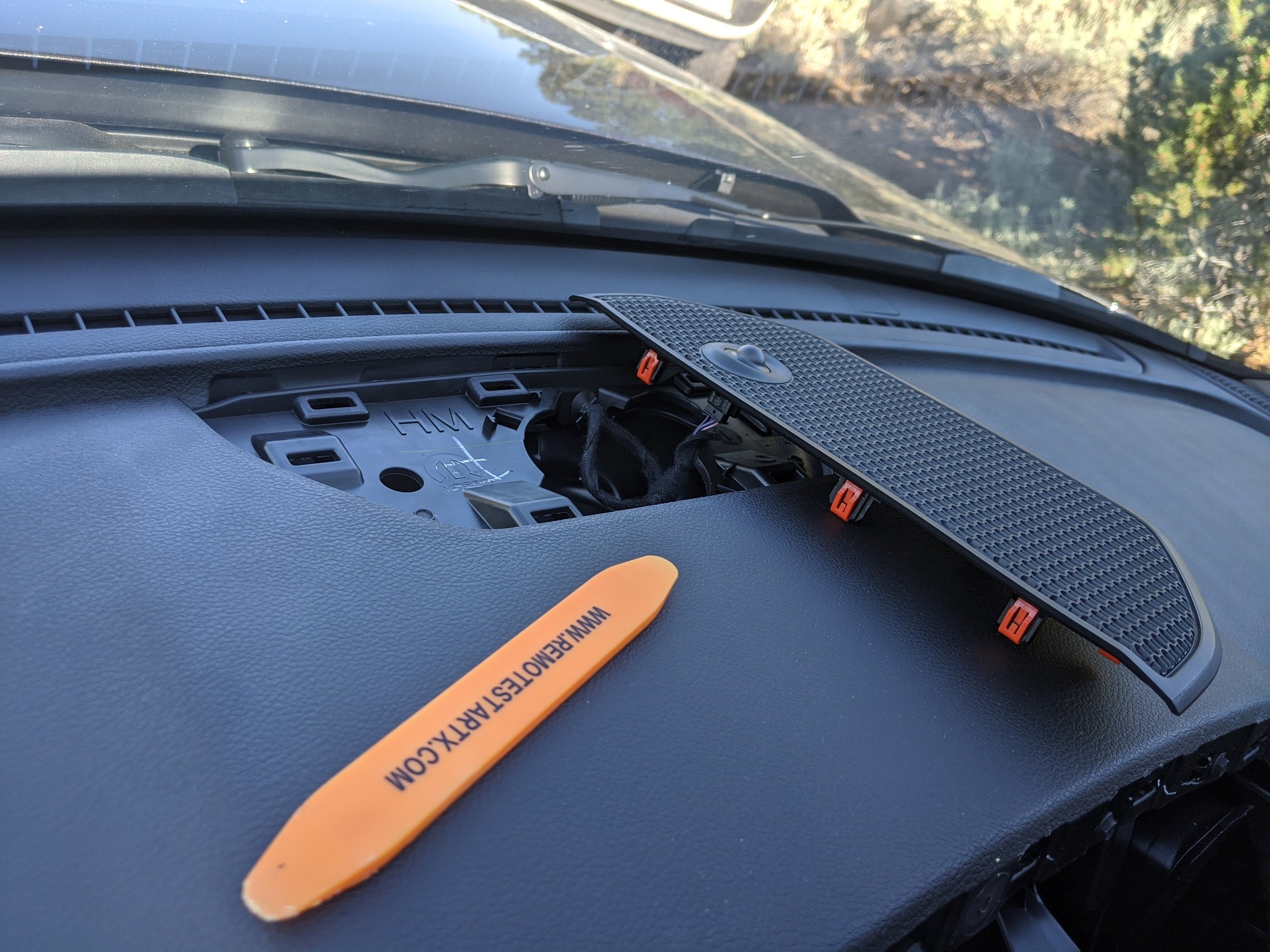

So I peeled open the dash and found the center speaker grill is not even a grill. Just looks like one. No speaker located in the center and not enough space to add one without modifying the dash.
Now I have to rethink the speakers/amplifier matchup. Was planning to run the two smaller kickers in series to create 6.4 ohm impedance. One channel would give 60 watts or so (at 4 ohms) and these speakers would be perfect. the second channel was to be used for the center speaker. Since there is no center speaker I can put one dash corner on each of the two channels. But then the speakers would be way under powered.
