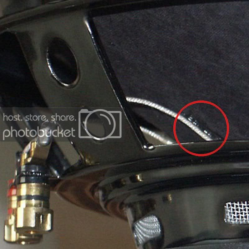

Just add a piece of cloth or something under the cone. It will change MMS though.

As for the tinsel , i had Zoom in one of the photo , if you notice i had apply a aero glue on the side of it to keep it there , and at 600 rms .. this is going to last a very very long time .

That a good point enlarging the surface , but that would depend on the spider , basket , and surrounding rim , and cone , as well as dust cap ,
The magnet and core as well as voice coil can be adjust easily ,
i had also consider mounting the tinsel on the spider . or attaching it the side using a thicker wire -

I was thinking you might be able to coat around the tinsel or something to keep it from hitting the cone without affecting mms. I dunno if anyone has tried it. I have never seen it done in productioon

Hmm.. coating i will bring it up tomorrow morning and see what the response and maybe will test it coating it in a silicon base glue ,
the photo may not show a good angle . but the tinsel is really just right , It fix at and angle allow it to move but yet securing it and not allowing to hit the cone when operating at high RMS or low Hz .
