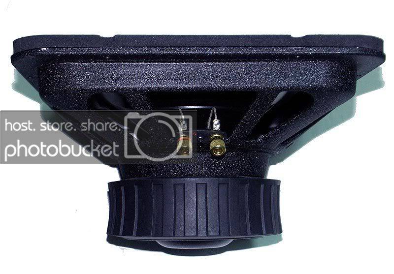

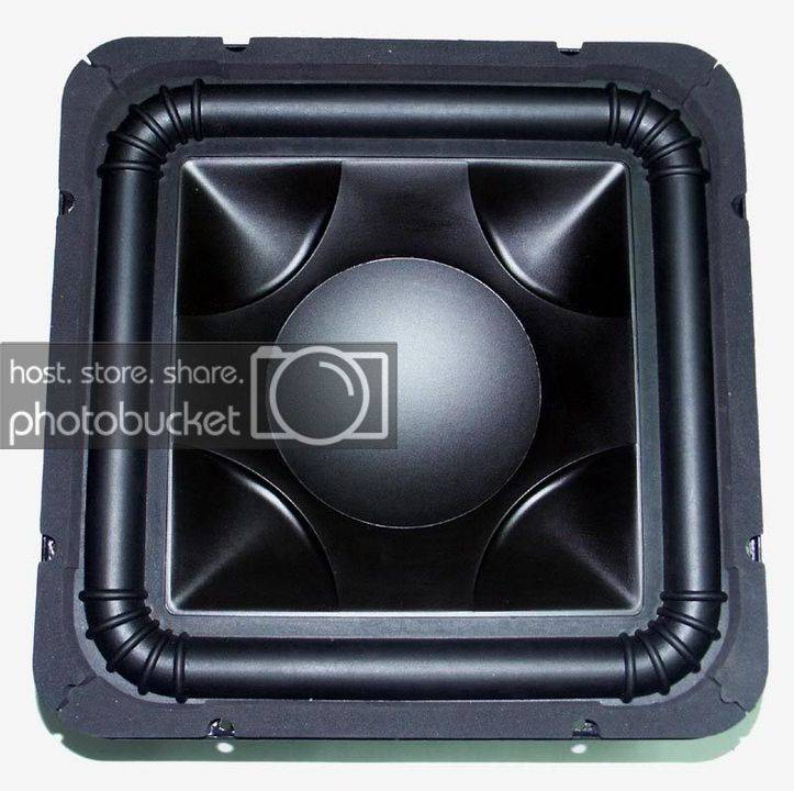

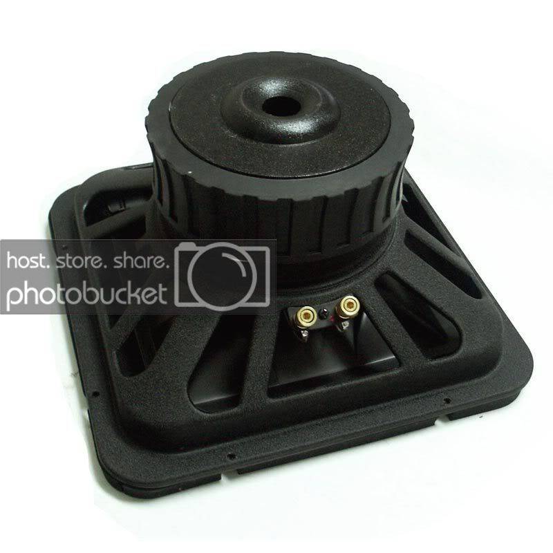

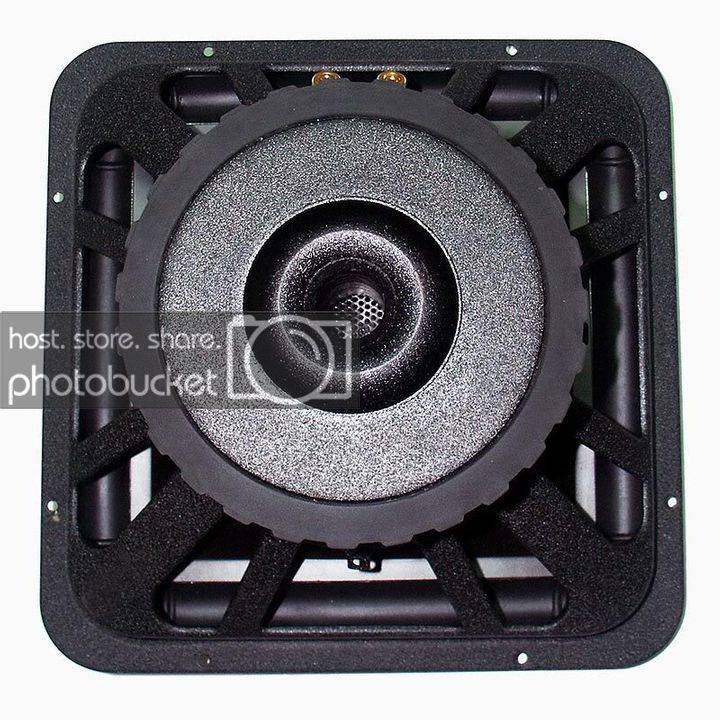

here is some photo
Here is some photo - i edited and clear up the background
Will post more photo Hope you like it .
12 inch sub
Sand blaster paint
i am considering lowing it to 2 ohm .
And enlarging the Voice coil The Voice coil now is 50mm
Considering 65mm Voice coil
I would rate it about 600 rms to be safe
I am also considering Kapton Voice coil . if so it may handle about 800rms easily
also enlarging the surface of the magnet
