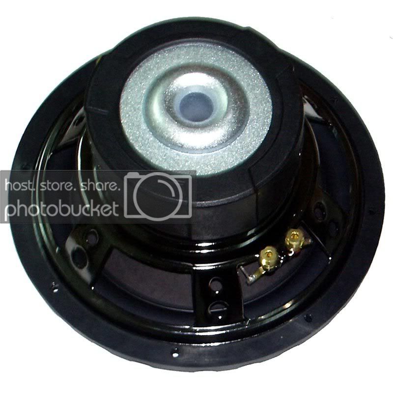

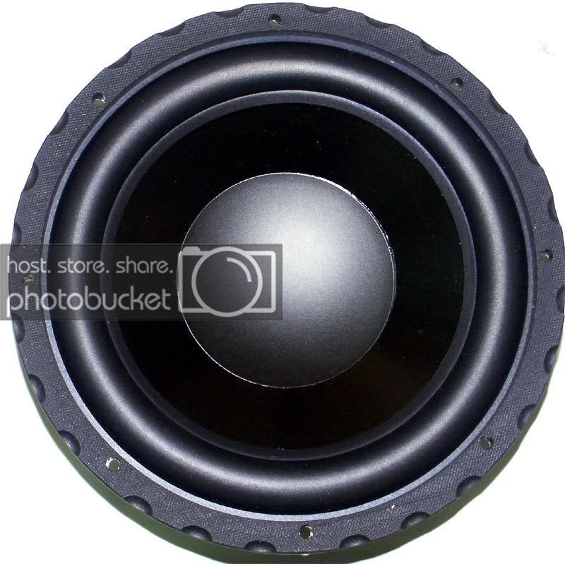

Like i promise , here is some photo of the 12" Round sub .>
Notthing fancy , is a kapton Voice coil . and i rate it at about 600-700 RMS >

i like the spoked basket....lol
but nice //content.invisioncic.com/y282845/emoticons/smile.gif.1ebc41e1811405b213edfc4622c41e27.gif

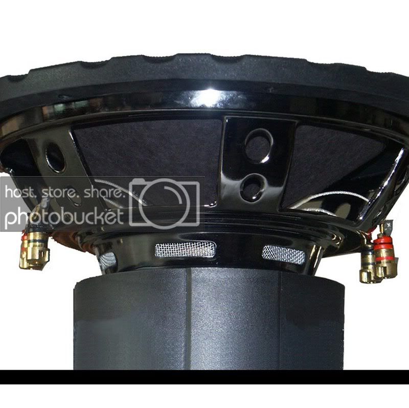

I am still changing parts and configuring the Sub , but the basic out look is this , might play with the Paint or black chrome . The photo you see now is using Black chrome metal i had select extra thickness of 1.4 mm metal for the basket to give it better stable - without discounting the weight , and use Strong strodium ferrite magnet
I had edited the photo slightly removing the brand on the Rubber on the magnet , i had used a old rubber protector from another brand to see the final out come effect ...
the magnet is a 100 oz now but i may adjust it -
I'm using Cornex weaven spider from dupont .
Silver plated Wire for the tinsel ( import from japan )
