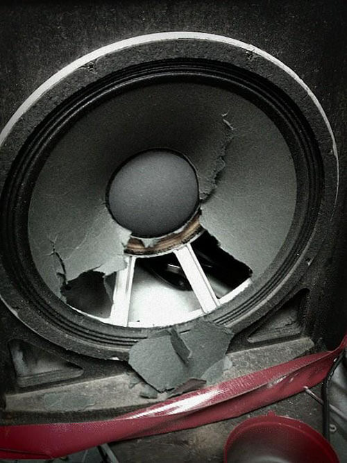

Sorry... it is not a good idea to have your gain so high. What that will do is introduce and amplify massive amounts of distortion and most likely will blow your subs in a short amount of time. amplified distortion causes heat in the voice coils and can break the thin copper wires via the heat.

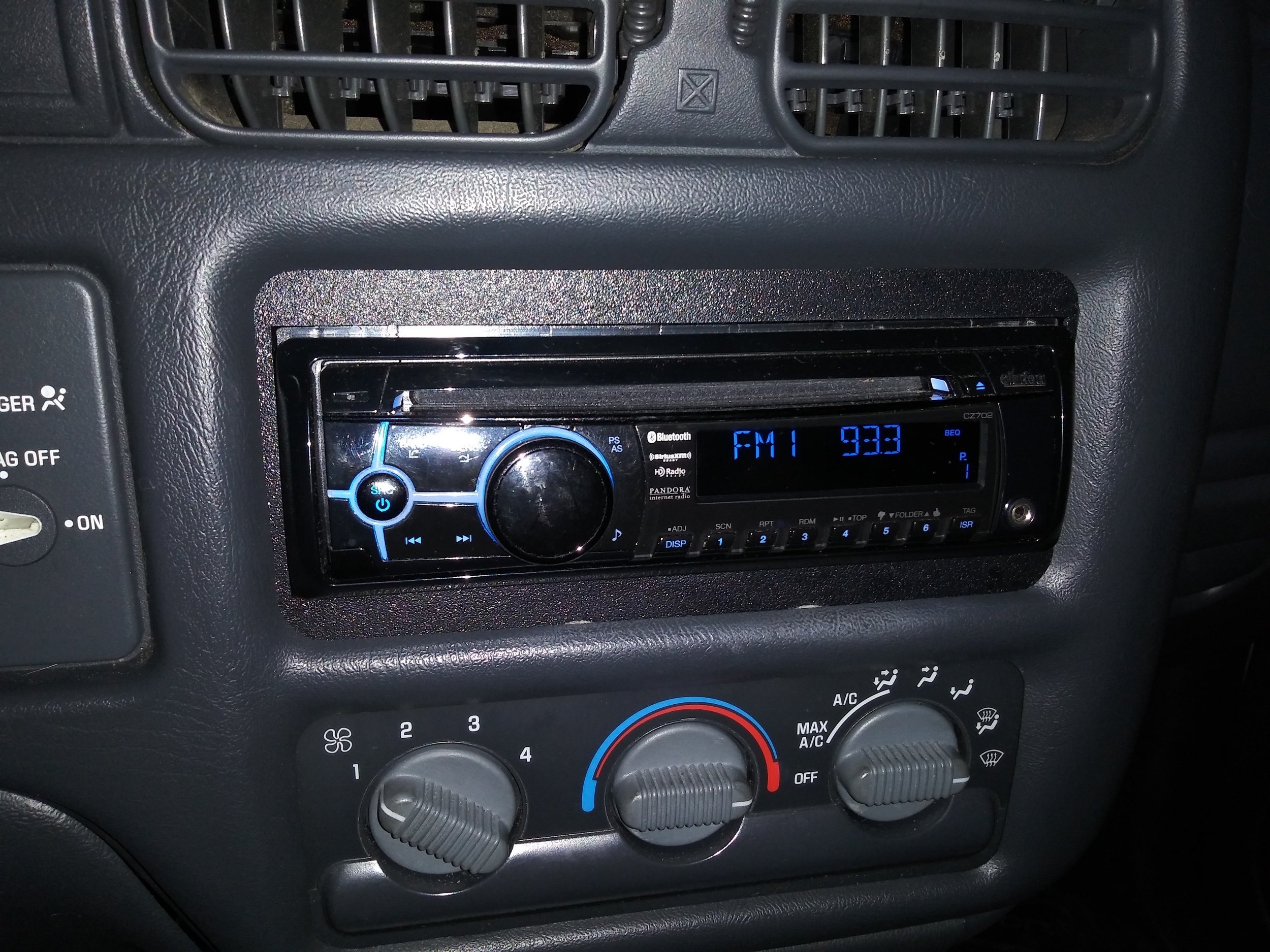

Aftermarket , clarion cz702
I’m not familiar with that hu but like Jeff said if it’s an output situation you’re not getting a strong signal to the sub amp. I assume it has a sub out on the hu and it has subwoofer level turn the sub level all the way up and reset your gain. If you’ve already done that take a multi meter and double check the ohm load and make sure you have the subs wired to the correct ohm load. Assuming you’re not using a dsp or anything else in between hu and amp?
This is mine. It has a lot of features but customizing sound is limited with its built in x-over settings.
