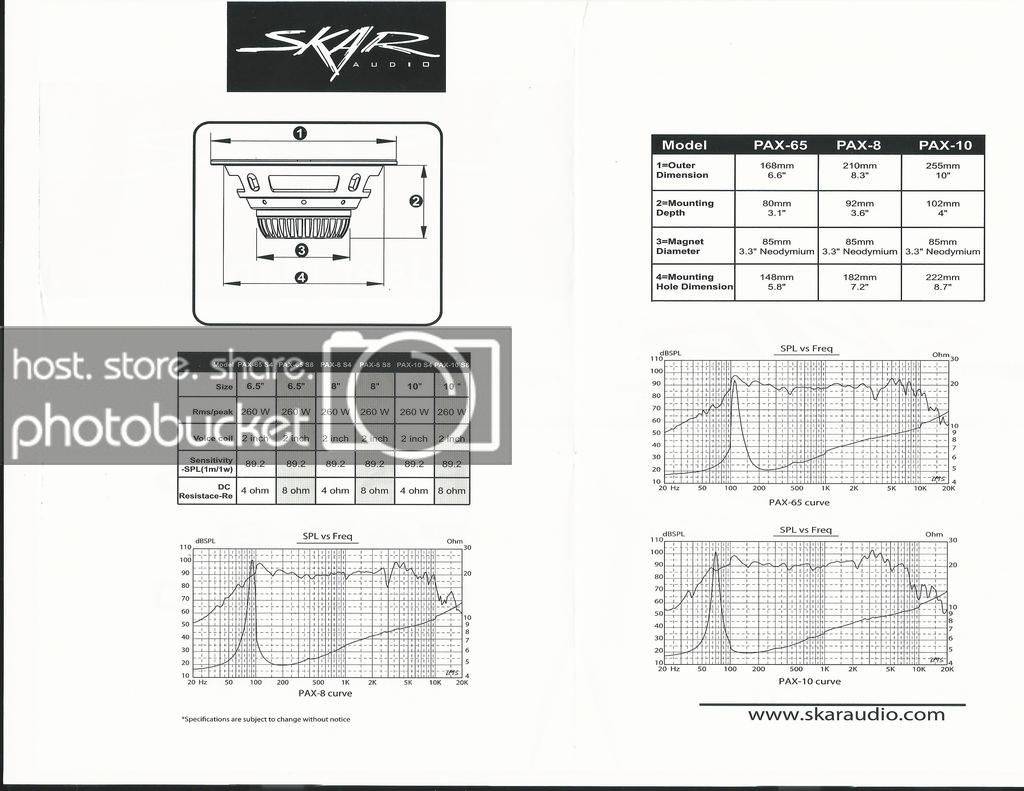

The manuals only show the PAX curve, not the tweets.
The one on the top right
