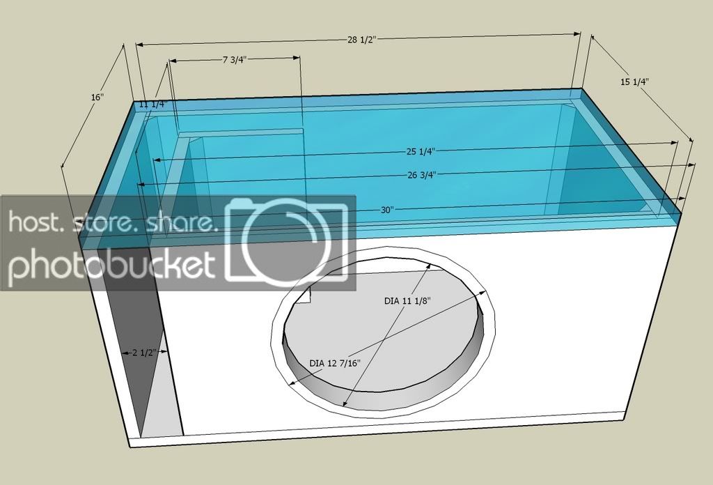

2001 Nissan Maxima12" Fi Q w/ BP Power Option D2
Max External Dimensions
D X W X H
16" X 30" X 15"
Double Baffled
Tuned to 32Hz with single slot port
I would suggest around 2.25-2.5 cubes net with 28 square inches of port, but it looks to me like you need no suggestions. So please if you think you have a better idea, go with it.
Thanks in advance, anything is greatly appreciated
3.06^3 w/o port @ 32hz

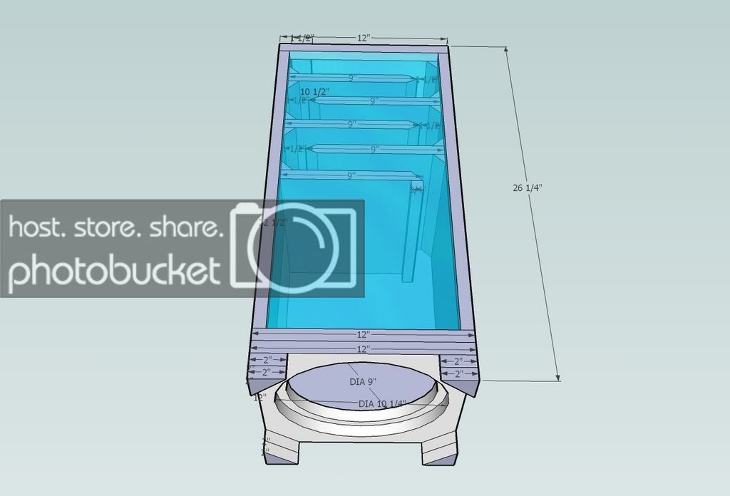

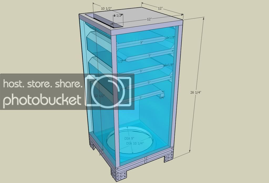

Dayton RSS265HF-4 10" Sub
Sub must be in Down firing config, flush mounted....using a slot port that goes out the top (out one of the sides, doesn't matter)...
the actual box must be a 12" x 12" (picture a standing rectangle)... but the height can be as high as needed to fulfill the requirements of the box...
Tuned to 20hz....
edit; 3/4" MDF...will be used..
Your box gives me headaches on building it. Also designing it.
1.875^3 w/o port @ 20hz

The design is still the same on the 1st page....
*waiting for you do re-image on the interntal slot dimensions*

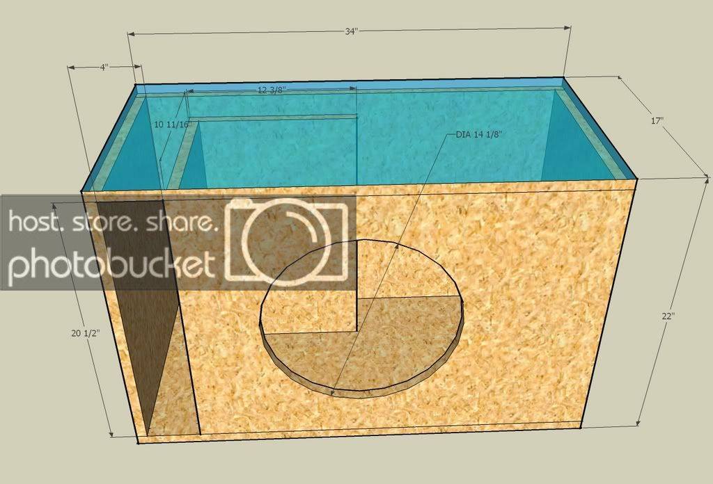

Fi Q 15" Vented enclosure...
Donations will be sent, once i complete the enclosure!*

Just wanna make sure, all the cuts, i need the add .75"?Or its already added with the dimensions...
Width of the box is 34", the cut out is 34" 3/4....
All the sides are measured in 3/4 MDF 34" is the width =)
I always add the 3/4 measurements into the box design or 1" or 1/2" Depends on the person but i always do 3/4 unless the customer wants something different.
Hey rcnshoe your designs look rad.. could you make one with a double baffle for my 13W3v3-4?
Max dimensions are 14.5H x 28W x no more than like 27D
JL recommends 2.25^3 @ 27 hz, but the box on their site is too tall for my trunk (96 Nissan Maxima)
