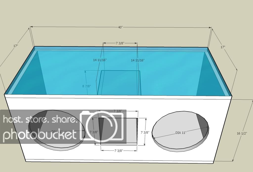

each chamber is 3.85^3 @35hz 1" MDF

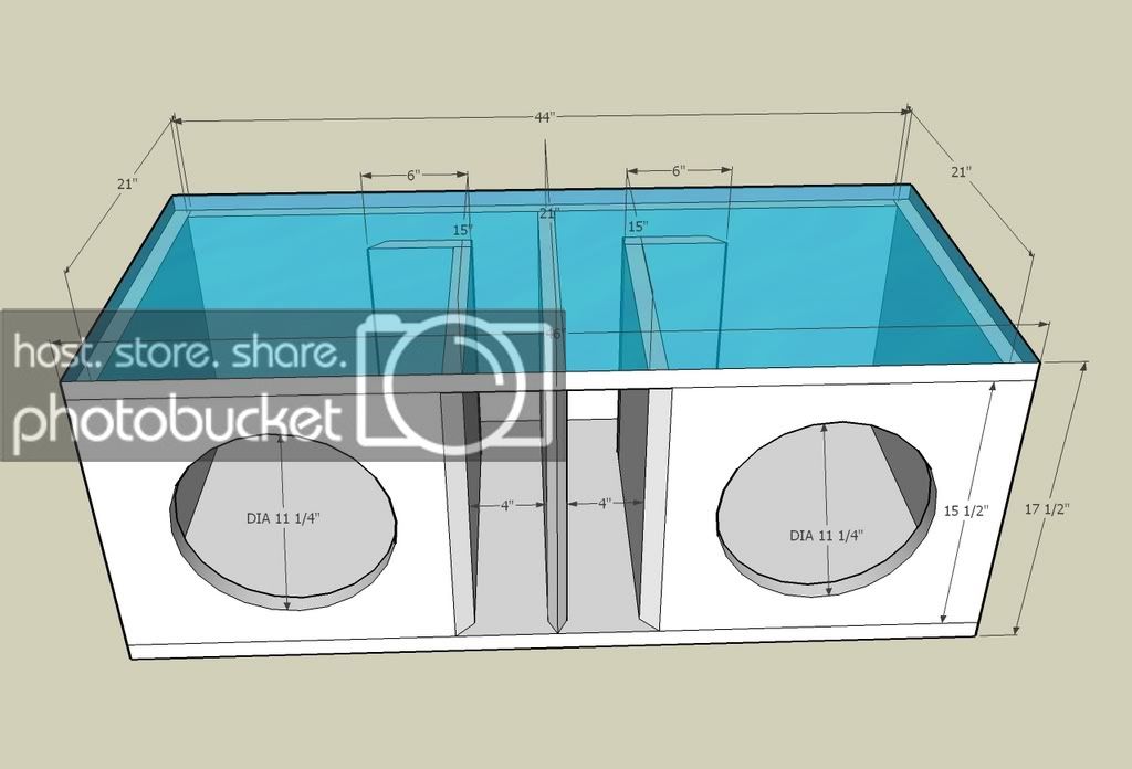

thanks alot for your help do appreciate it, i forgot to let you know that i will be
inverting the subs, that would changes the chambers volume, if its not to much to
ask can you redo the skitch,you could cut down on the deepth since the subs volume would be out of the count.
again thank you for your effort and help

thanks alot for your help do appreciate it, i forgot to let you know that i will beinverting the subs, that would changes the chambers volume, if its not to much to
The box ^3 is without sub displacement. So it wouldn't matter if you inverted the subs. But if you want i can re do the box.

6.256^3 w/o port at 32hz lots of port area!
thanks for your quick respond, if its not to much to ask,can you redo the box with these dimentions ( since its going to be an inverted setup )
w 46 x h 17.5 x d 19 tuned@35
thank you for your help
