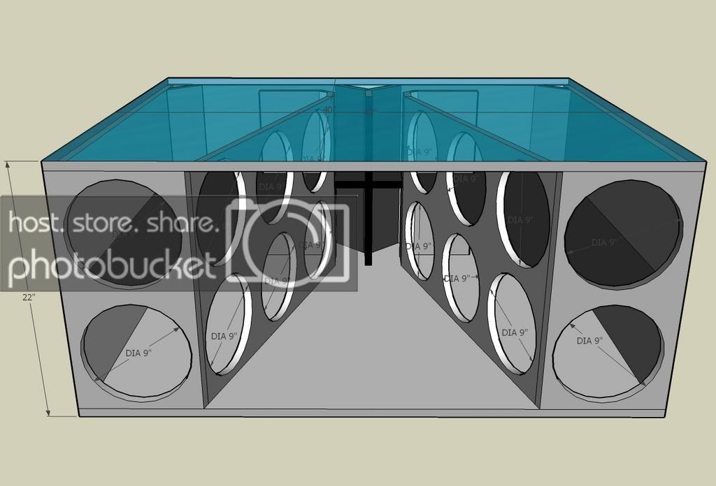

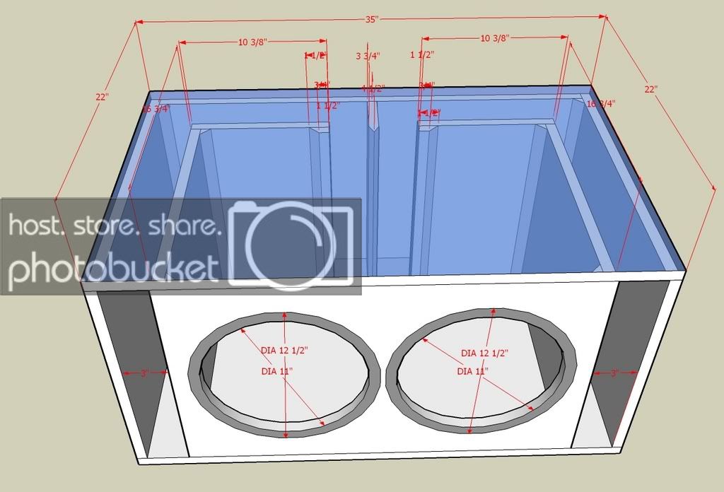

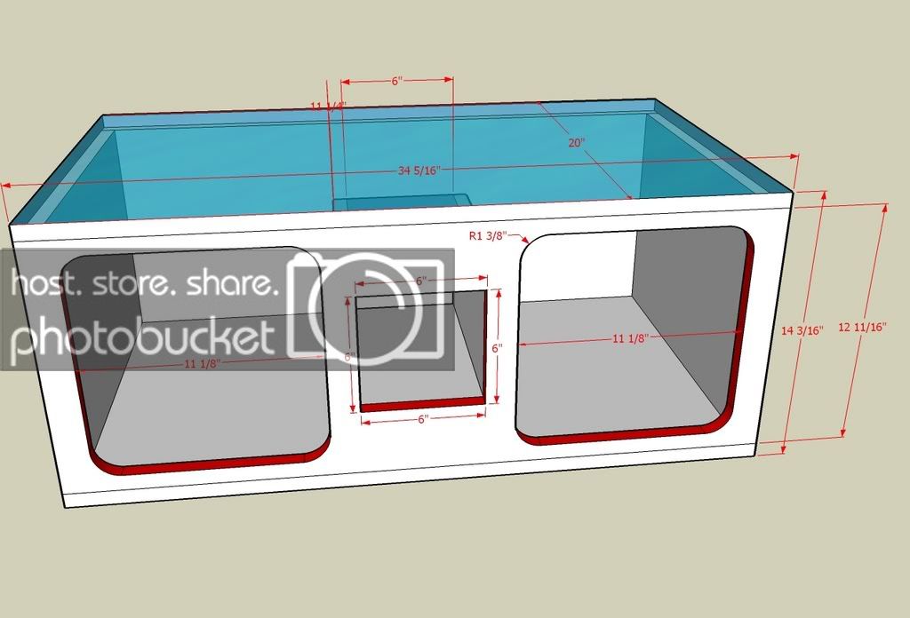

Free Box designs.
49x 40x 20 16 10s tuned to 35
Had to add 2 inch in H to fit speakers
