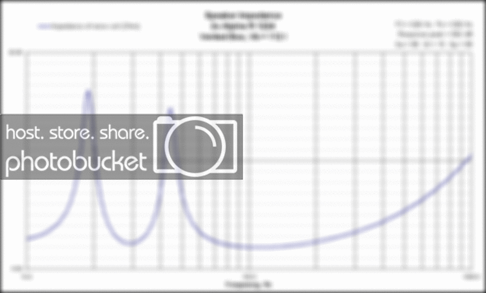

kinda like this?

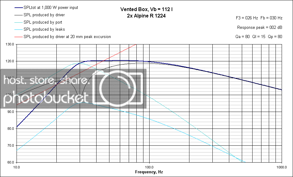

Umm... ok. You just proved my point.
[Edit: that has to be anechoic testing. Interesting to note though that the SPLtot is actually a tad higher above "tuning" or Fb even in an anechoic environment with no cabin or room gain to speak of and rising to upwards of 15 flippin ohms. Also curious where the 1,000w total power measurement was taken on that plot because if it was at 30hz where impedance was 2.5 or so; it would be interesting to know where the output was rising to 15ohms around 45hz and maintaining the same SPL.]
man, I wasn't trying to open up a hornets nest of questions I cannot answer, lol..i was just trying to place a visual of impedance characteristics and port/driver interaction..i just put something up here that folks could wrap their heads around relating to what you and hspls were referring to.
it is a older program I use on another computer with windows Vista and an older version of microsoft office. I don't know if there is a newer release or not, but I like it a lot better than WinISD..
UniBox 4.08
UniBox - Unified Box Model for Loudspeaker Design
One of those peaks is the resonance of the box/port, and one is FS of the woofer. Resonance is always found by impedence peaks.
If you own a tone generator and have some patience you can plot a full impedence curve on your woofers in-box, or you can buy a tester like WT3 that will do it quickly.

I understand all of this. My question was why were you likening resonance to tuning and the point with lowest rise to impedance peaks?
Our conversation was about where best to clamp estimated system power. Resonance and/or an impedance peak would be the exact worst spot to do that. Unless, of course, you wanted to know the least possible amount of power you would see at a given volume at any given time.
Exactly my point. To really be sure the woofer(s) will never be overpowered, one must set gains at the LOWEST impedence the amp will see. That will NOT be at resonance.
