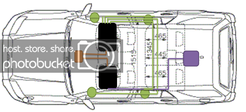

Well, total engineer move. I decided to map it out before I started anything, and this also makes asking questions alot easier. Heres my power scheme.
Do I need to run that all the way around back, or is there a way to swing it around front. I figure there has to be to get the head unit wires in, I just don't know whats going on up there.
Same question here.
How do I do the orange sections? Can i take out the center console or something? I think I'd also like to put the bass knob inside the center console. That is unless I can fit it into one of those buttons in the center console.
The more I think about this the more I want to run power up the front, it also keeps the wires separate which is what I assume was intended by "speakers one side, power other" mantra?
Also, could I screw some brackets into the sub so that I could chain/rope it to my trunk? I'd really perfer not to screw it into the ground, and if its movable I could use my trunk more. My roommate has his loose and its been find for him, I just worry since mine is more square than his 2 speaker sub. I guess I just need to get a feel for it's girth once it arrives.

your power wiring diagram looks good. make sure u get solid ground points for the 2 amps, preferably to the chassis and not sheet metal. a seat belt bolt, sanded down, does well.
your speaker wiring diagram also looks good. however if you dont want to run new wire into your doors, which can be a pain in the ***, run your outputs from your 4 channel amp back up to the headunit and splice into the original speaker wires from there. if you get your hands on a wiring diagram for your stock harness, you can see what's what. (you'll need to know the the +/- for each speaker, as well as the remote wire).
you can place your bass knob in the center console, i drilled a little hole for mine. as for where you will run those wires, it depends on the car. i ran mine behind the headunit, down in the drive side kick panel (above the pedals), and through the door sills. if there is a way for you to get underneath your center console and gearshift though, and run through there, it will probably be much easier
looks like you've started down the right path. i like your diagrams and planning, you'll find that will help you a lot.

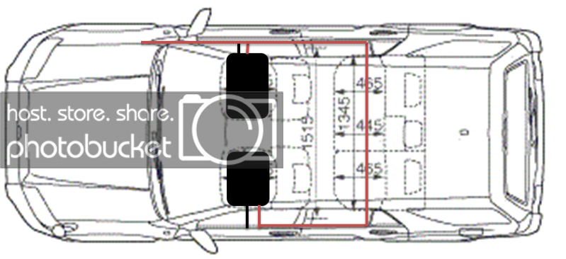

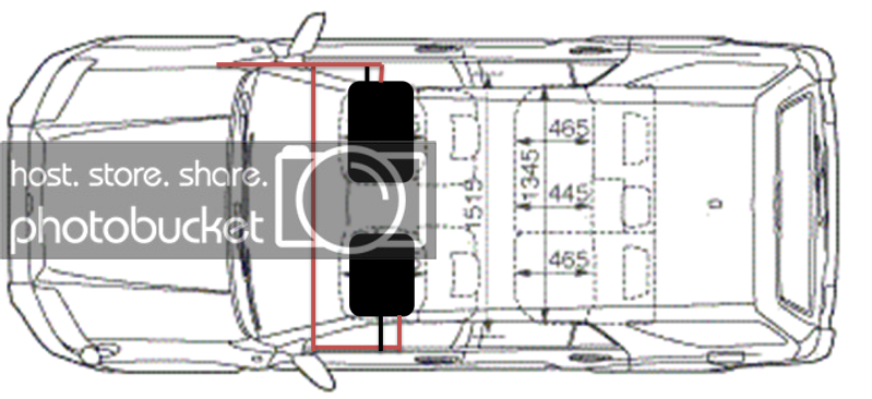

Thats a **** smart idea about the carpet Hope. So I should plan on just taking out the seats (i checked on how to that yesterday, does not look to be a big deal) remove the floor vent for the AC, and then trace the outline of the amp onto the carpet and remove it. Whats the difference between a layer of carpet in between the amp --> car as opposed to a wooden alternative? I just ask because mutilating the carpet might not look so hot when i'm done, and I'd need something to secure the lose carpet down wouldn't I? Additionally, I'm not terribly concerned with running the wires under the carpet, the little wiring track is right there at their outputs. I was just going to use some of that black cable shielding to protect it on the way.
However, now that i'm thining about this, are you saying to remove the carpet. Wire and place the board. Then cut slits in the carpet for the wires to pass through and bolt down the amp (basically just inserting a board under the carpet for support). I could be down with that, it seems much easier on the carpet (if it would fit over the board).
i mean this. you only cut slits in the carpet that are easily closed up if you sell the car. no one cares about slits under the seats.
the board would be bolted to the vehicle floor. the amp would be screwed to the board. wires would be taped down to teh vehicle floor - i find aluminum foil tape (like for HVAC ductwork) works very well as it is designed to stick to metal and doesn't leave a residue when removed. this will look/work the best and wires won't be exposed so they can't be pulled when stuff gets shoved under the seats.
