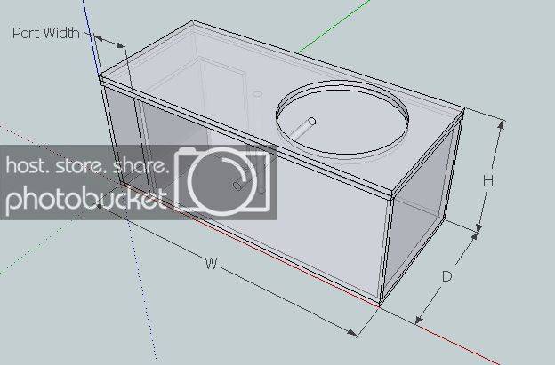

I just recently got my soundqubed hdc3 18 in the mail and would like to make a ****** box for it. Ive never made one before so I would like some help.
Vehicle : 2004 chevy blazer
Location in the vehicle: rear
Space available (Length x Width x Height): 38 wide, 22 1/2 height, 29 length ( front of the car to back )
Subwoofer make and model: Soundqubed hdc3
Subwoofer Size: 18
Number of Subwoofers: 1
Type of Port (Kerfed, Slot, Aero, etc.): slot
What type of music do you like?: rap, techo,
Is your goal SPL or Everyday Music?: everyday
Tuning Freq (Hz): lowest recommended tuning
Volume : the bigger the box the better as long as it sounds good.
Questions: Im going to be pushing this with a sundown sax 1200 so im assuming the box needs to be on the bigger side since im going to be underpowering it. Like I said this is my first box, I looked on the website and cant find what to tune the box too but ive looked around and seen that people say they like mid- high 30's
Sorry I just realized the title is sort of misleading lol
F b = 3 6 H z
V b = 6 f t ^ 3
E x t e r n a l H e i g h t = 1 9 . 7 5 i n
E x t e r n a l W i d t h = 3 7 . 5 i n
E x t e r n a l D e p t h = 2 3 i n
P o r t W i d t h = 5 3 / 4 i n
Does this look good for my setup? Should I double up the mdf on the port, and do 45's in the corners?
