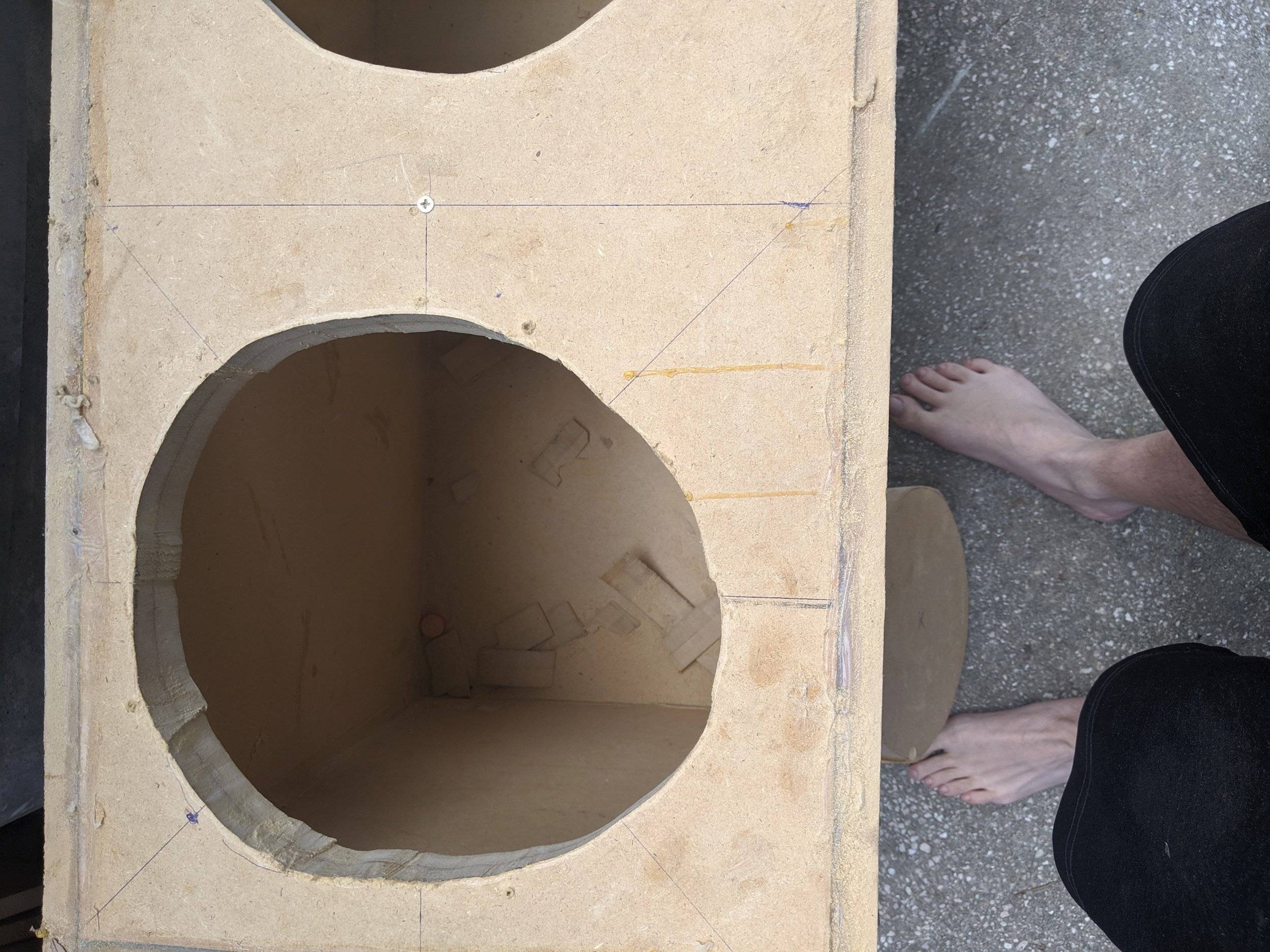

Not butt hurt. Just have to start over.
Made a hole that was tuuurible
18309
Maybe you can save that, slap another piece over the entire front then cut out the mounting holes better and the port.
Id at least try.
Or rebuild... Practice makes perfect.

You're right that'll work.
Glad I got my feet wet with cheaper mdf board. Almost bought birch but thought better of it

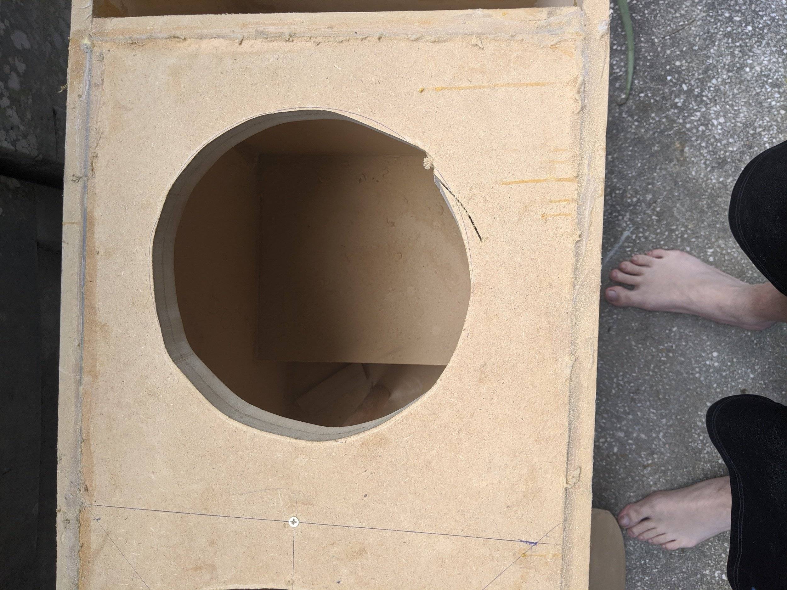

Just use a scrap piece with 2 screws a radius apart, run one screw in a bit where you marked center and use the other to scribe a circle. Afterwards just darken the scribe mark with a pencil so you can see it easily, drill a hole inside the marked circle big enough for the blade and then cut carefully and slowly.

Just use a scrap piece with 2 screws a radius apart, run one screw in a bit and use the other to scribe a circle. Afterwards just darken the scribe mark with a pencil so you can see it easily, drill a hole inside the circle near the mark big enough for the blade and then cut carefully and slowly.
Ghetto protractor...
That second hole was done using a version of the ghetto protractor lol
Just went too small
