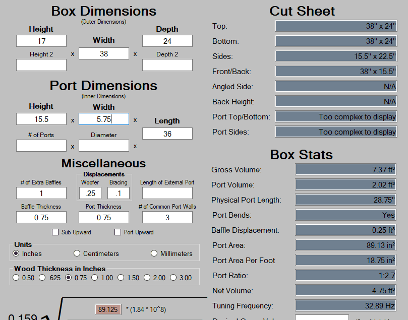

I was given this box plan. I will be buying the wood in the morning to begin

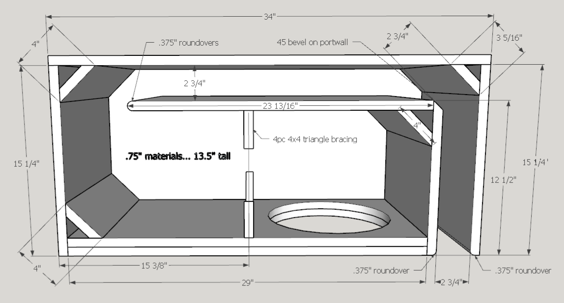

Looks like one of those SRT forum free designs. Ought to do fine, but there's always room to improve imo.
I'd probably add a 45 in the port bend (maintaining spacing) minimum. Plus I'd add some bracing & 45 2 back corners (crook of the port bend and opposite the port entry) if I could.
Similar to this...

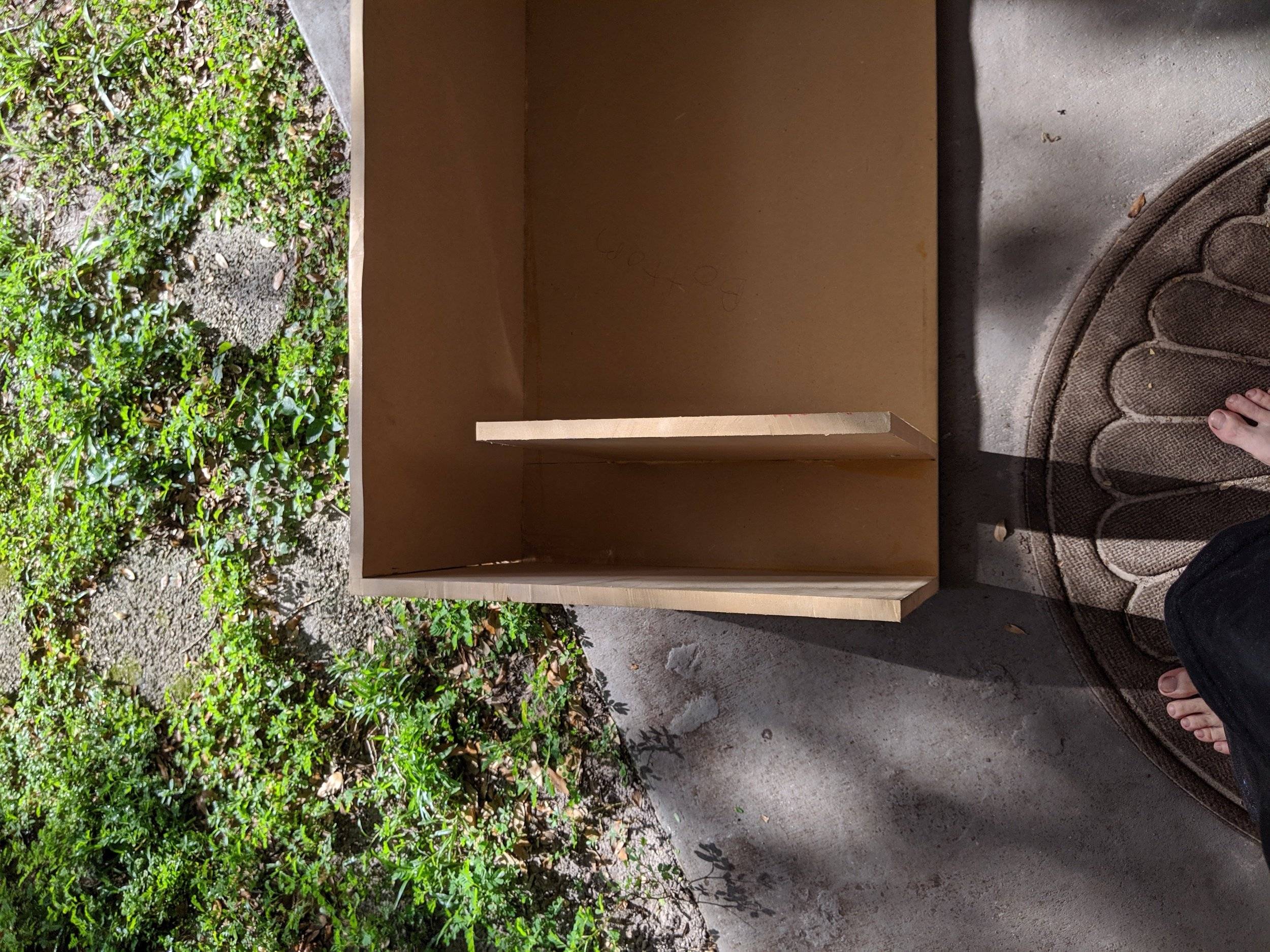

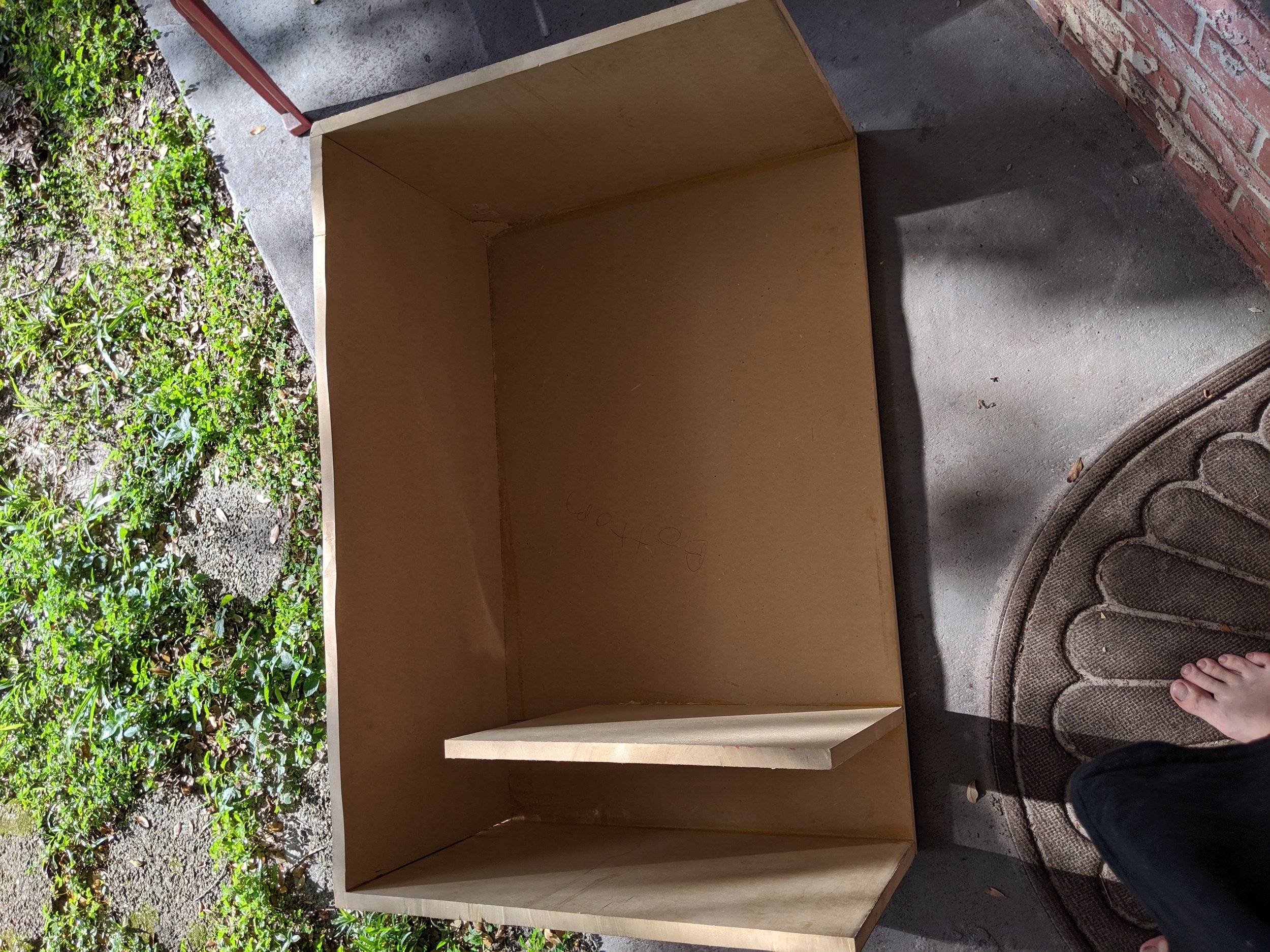

Thanks but I'm going to try and build the simple box without cutting off my fingers before I get into anything like that
I was very frustrated and in the sun when I made that earlier post
18296

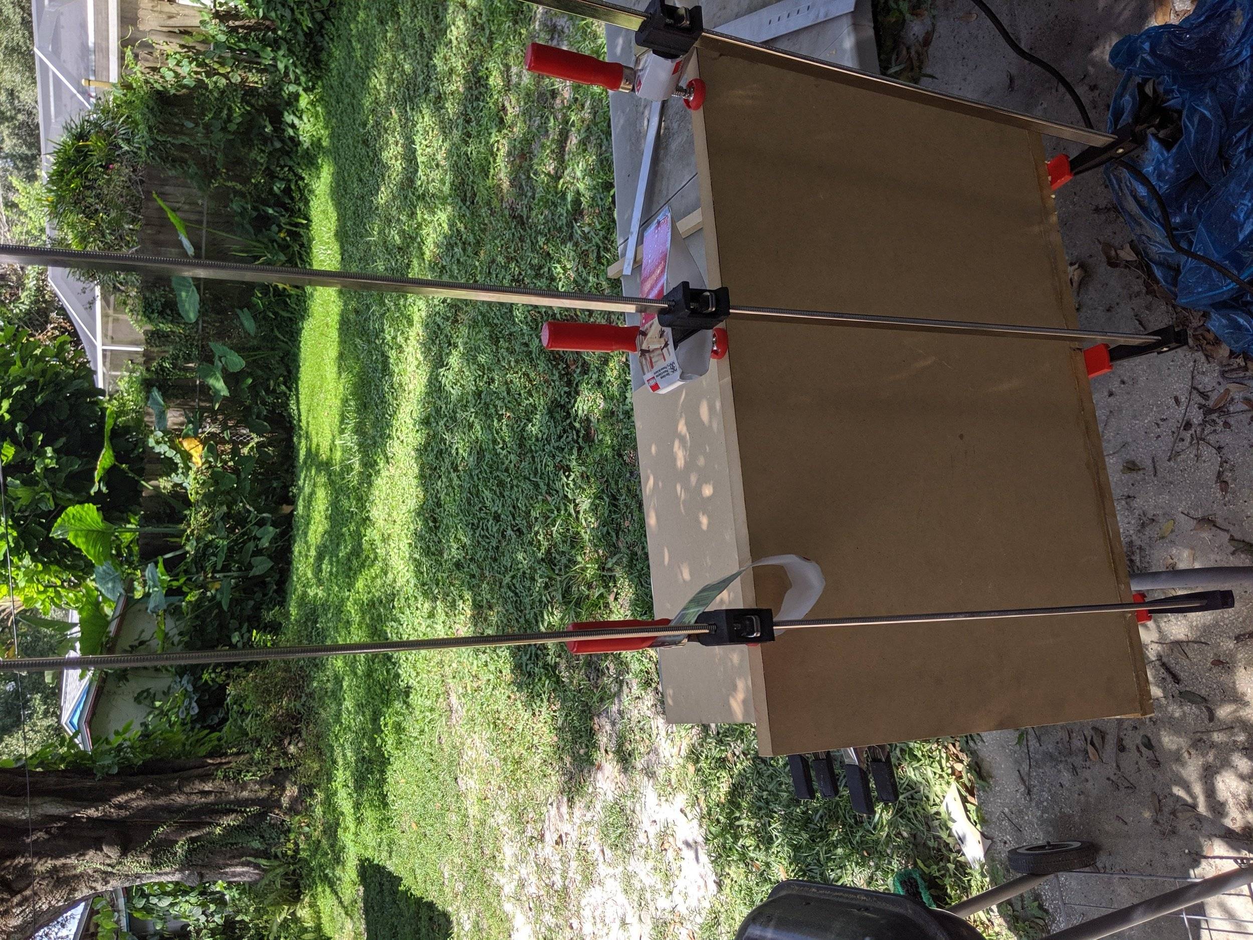

I'll add silicone tonight and finish tomorrow
There are very small gaps that I should be able to fill in
