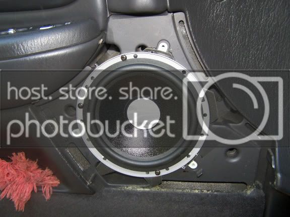

BTW here is a pic of the stock location in my car.
looks like a chrysler door
mines very VERY similar
