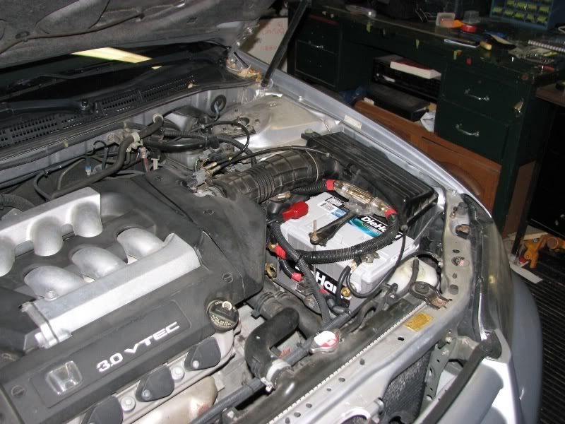

Here's a pic of what I did:
My new battery - Die Hard Platinum P-4 Group 34/78DT
The 135 Min. Reserve Capacity and Warranty were the selling points. My RedTop was 7 years old and no longer resting at >12V.
Power Ratings:
Amp Hours at 20 Hour Rate: 68
Cold Cranking Amps (CCA at 0 deg.F): 880
Reserve Capacity (RC): 135 min.
It is made by Odyssey and is AGM
