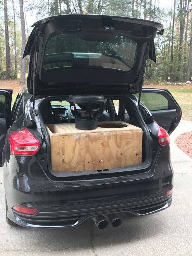

Check out the Rockford Fosgate dsr1. Ran it in my focus ST. I personally would do a couple sundown sa8s.
Could you post a picture of your subwoofer box? I’m trying to keep that false door in tact as much possible. I’ll definitely look into the dsr1, just gotta find out which adapter I need.
Also what are your opinions on two sa8’s? Since you suggested it :eek:
How much space do you have for a box? Why are you so certain you need to tune at 33hz when you haven't even chosen a sub?

Sundown has some box plans right on their website, have you checked if any of those will fit? Generally speaking I'd stick to what the manufacturer recommends for box volume and tuning (using the largest recommended size of possible). Try that, see how it goes and if you really feel you're missing something build a new box, buy a new sub, or whatever... work from there. But manufacturer spec should probably be your starting point.
