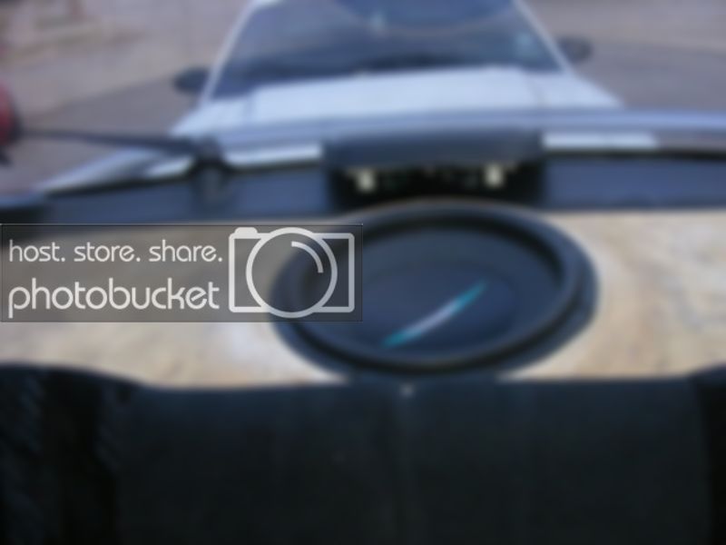

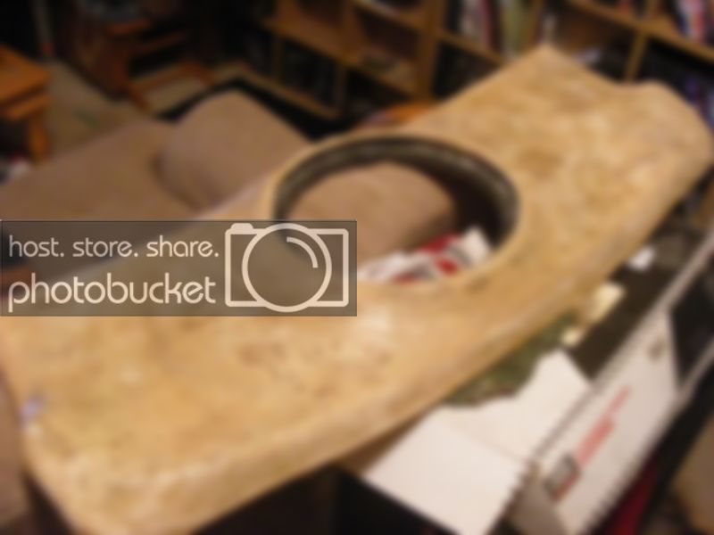

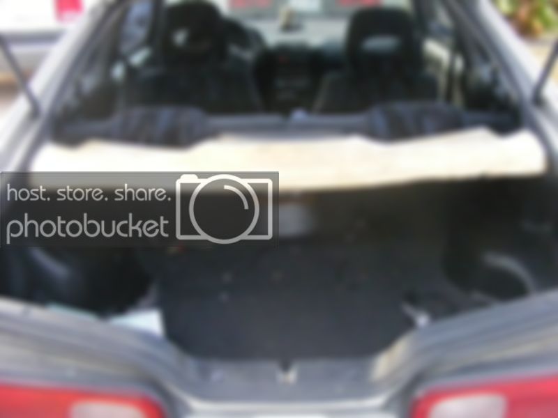

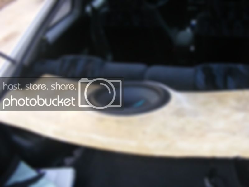

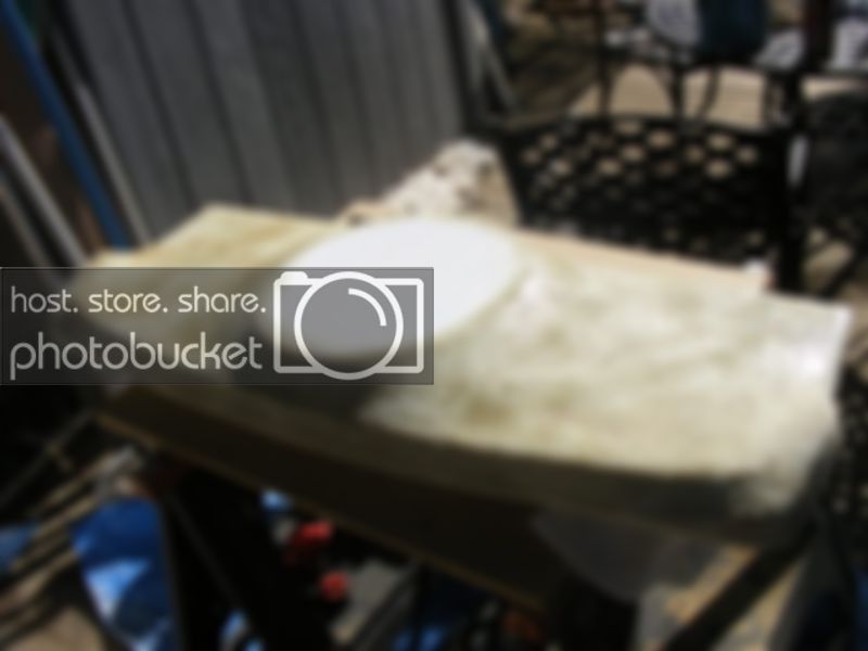

The baffle is done just needs to be finished but i have not decided.
Wrapped
resined
finished, has 9 layers of 1.5oz mat plus the fleece.
I have pictures of th kickpanels somewhere ill see if i can find them

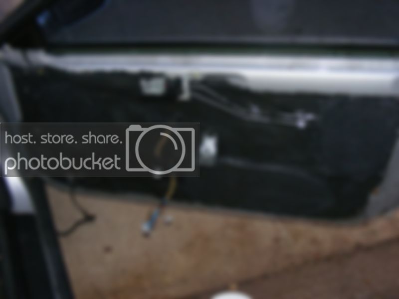

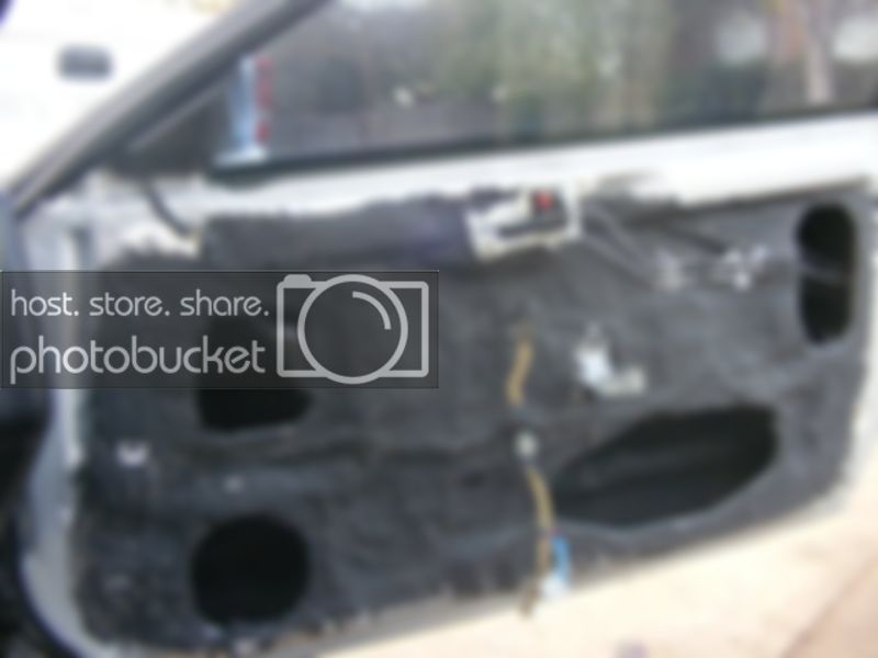

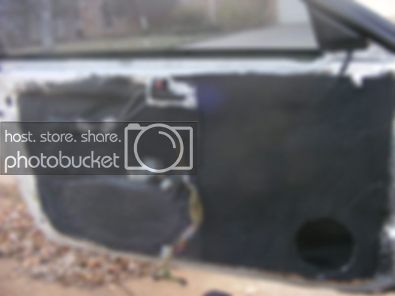

As for what i did today got my more sludge and sealed up the front doors.
Each door has a layer of edead //content.invisioncic.com/y282845/emoticons/mad.gif.c18f003ab0ef8a0d9c27ca78d77a6392.gif layer of damplifier and some random raammat. Then covered by sludge and then covered in overkill close cell foam
Passenger door sludged
Inner doorskin with 2 layers of mat, sludge and
overkill
door sealed and sludged up, did not get to foam the outside yet because the sludge is not dry
Driverside sealed up and dry half with overkill
Tomorrow just gotta screw in the baffles mount the midbass and clay them in.

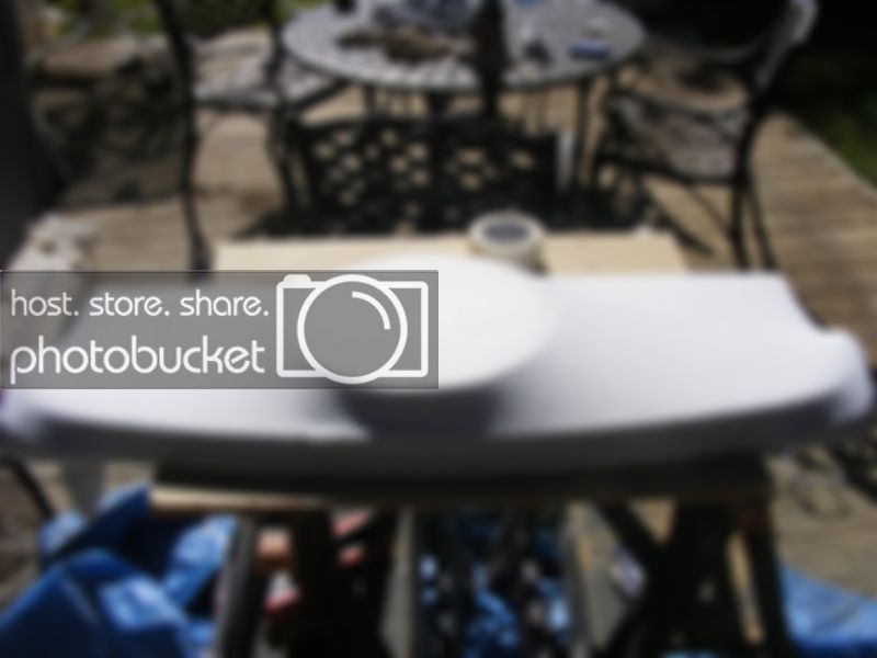

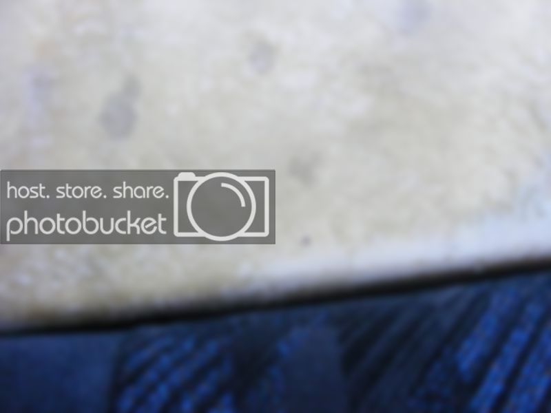

Didnt really do anything today, had to build a dash piece for a dude, got a little sanding but i ran outa discs for my angle grinder and cant find them anywhere (its a matco?) So i could only hand sand.
Needs sanding on the right side as you can see, im going to buy a new sander tomorrow if i cant find some discs. Also need to work on some sealing issues on the baffle, will most likely use foam under the carpet
Looks pretty sweet
Small gap on the front side, no no for an IB
