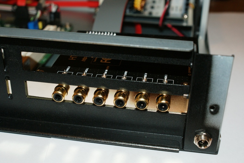

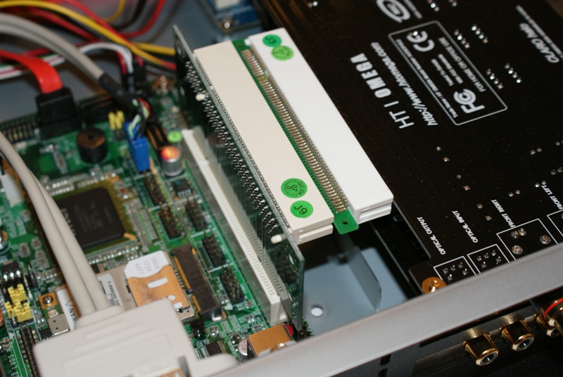

I must change Raiser card because this is not so good:

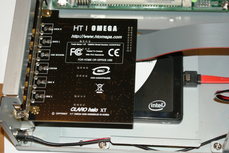

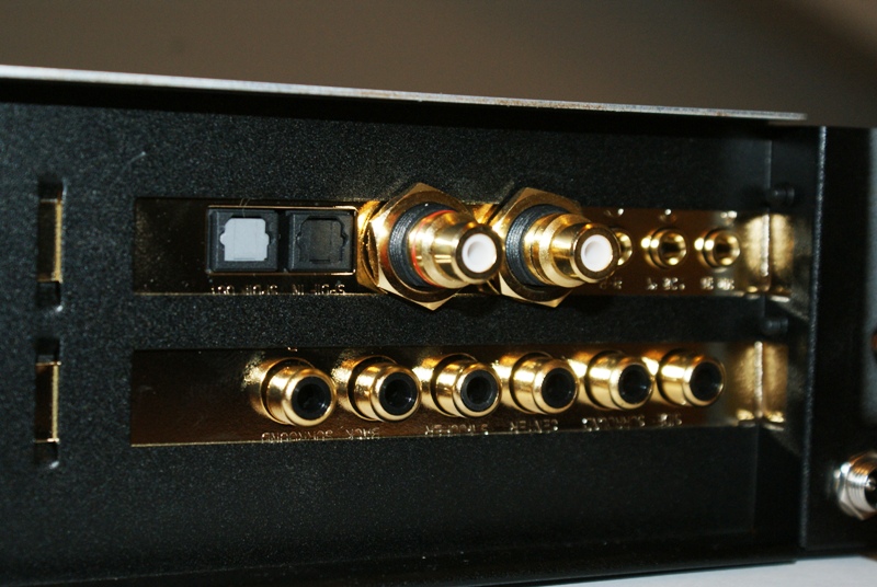

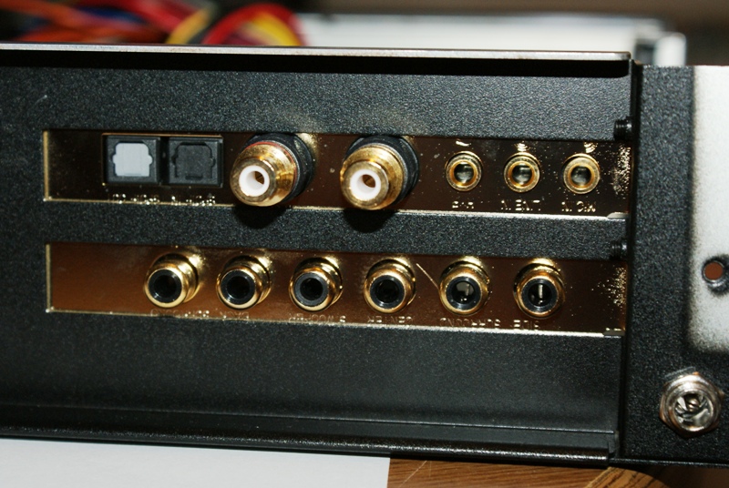

Few details about sound card:
-C-Media Oxygen HD CMI8788 Audio Processor
-TPA6120A2 - Built in 120dB Headphone AMP IC from TI supports up to 600ohm headphone
-Swappable OPAMP socket for all analog channels. Factory installed opamps are 4580 (JRC)
-8 RCA Outputs, digital optical Input&Output, digital coaxial Input&Output(On PIN Header), MIC input, line input, headphone output, MIDI in/output(PIN header), CD IN, AUX IN...
-Support: Dolby Digital Live, Pro Logic IIx, Dolby Headphone, DTS INTERACTIVE, DTS NEO:pC

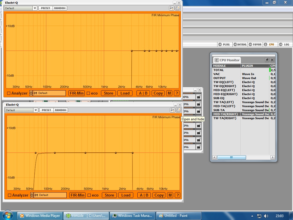

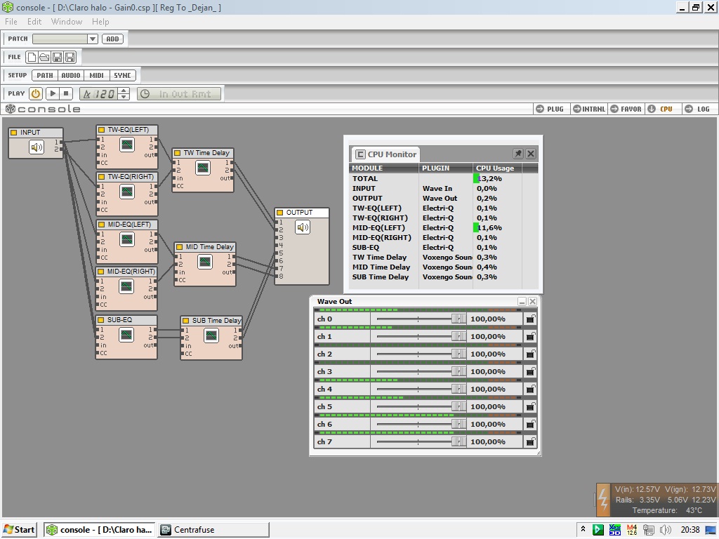

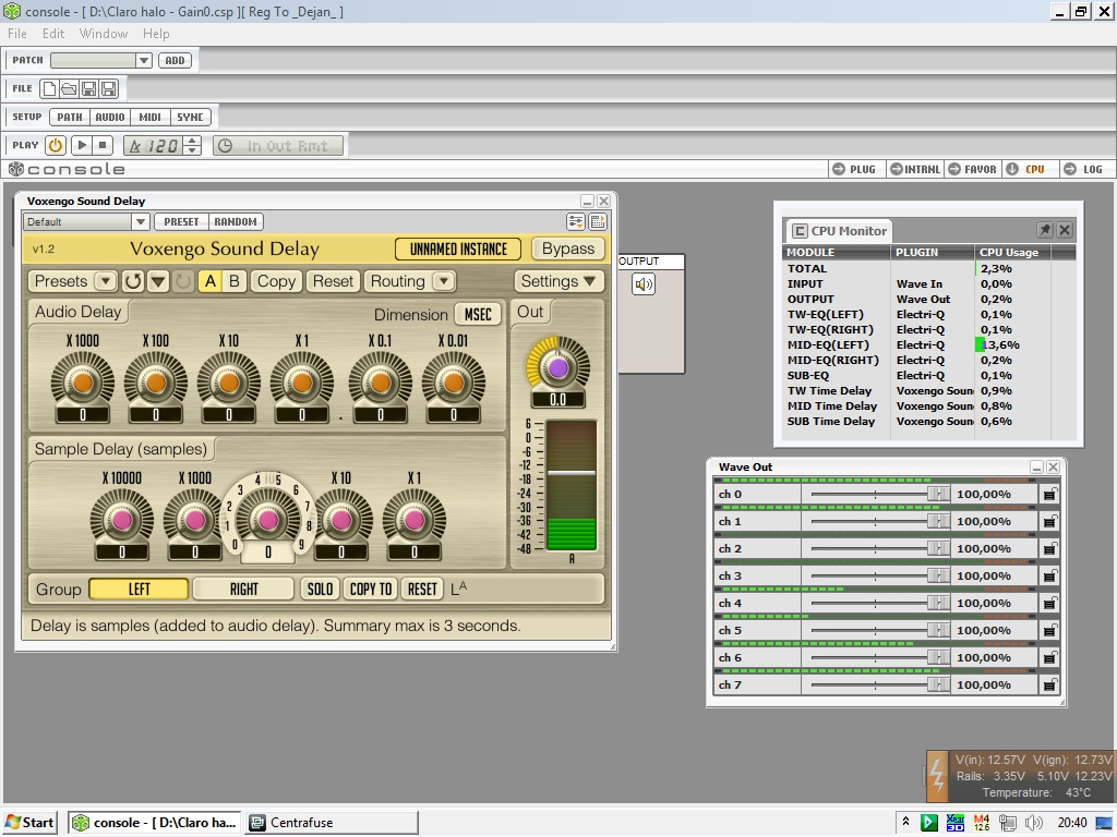

First design of my active system:
Crossovers and EQ prepared - In picture left tweeter(UP) and MID(Down):
And Time Delay for one channel:
I am speechless. I work in IT and also consider myself somewhat knowledgeable in car audio, at least with the basics.....non active systems...etc
BUT, you sir know the electronic details of ALL!
I will be visiting this thread and reading through it multiple times!
Thank you

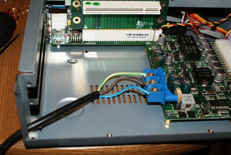

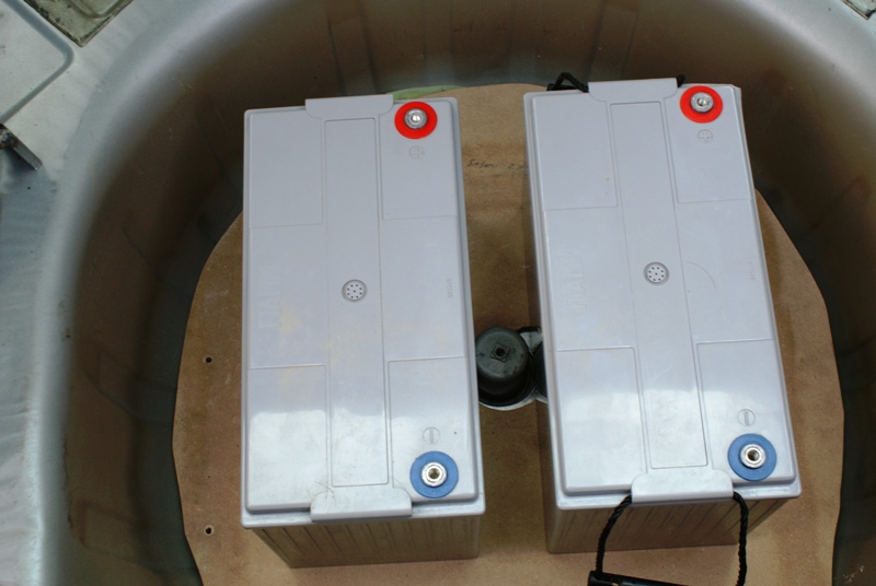

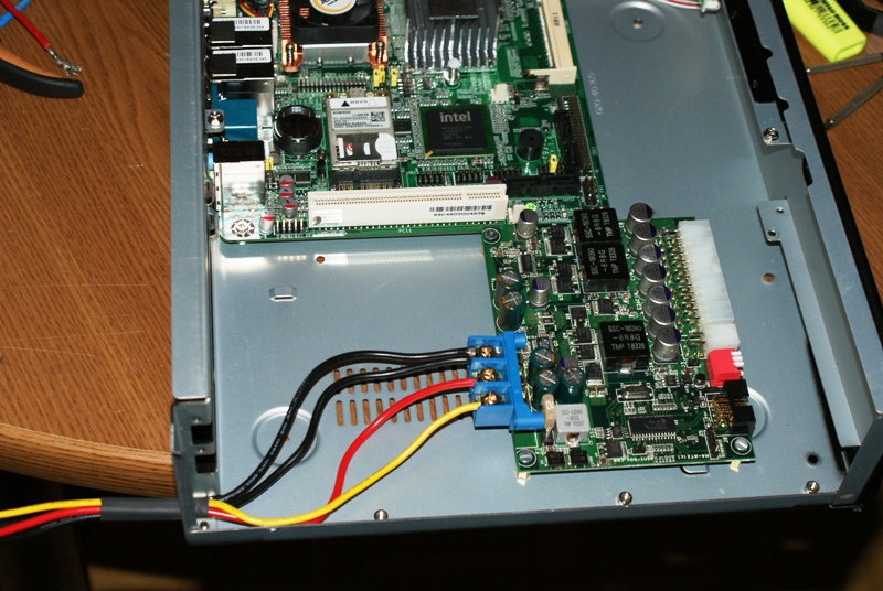

First mounting and connecting new power supply:

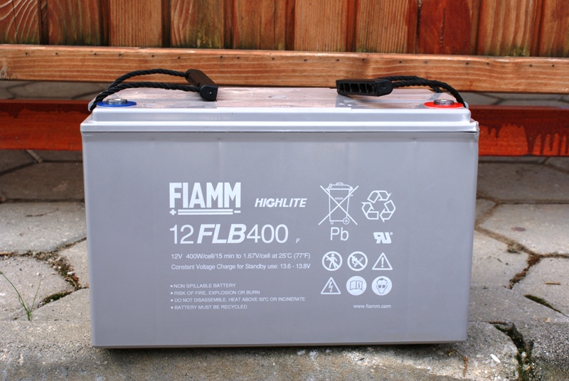

Im get new battery which will be in boot...
2x //content.invisioncic.com/y282845/emoticons/smile.gif.1ebc41e1811405b213edfc4622c41e27.gif

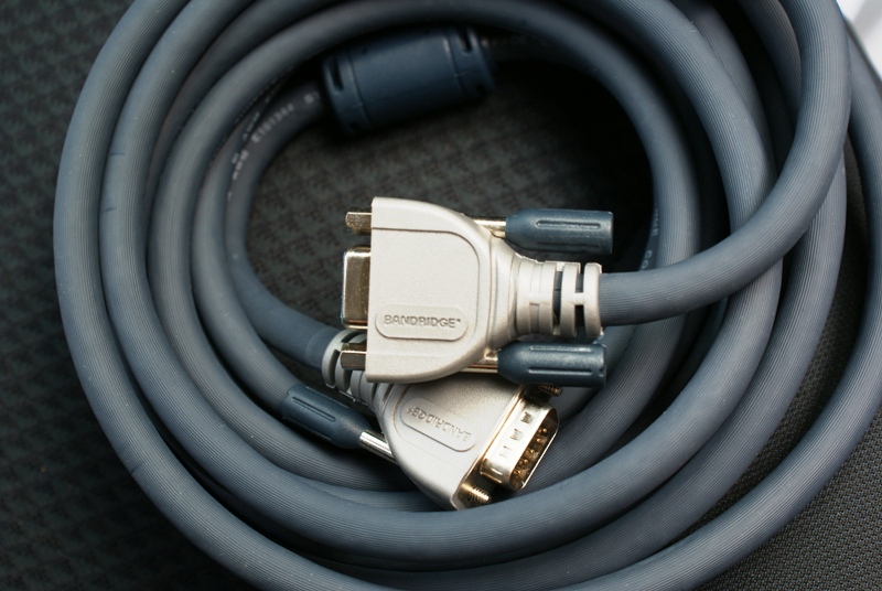

New VGA cable:
Tomorrow I will continue...
