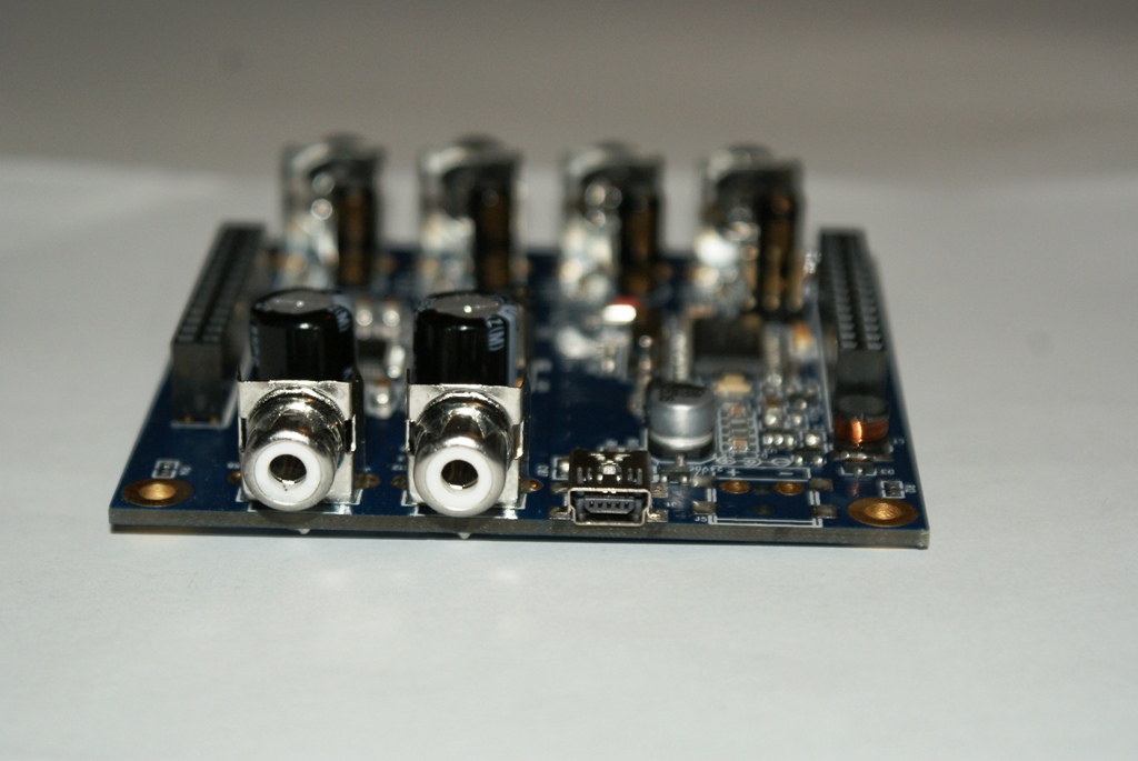

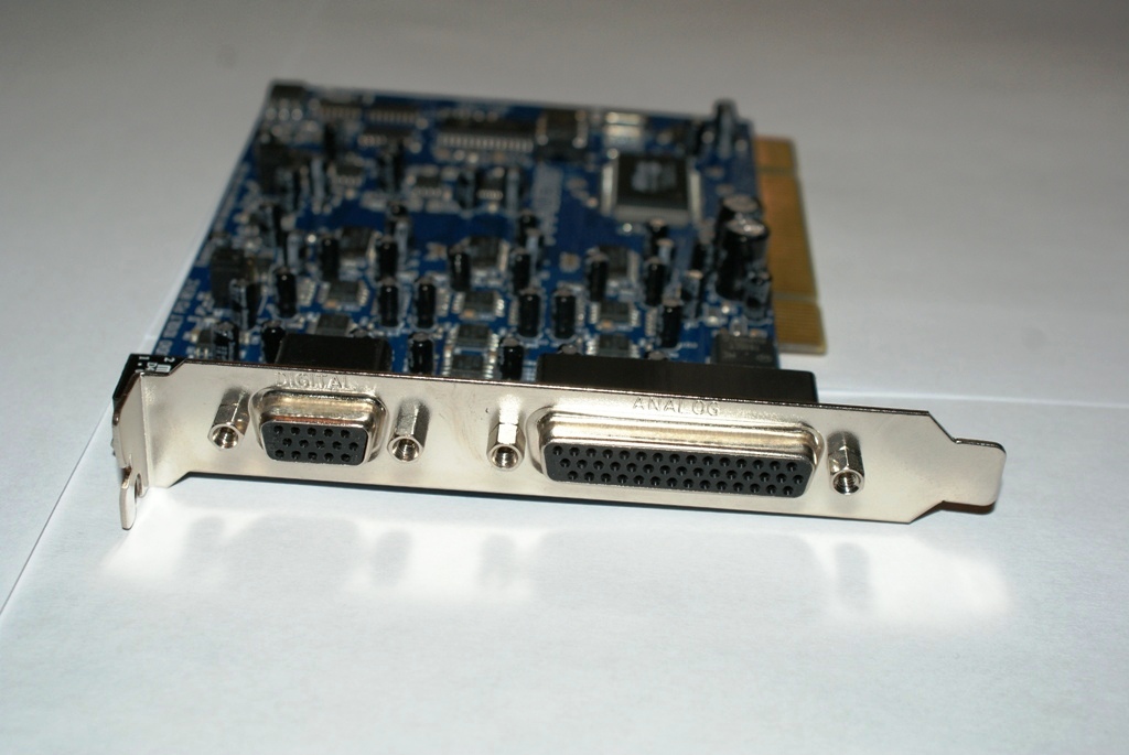

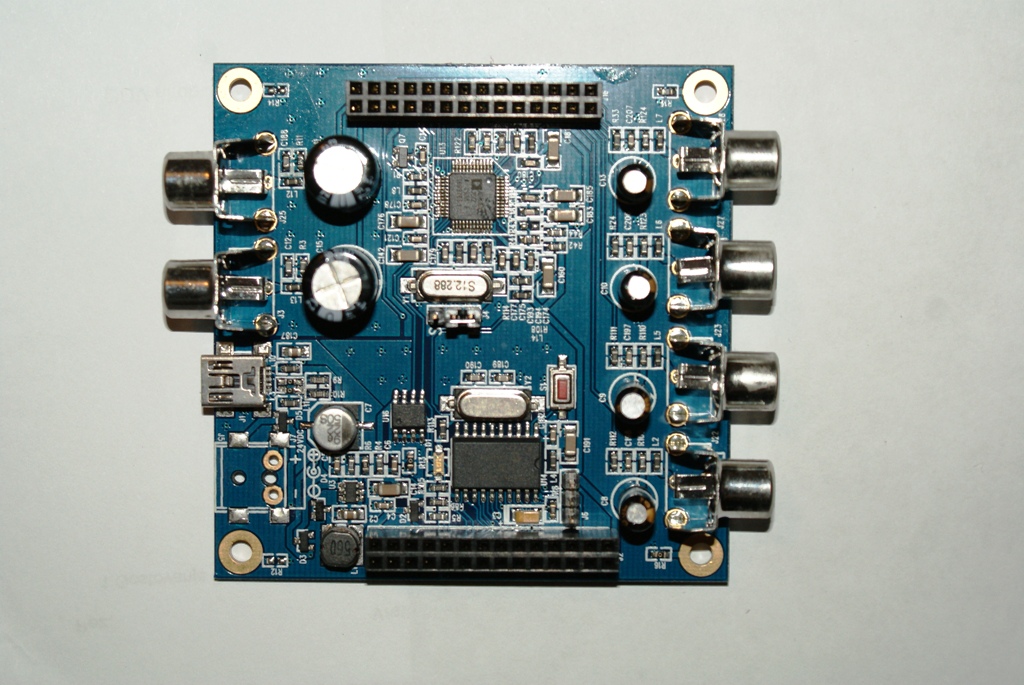

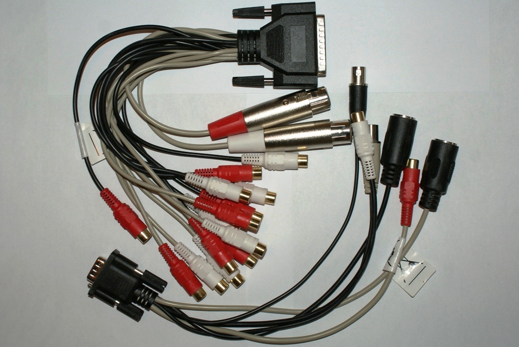

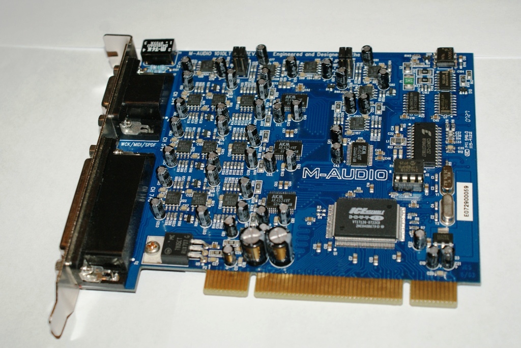

First Im replace my sound card to new one:

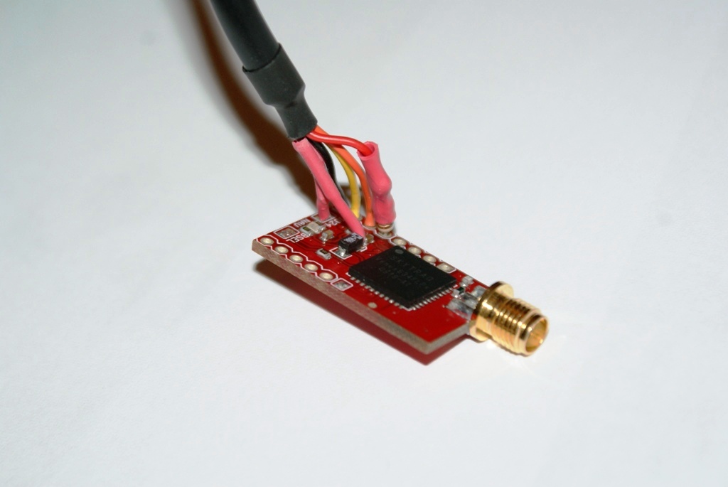

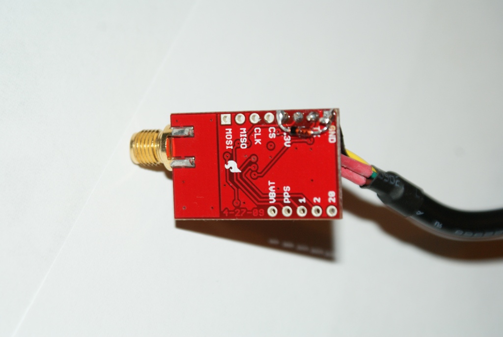

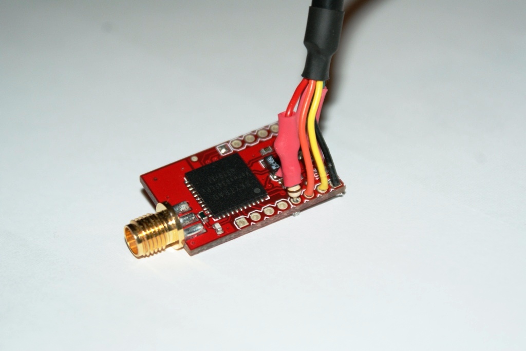

Then Im install 10Hz SparkFun Venus GPS module. Normal USB GPS have update rate 1Hz which mean that update position every second. This module update position 10x in one second... Because TTL 232R cable have VCC 5V board need 3.3V Im make little modification. Signal voltage is 3.3V which is OK...

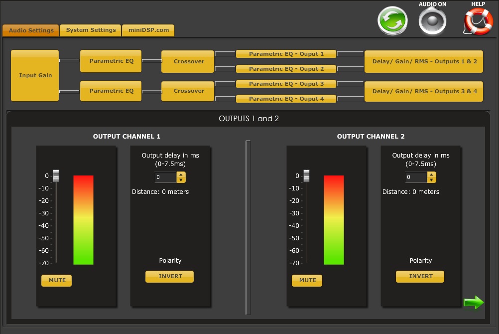

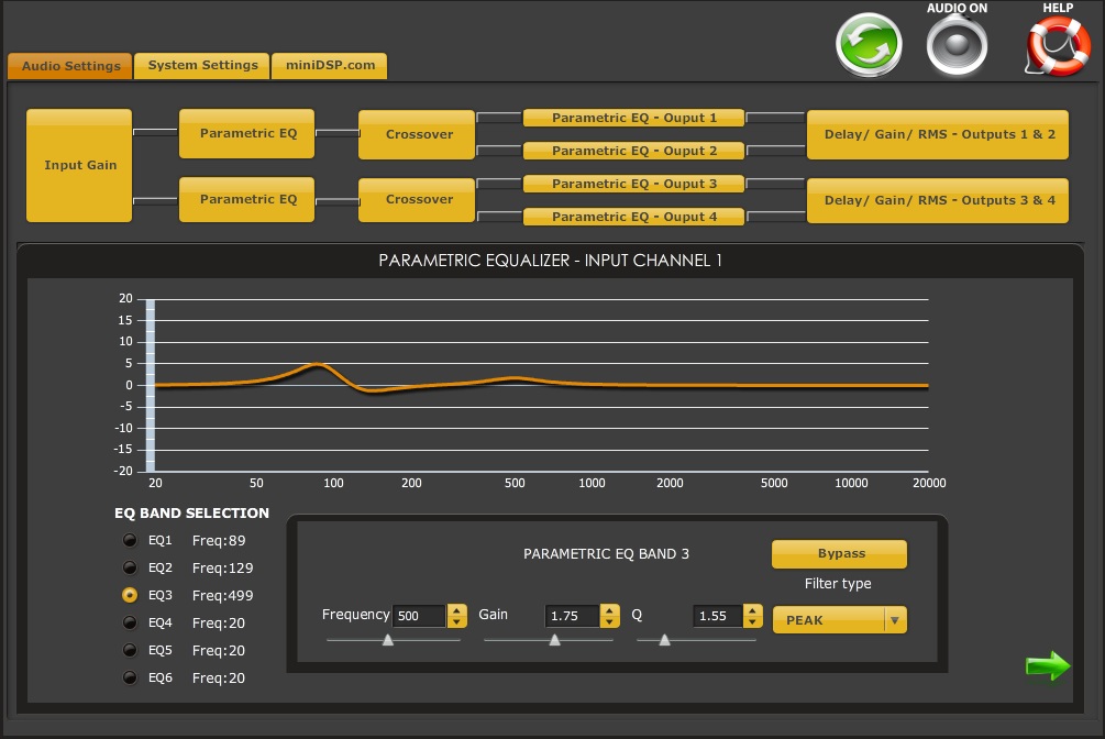

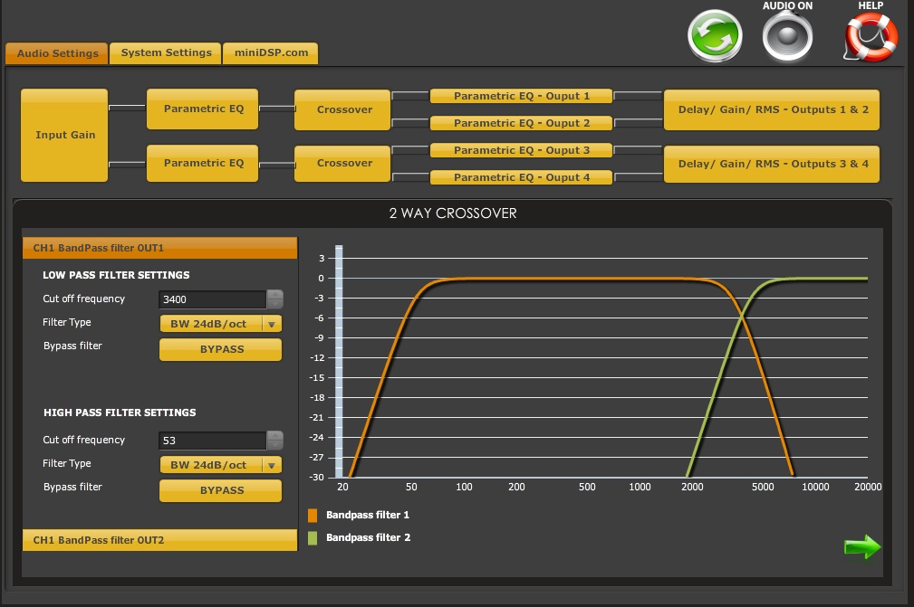

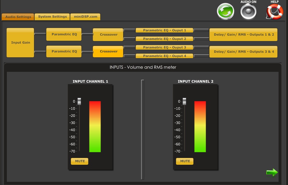

Software:
Input gain:
Parametric EQ on input (Same is on each output):
Crossovers:
Output gain, time correction and phase:

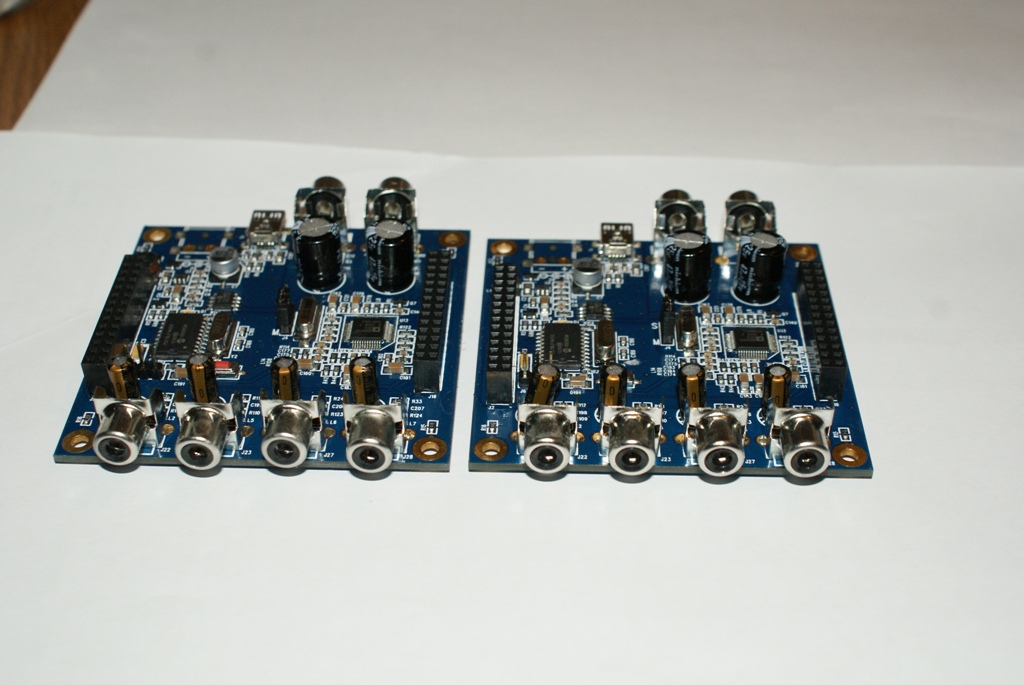

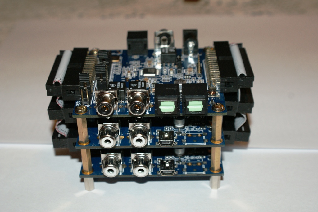

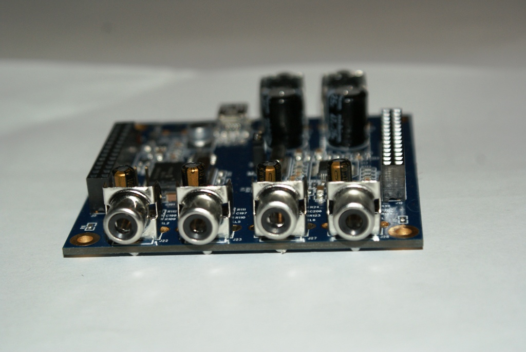

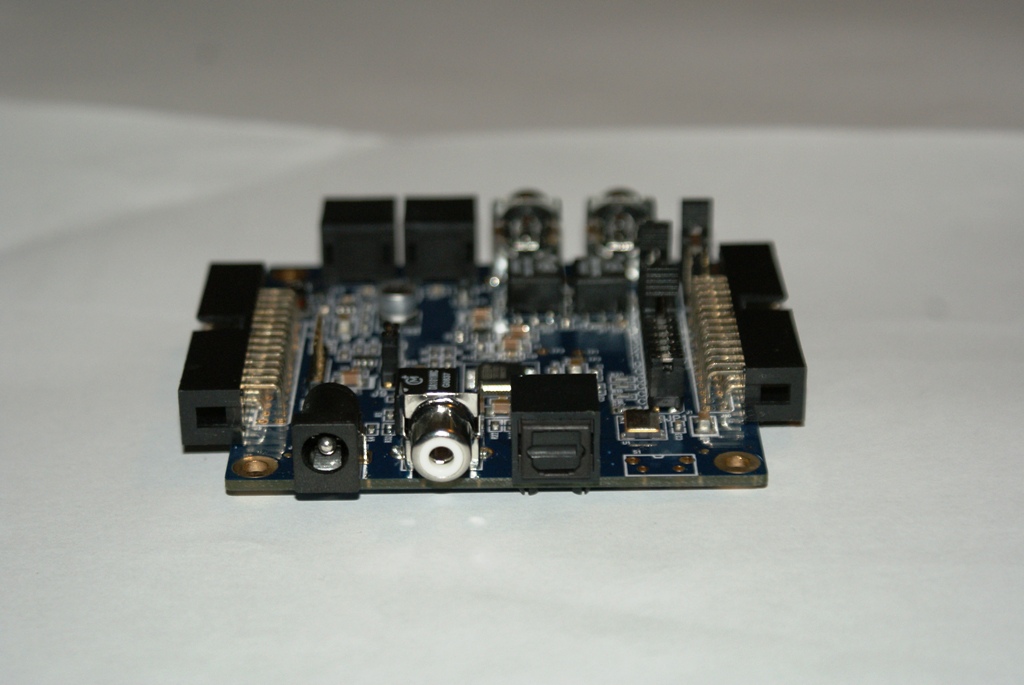

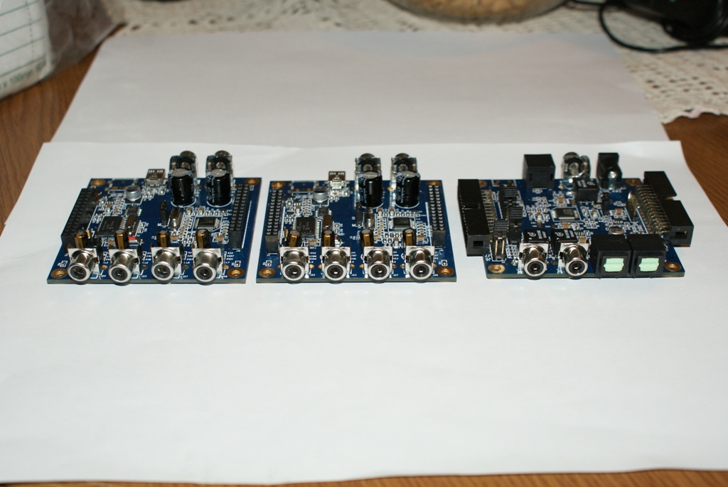

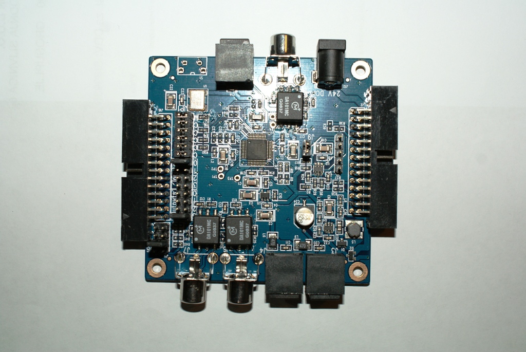

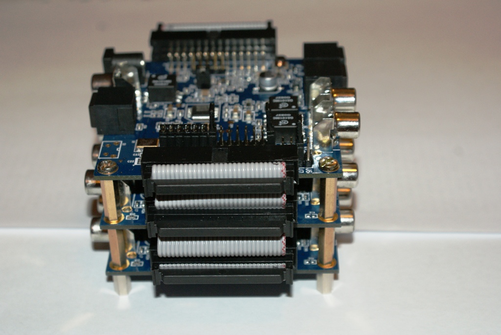

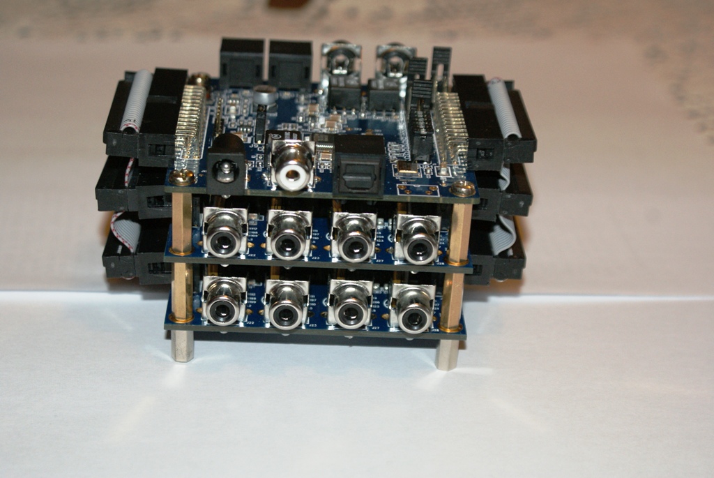

One board will be used for TW + MID another one for MIDBASS + SUB, third is input board(optical or SPDIF)...

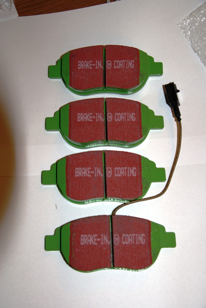

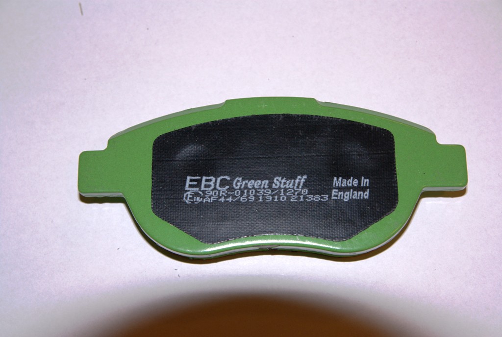

First Im change brake pads and rear discs:

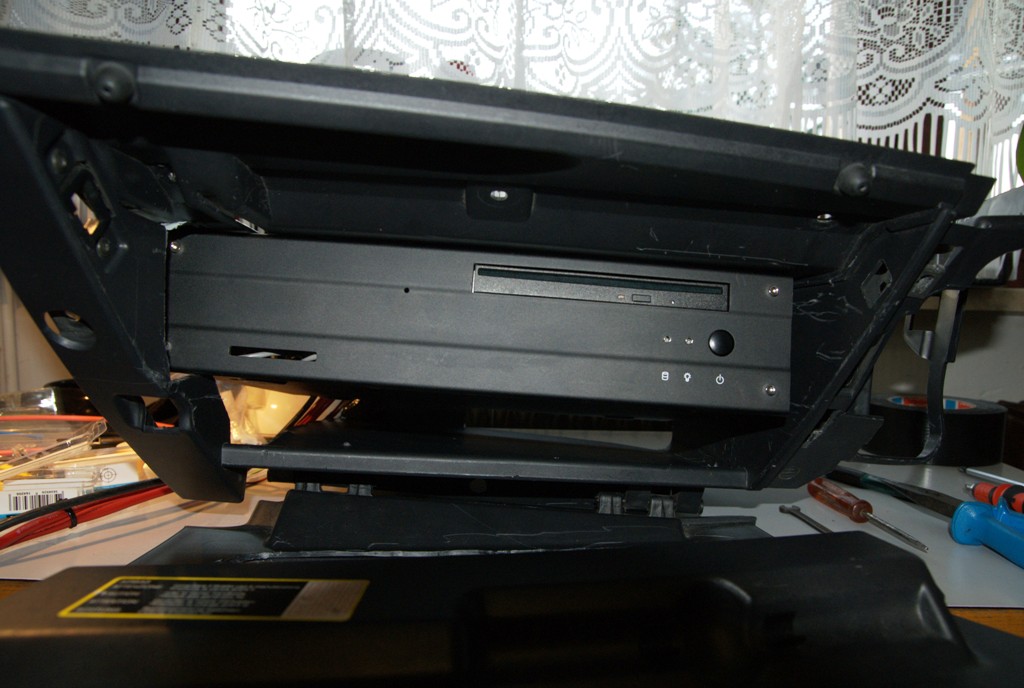

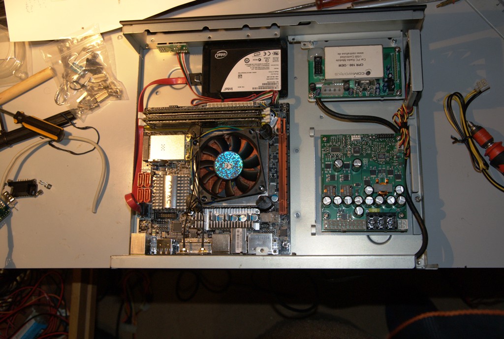

Because my carpc has stop working Im decide to buy and build new one:

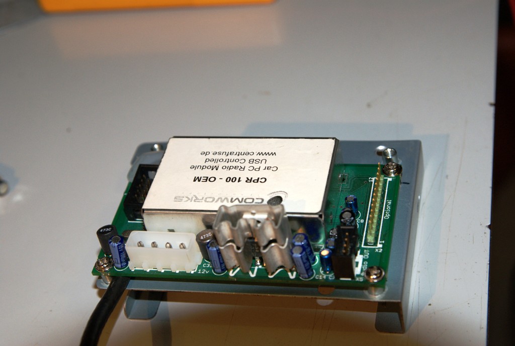

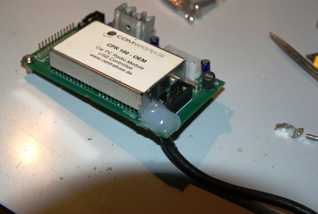

First Im take my old AM/FM radio device and little modify it:

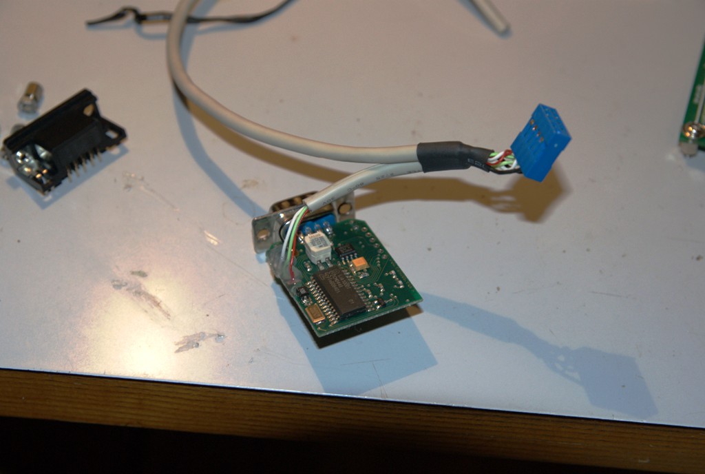

Then Im add CANUSB device which get CAN data and will be used for diagnostic and steering wheel commands:

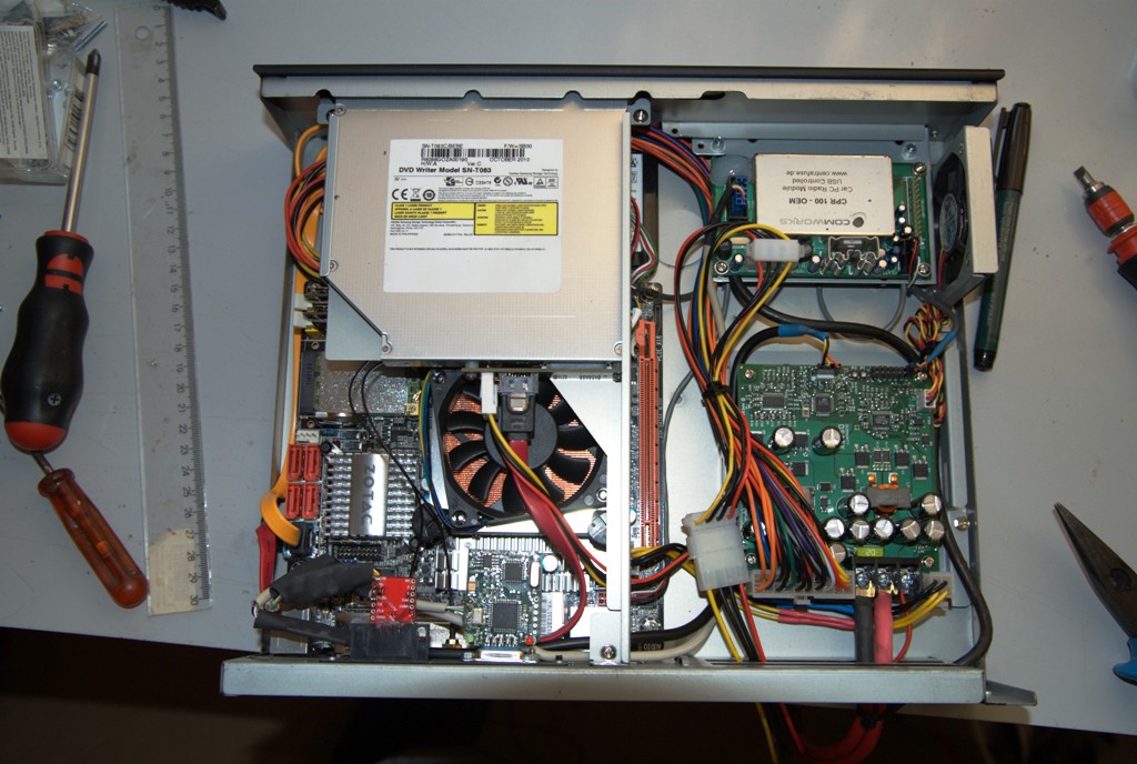

Put all into case:
DVD device for MP3, Audio CD, Video CD(Divx and other formats), DVD Video, DVD Audio:

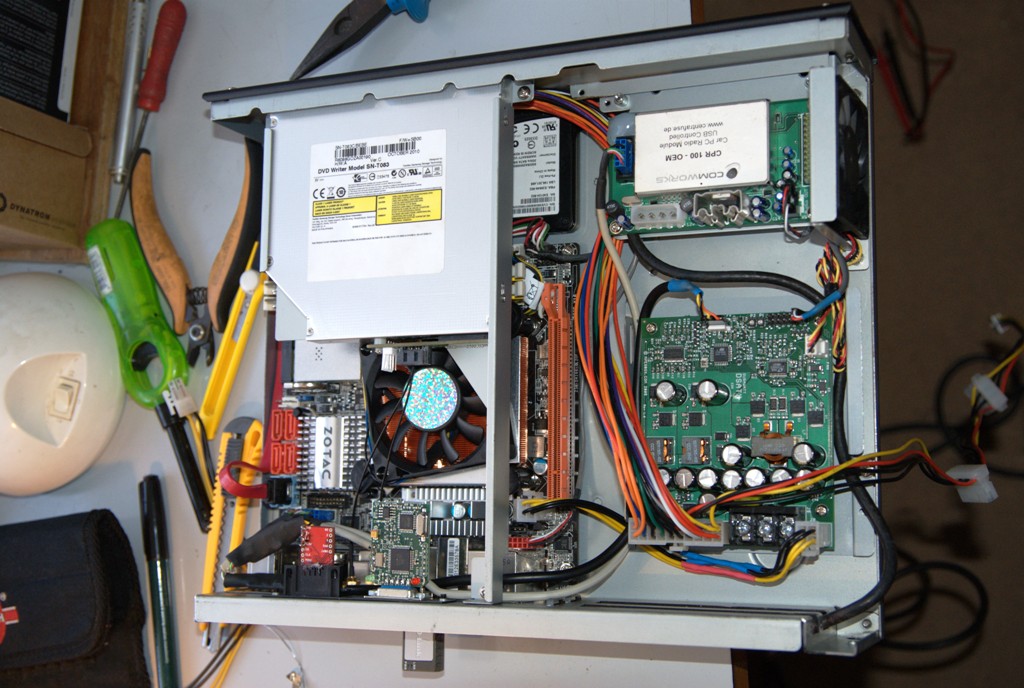

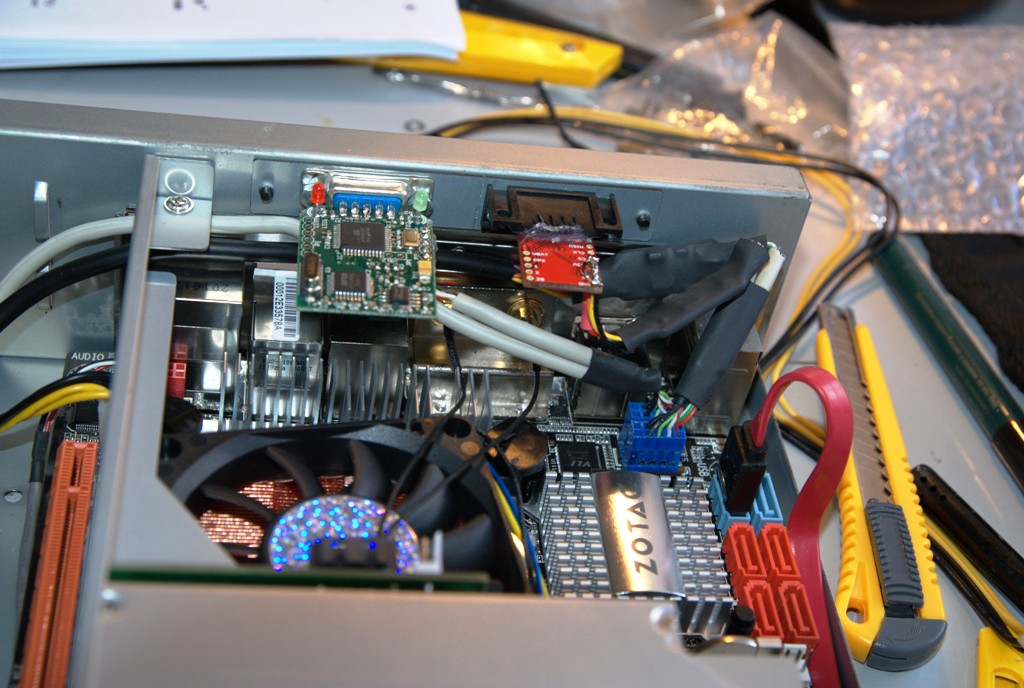

Mounted CANUSB and GPS into case:
All components:

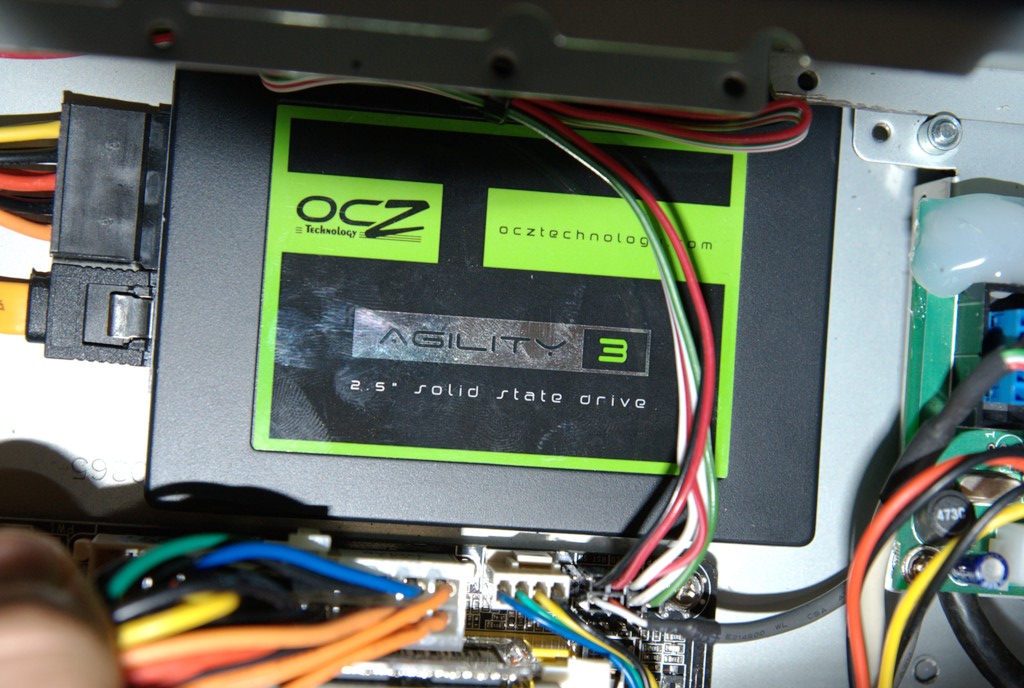

Then Im figure out that my Intel SSD has die too and Im replace it with new one:

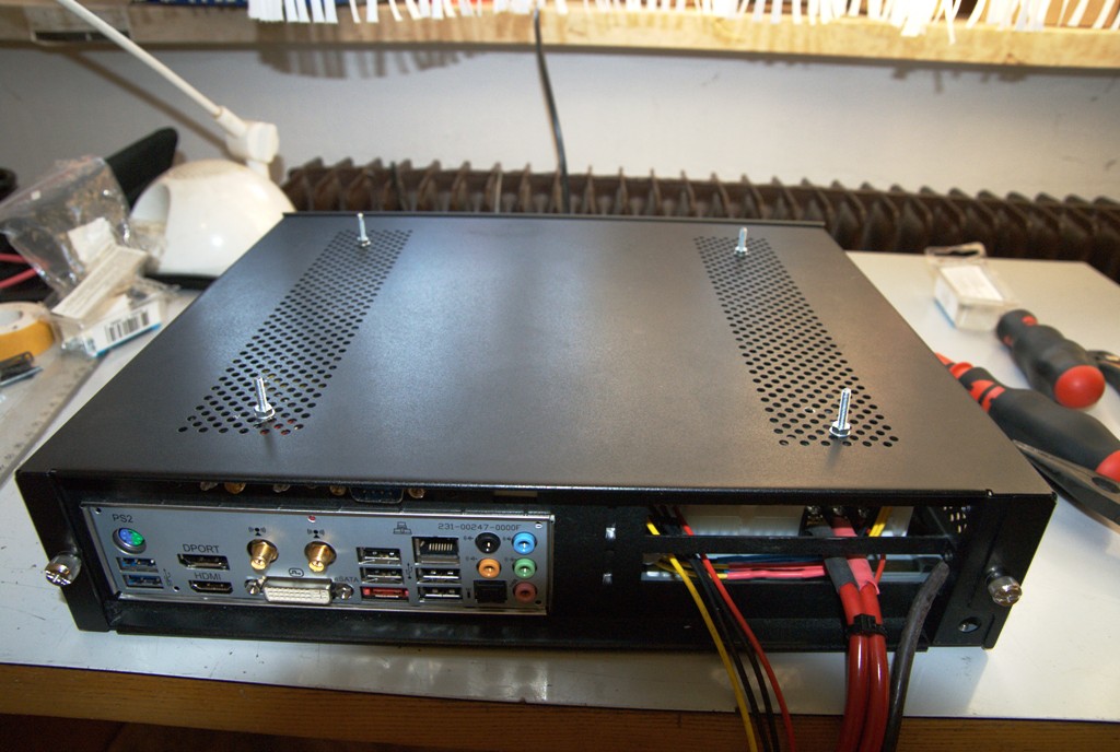

Closed case:

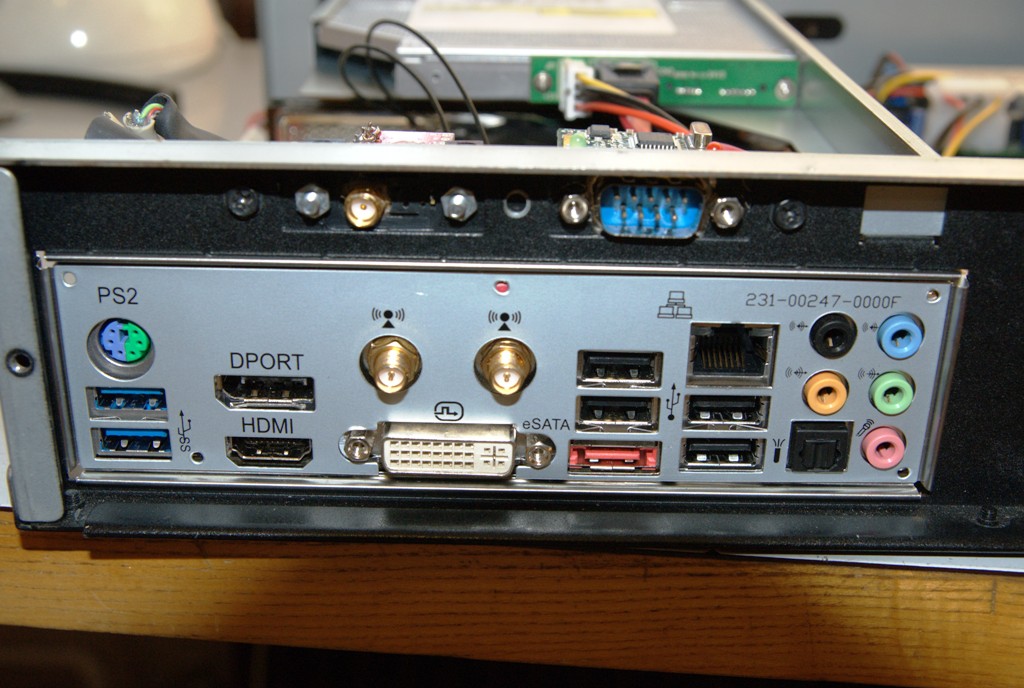

All connectors which I need it(Wifi, GPS, USB2, USB3, eSATA, optical audio out, CAN, Video...) are here:
And mounted case:

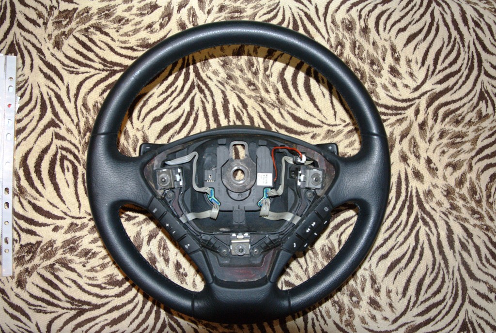

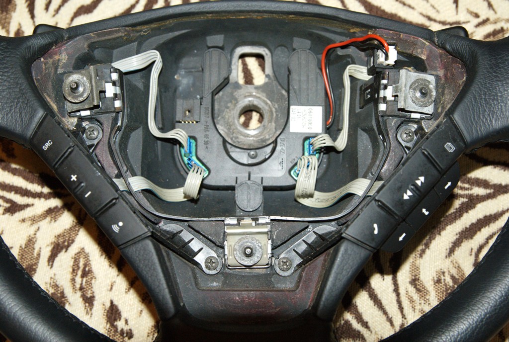

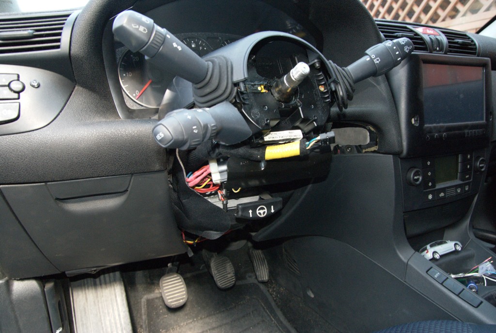

What to replace? Tomorrow I will replace the steering wheel with a new multifunction steering wheel...

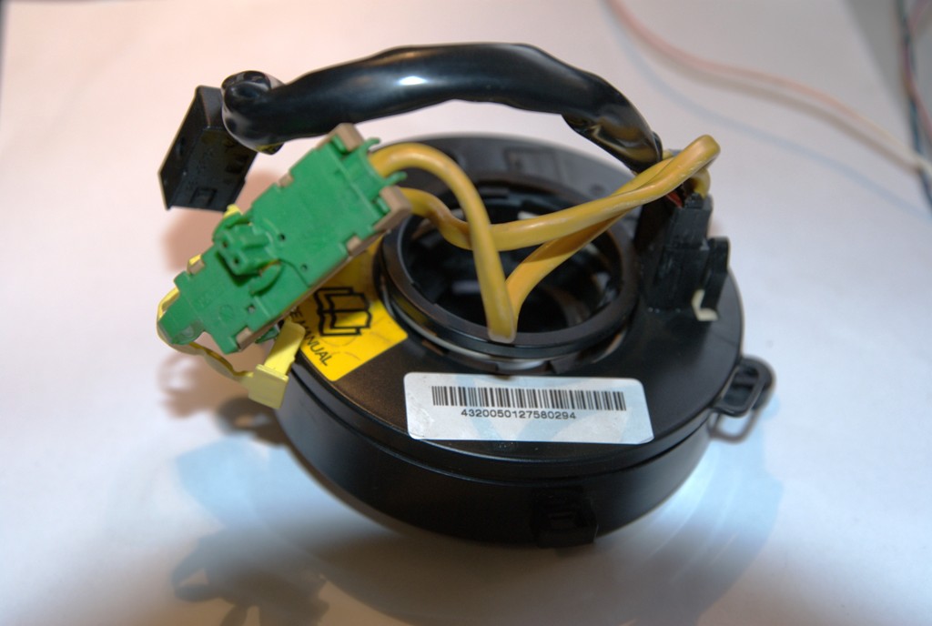

First Im find a new spiral cable because the original is missing three contacts:
Steering wheel:
The new steering wheel seems to have enough buttons to operate the new digital dashboard //content.invisioncic.com/y282845/emoticons/smile.gif.1ebc41e1811405b213edfc4622c41e27.gif//content.invisioncic.com/y282845/emoticons/biggrin.gif.d71a5d36fcbab170f2364c9f2e3946cb.gif
Im install and connect new steering wheel ...

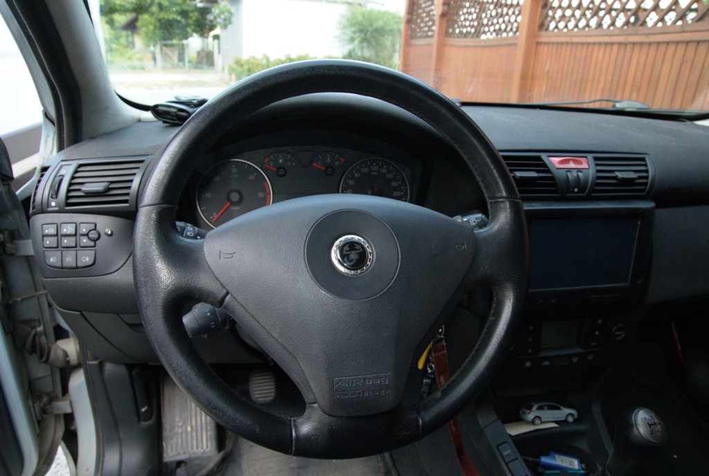

First one picture of the original steering wheel:

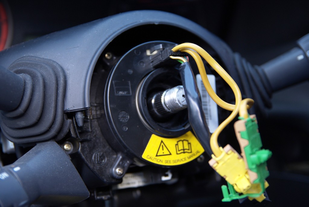

Removed the original steering wheel and a spiral cable:

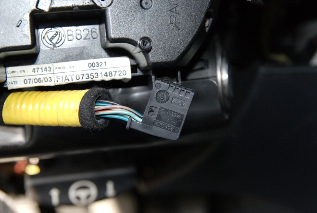

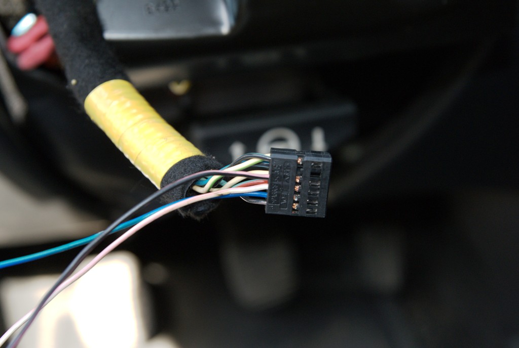

In the connector is necessary to add 3 new cables CAN A, CAN B and lighting:
New spiral cable is installed:

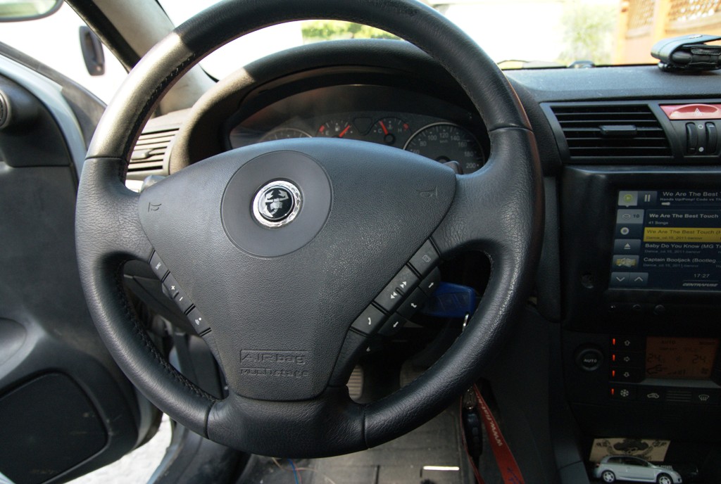

Work is completed:
Today I will finish CAN plugin for Centrafuse and testing tomorrow if the controls operate normally and it will temporarily managed CarPC ...

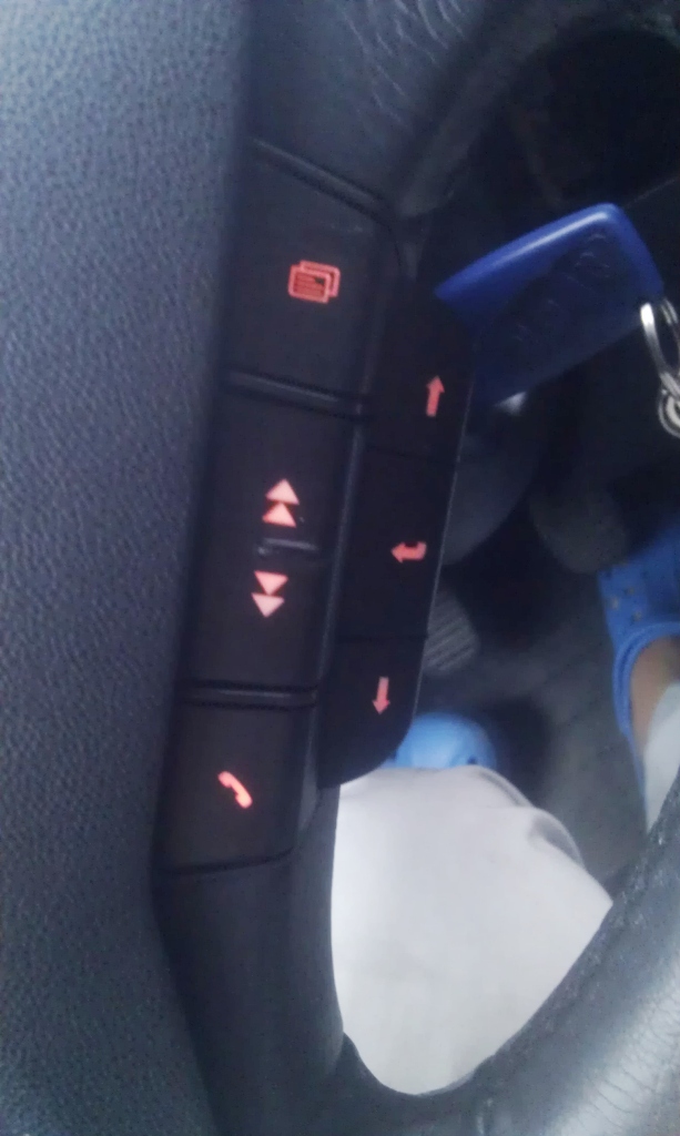

Illumination:
