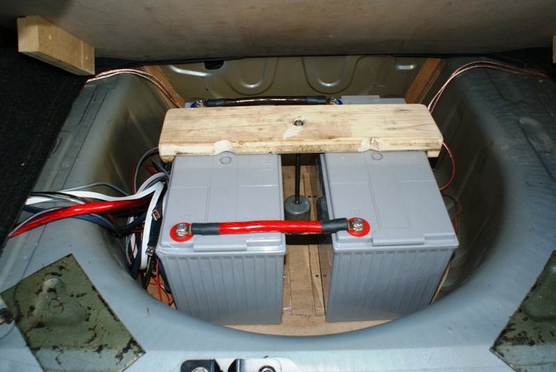

First Im connect batteries together:

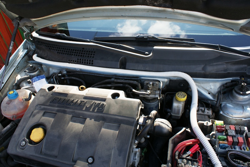

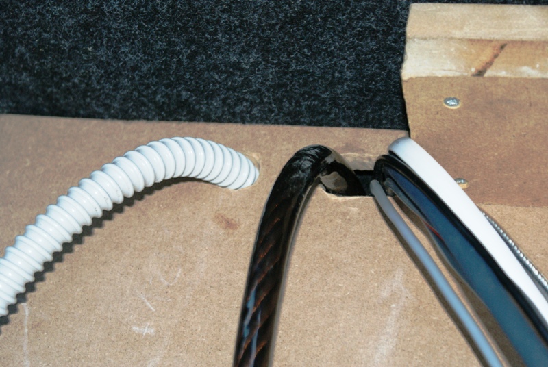

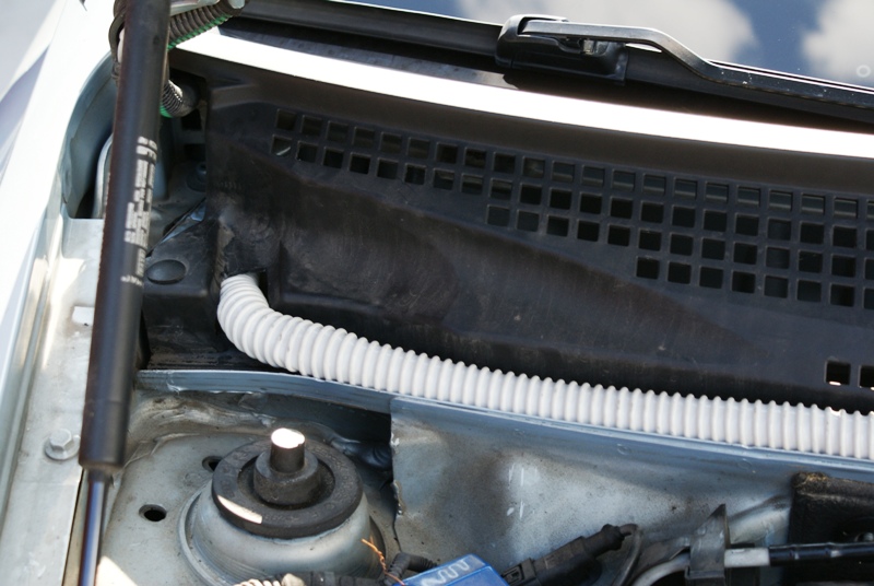

Then Im find place where will have power cable in engine place...
I must fix it that cable can't move...

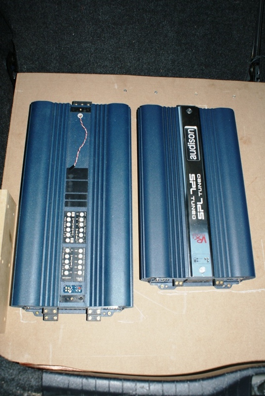

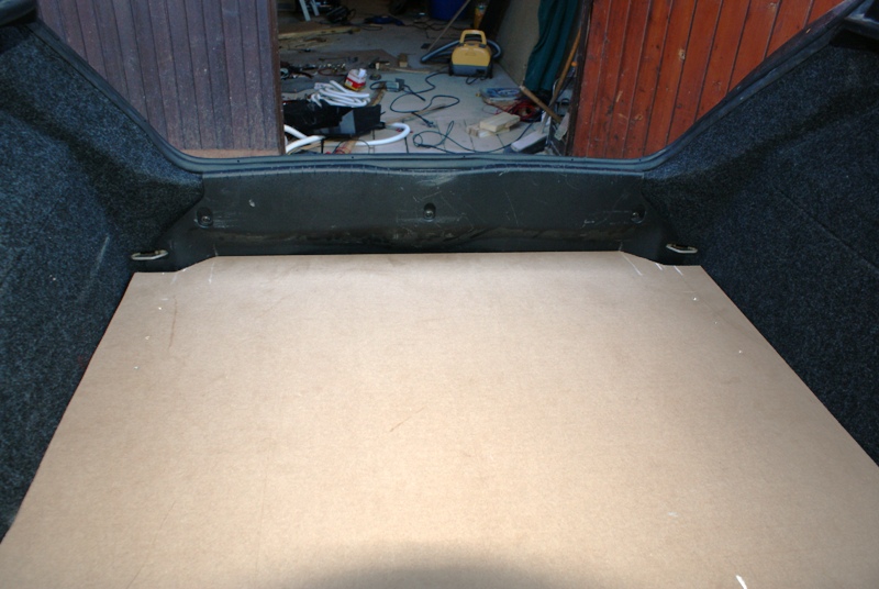

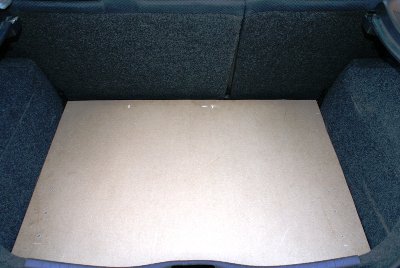

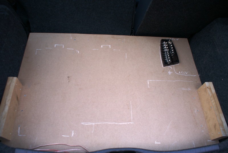

Im make plate where will be mounted amplifiers, carpc...

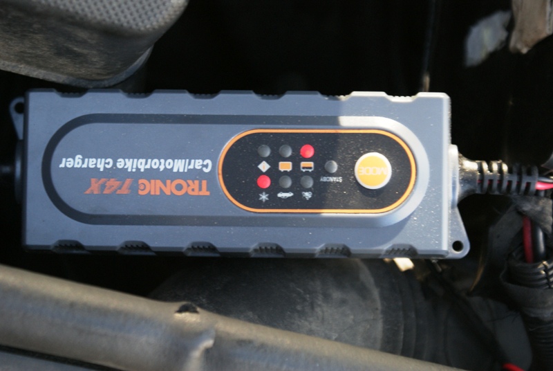

And battery charger(Copy of CTEK XS 3600)
What Im do today //content.invisioncic.com/y282845/emoticons/biggrin.gif.d71a5d36fcbab170f2364c9f2e3946cb.gif

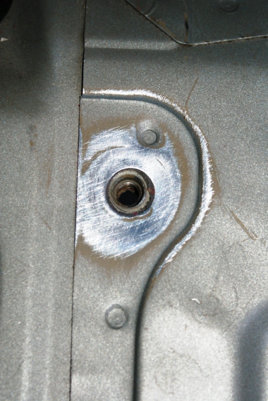

First ground...
Then marking positions...
Holes...

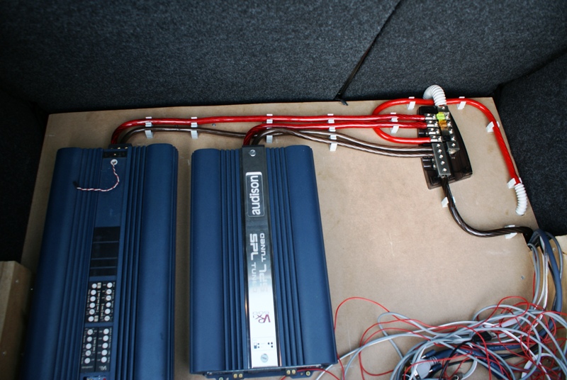

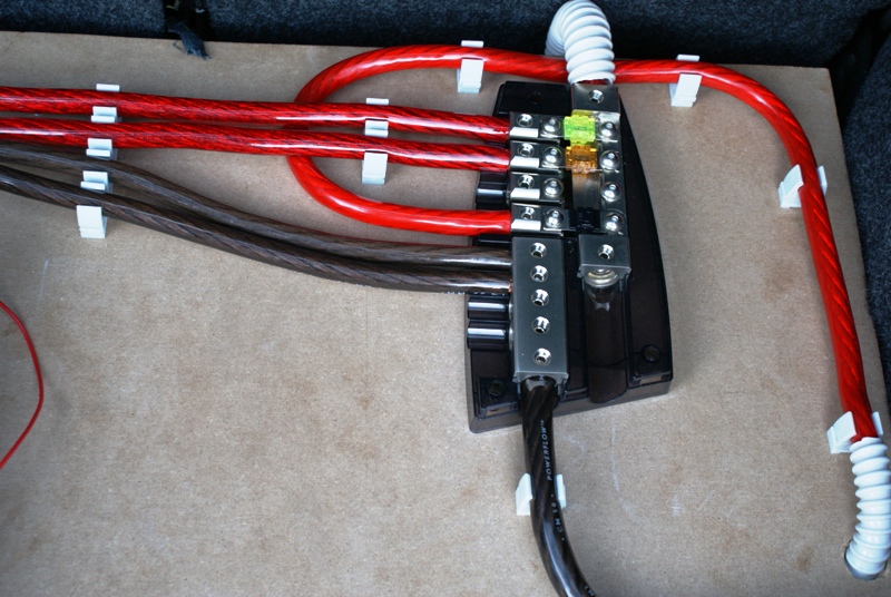

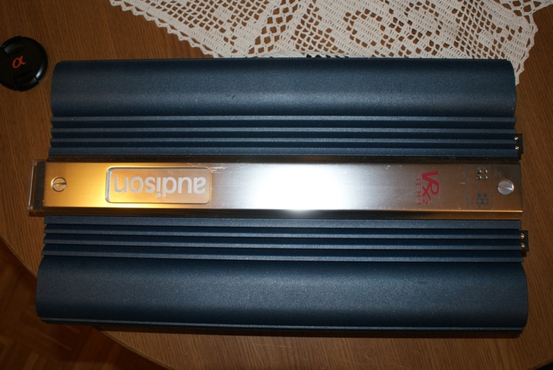

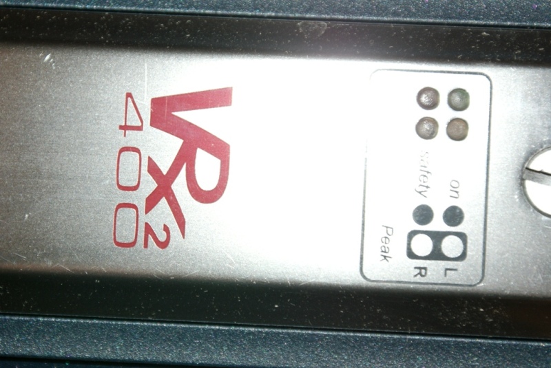

Amplifiers...

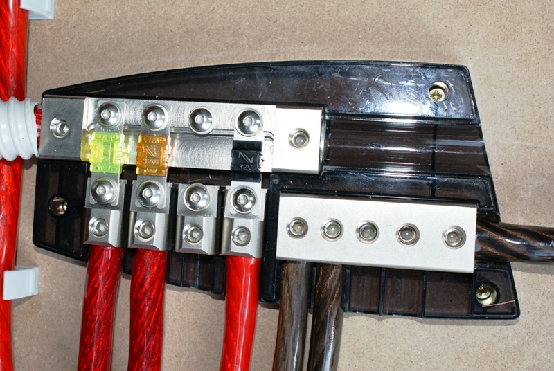

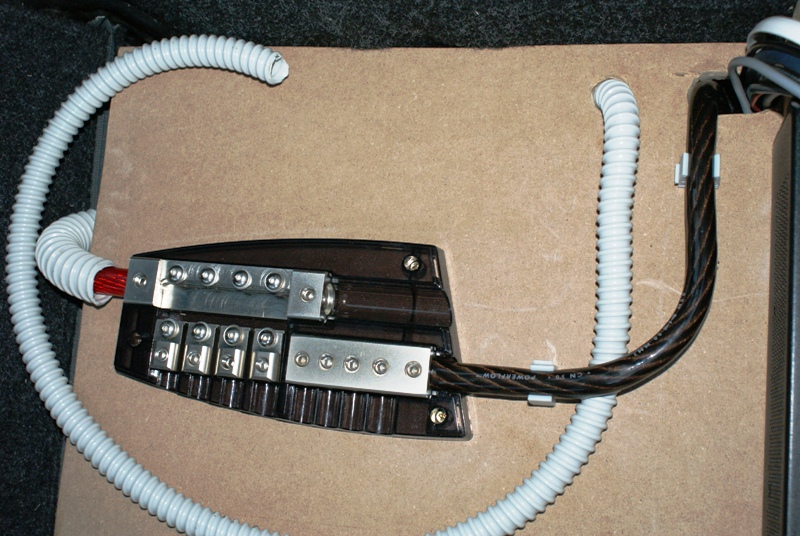

Power terminal...
Today my boot look like this:
Im turn on amplifiers and play trough phone because Im searching which cable go to which speaker(unmarkedcables.press)...

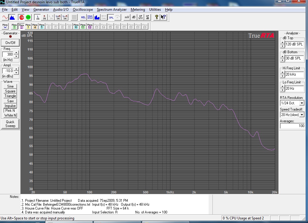

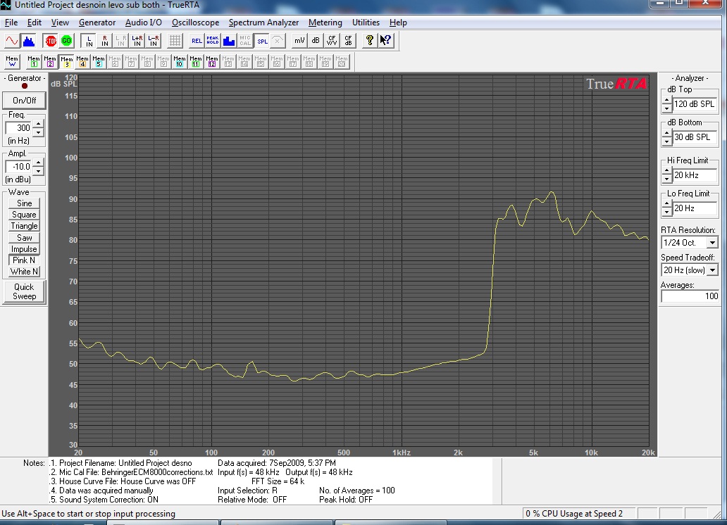

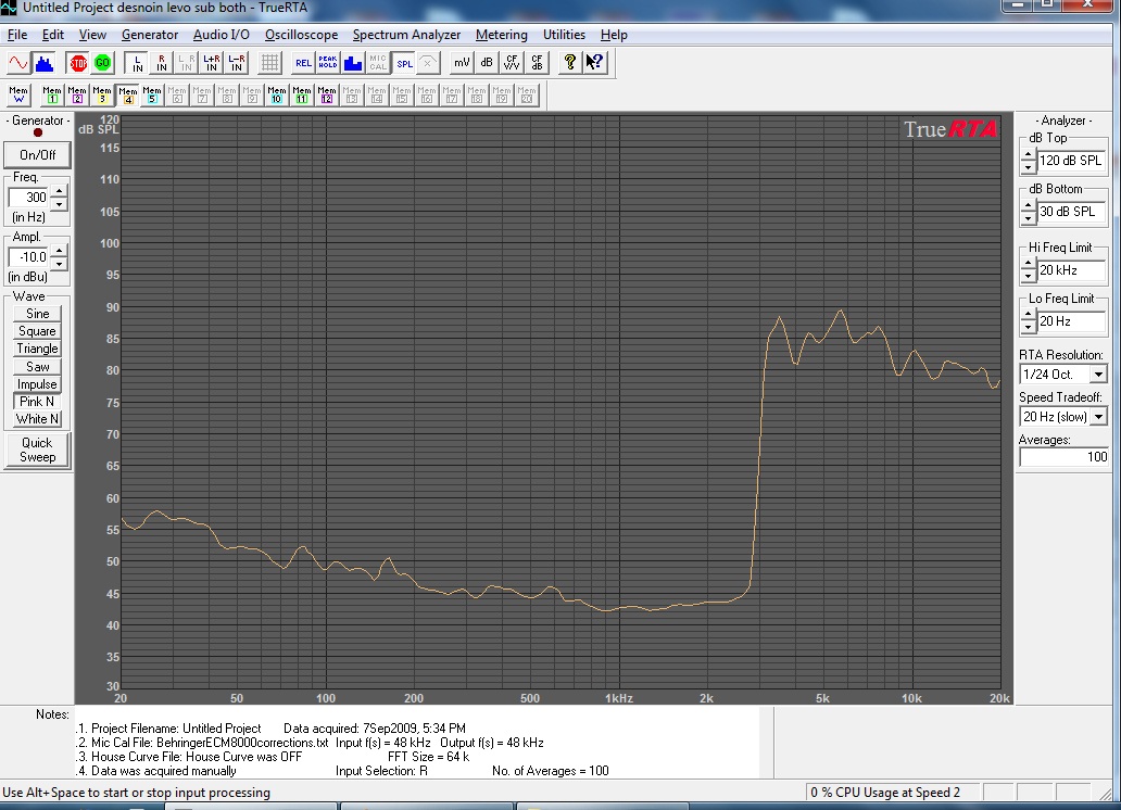

Today Im try mesaure my system with TrueRTA and get next results:

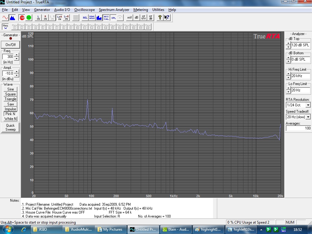

First mesaure noise in car:
Im not shure if dB is ok I think it must be cca. 10-20dB lower...
Then Im mesaure Left MID (Full Range):
And Right:
Tweeter(BugPass filter at 1.5kHz you can see slope)...
Left:
Right:
For first mesaure I think that results are ok, but I must check why sound go +/- 5dB...
In generator Im use "Pink Noise" and leave it 10sec. to make average. I think that with "Quick Sweep" has been signal more linear...

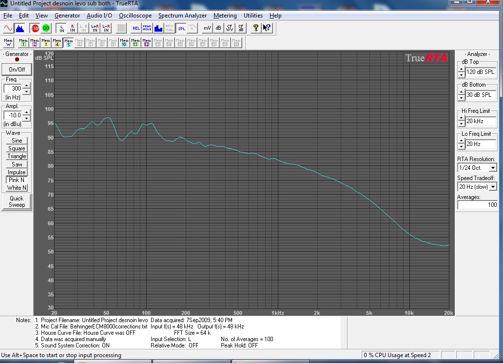

Today Im make new mesaures with less noise //content.invisioncic.com/y282845/emoticons/biggrin.gif.d71a5d36fcbab170f2364c9f2e3946cb.gif
In my previous post Im change pictures with new results(Except noise graph)... Here is few new results...

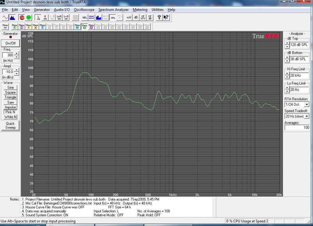

SUB (Full Range):

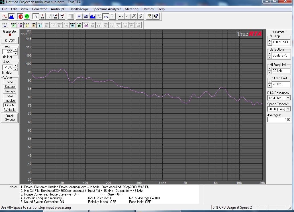

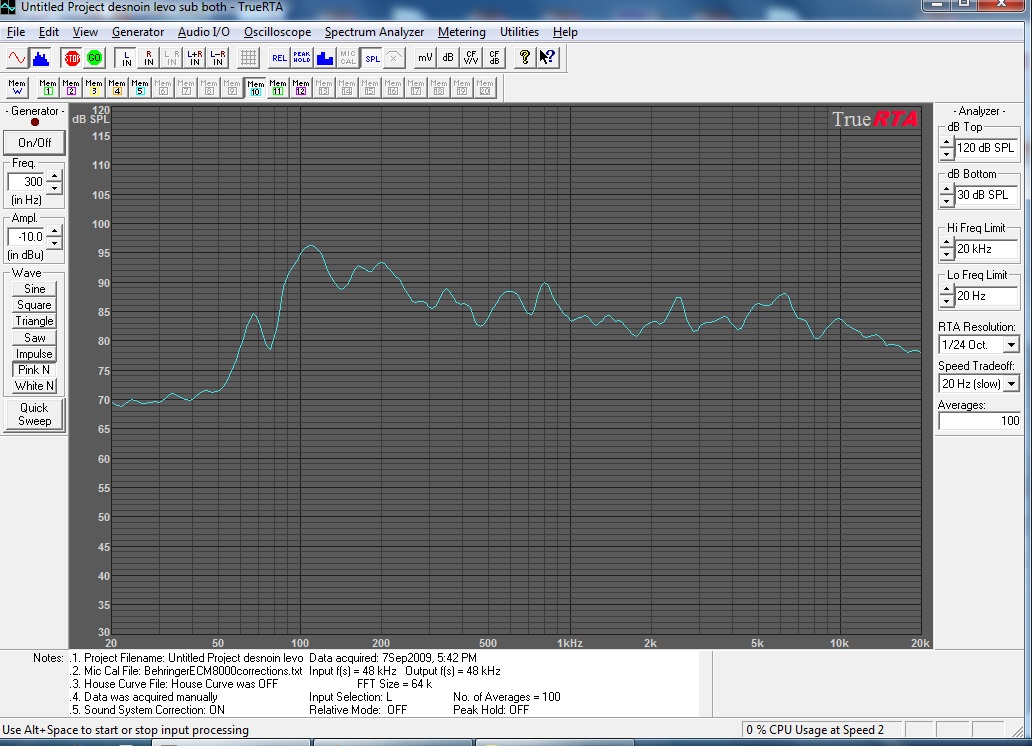

Left MID+TW(MID: 63Hz3kHz - BugPass TW: 3kHz - BugPass):
Right MID+TW(MID: 63Hz3kHz - BugPass TW: 3kHz - BugPass):

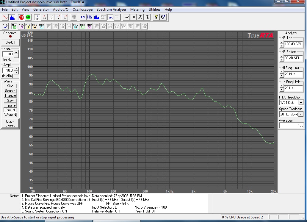

And all speakers together:
