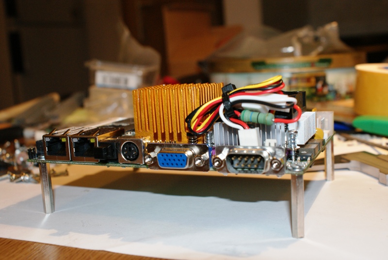

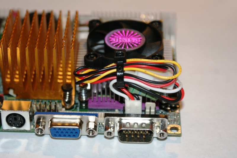

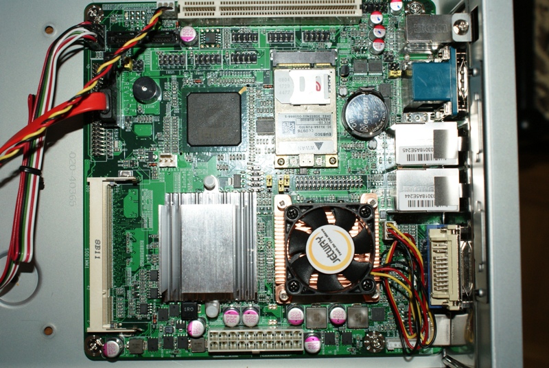

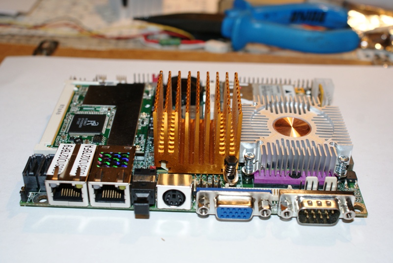

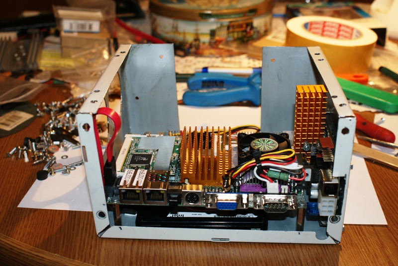

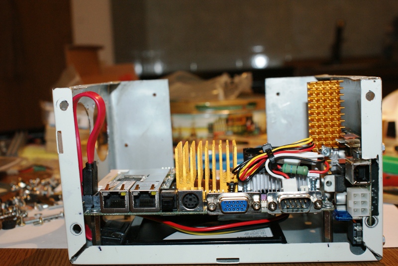

First Im change original chipset heatsink on motherboard:
Then Im change original FAN on CPU:

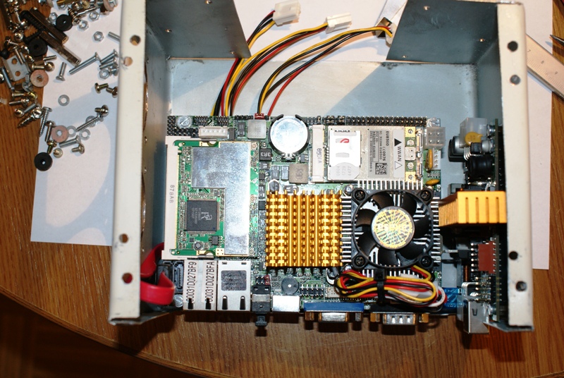

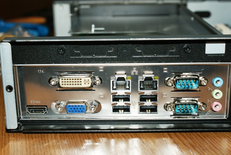

Motherboard prepared for installing into case:
Cables for SSD and DVD:

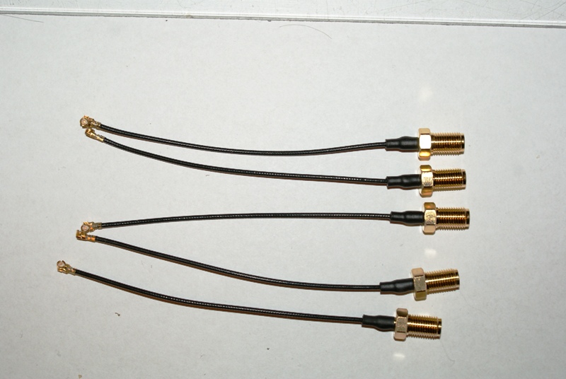

And connectors for Wireless and GPRS/UMTS/HSDPA/HSUPA card:

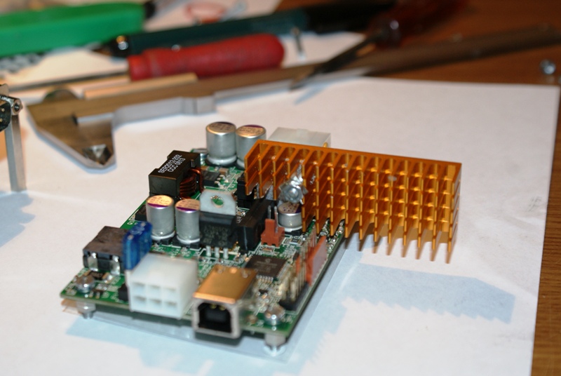

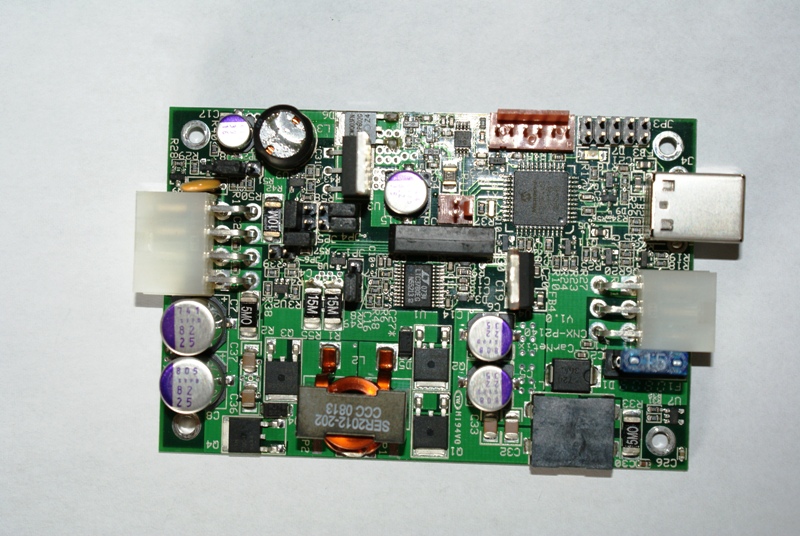

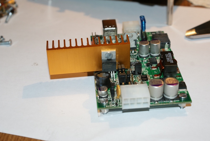

Then Im remove case and heatsink from power regulator Carnetix P2140:

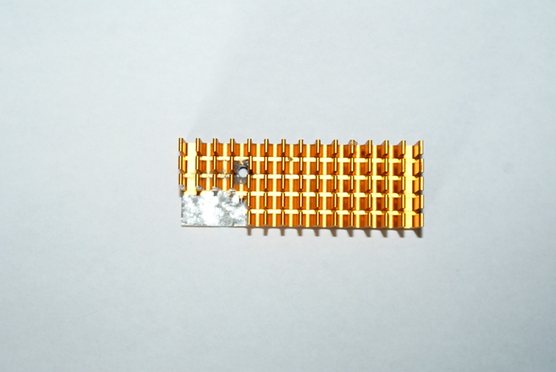

Im find one heatsink and Im little modify it:
And fitted into regulator:

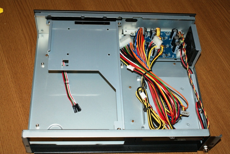

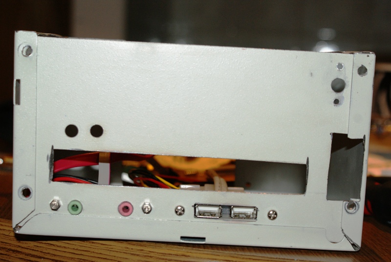

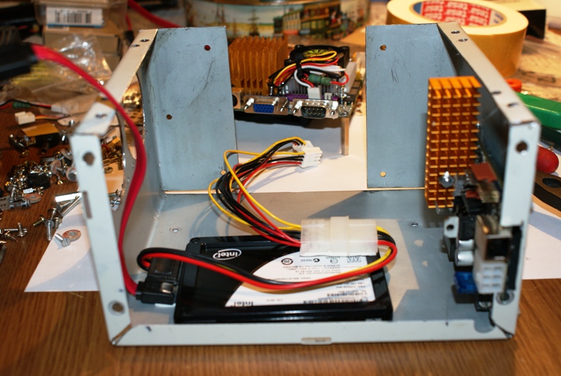

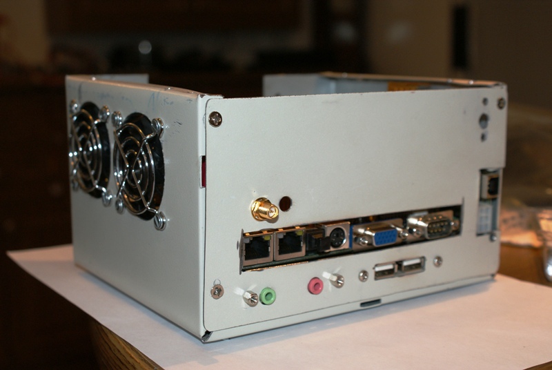

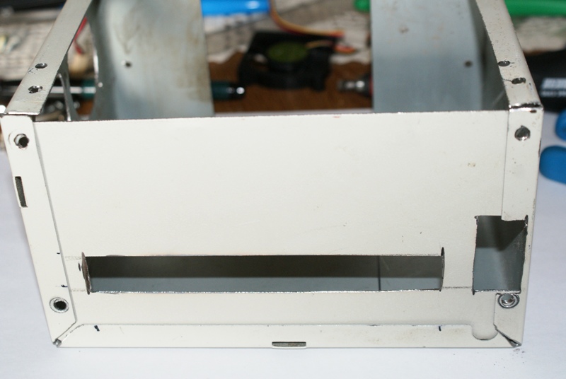

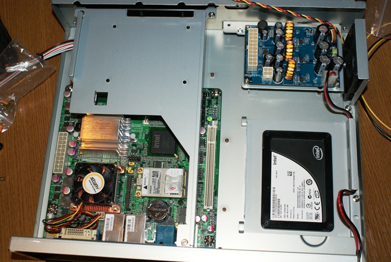

First Im continue building case:

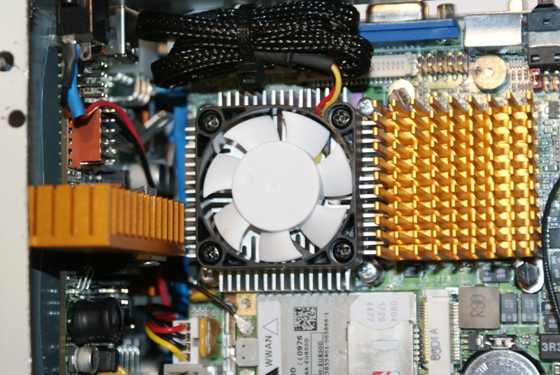

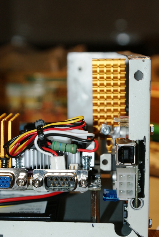

Im again change fan on CPU(and add resistor for lowering rpm):

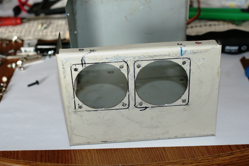

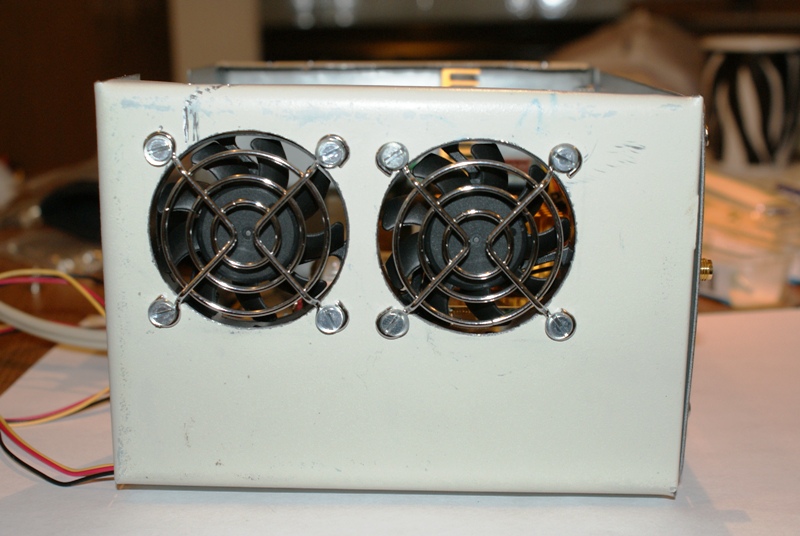

And 7x7cm FAN which will be on top side of case:

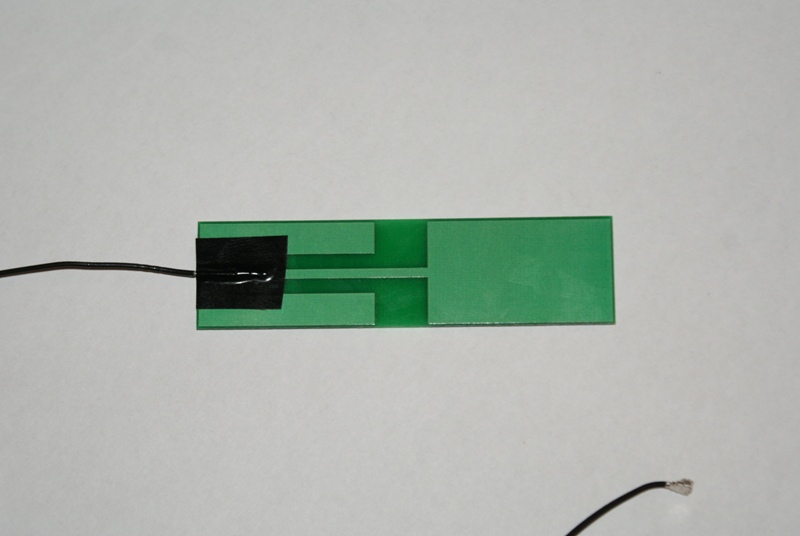

UMTS antena is ready to fix in case:

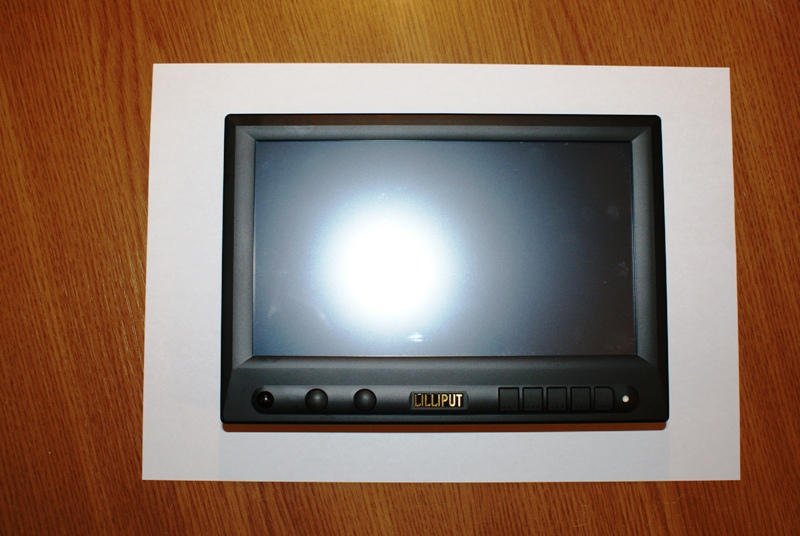

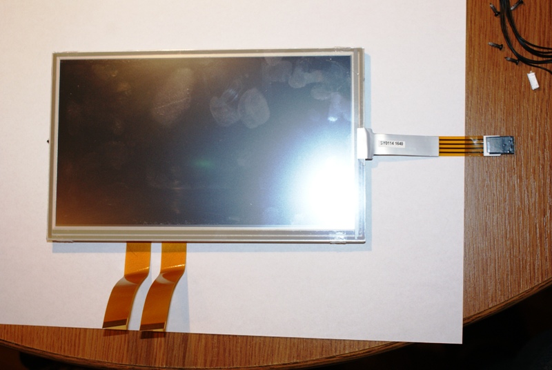

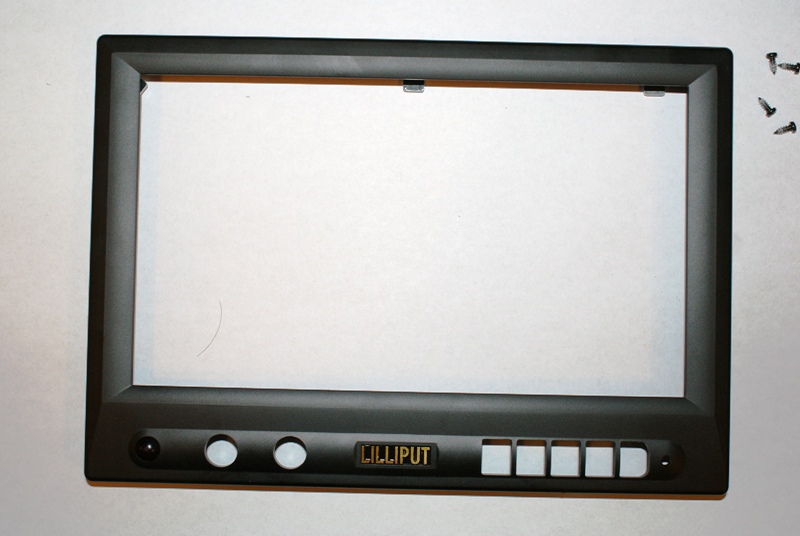

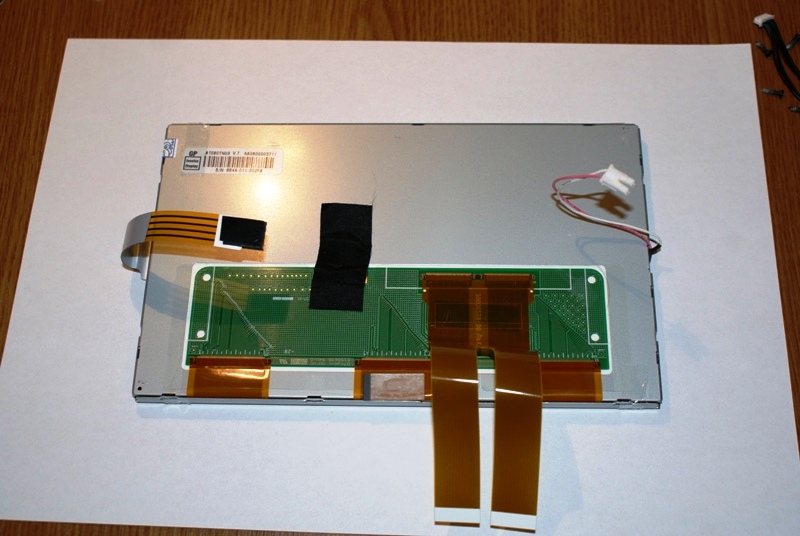

Im buy new LCD:

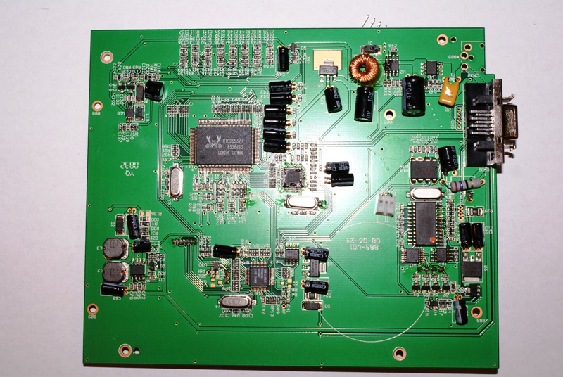

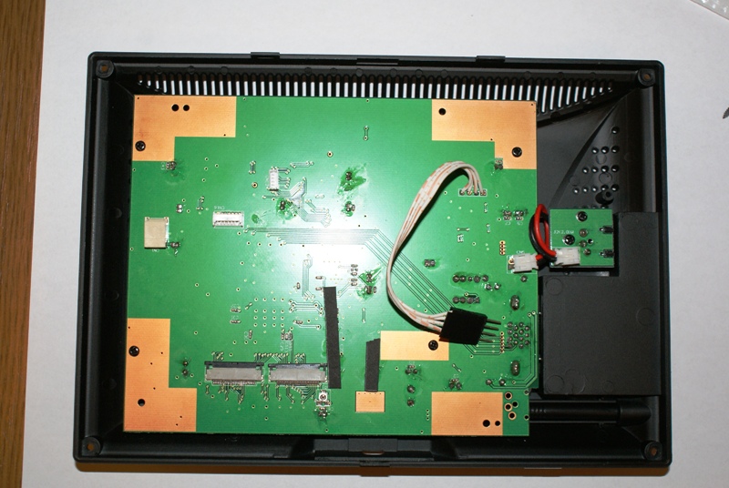

And Im open it:
Someone will have work with LCD bezel //content.invisioncic.com/y282845/emoticons/biggrin.gif.d71a5d36fcbab170f2364c9f2e3946cb.gif
And some part's of LCD:

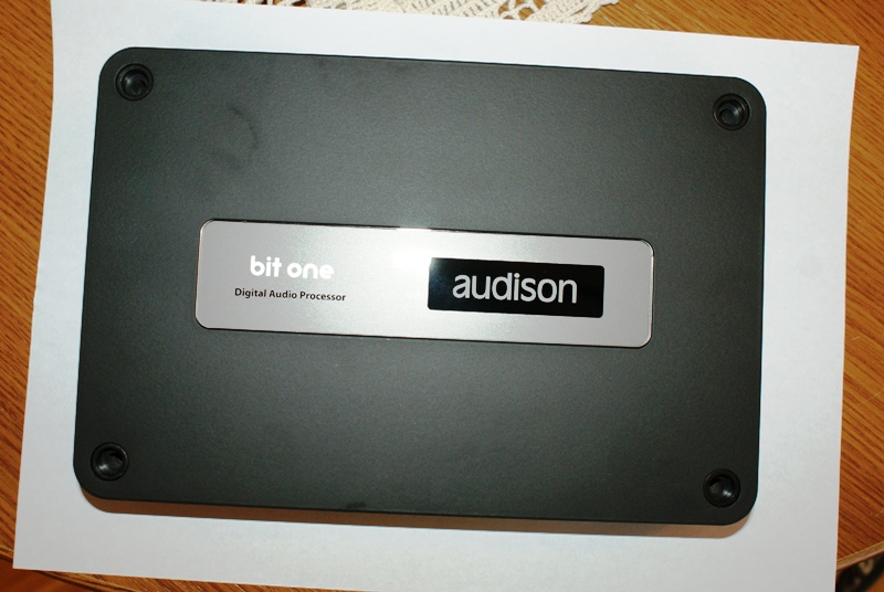

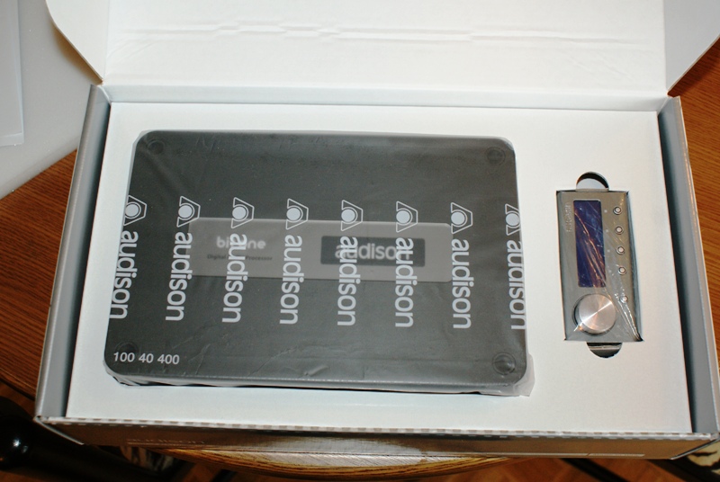

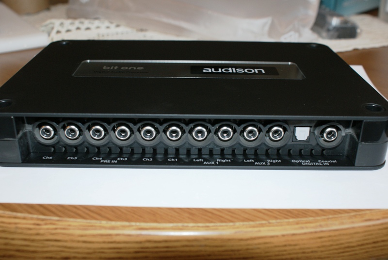

Im receive one toy //content.invisioncic.com/y282845/emoticons/biggrin.gif.d71a5d36fcbab170f2364c9f2e3946cb.gif Hmmm what is this?
Let's open case. Radio? Nooo...
Amplifier? Nooo...

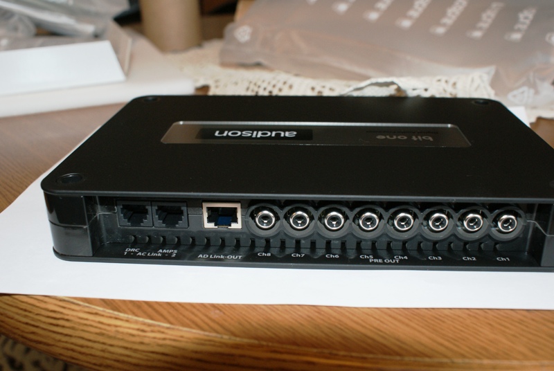

What the hell is this? This is new audio processor Audison Bit One //content.invisioncic.com/y282845/emoticons/smile.gif.1ebc41e1811405b213edfc4622c41e27.gif
How it look:

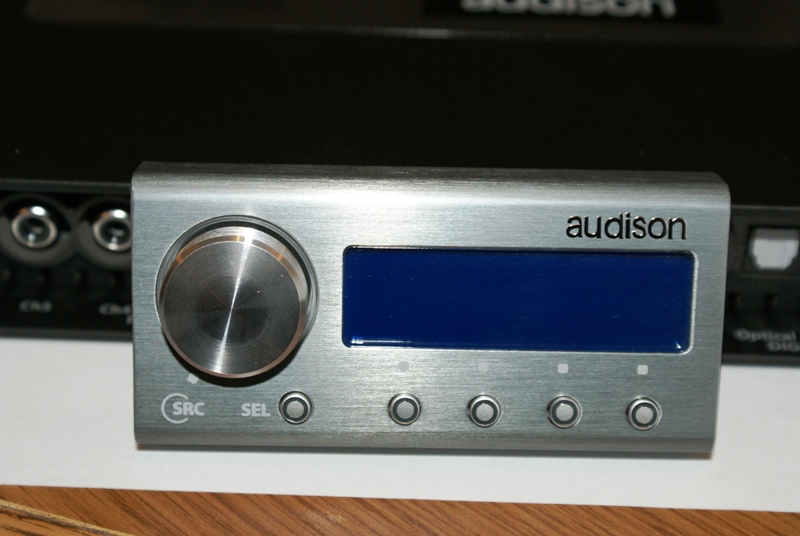

And DRC (Digital Remote Control) for it:

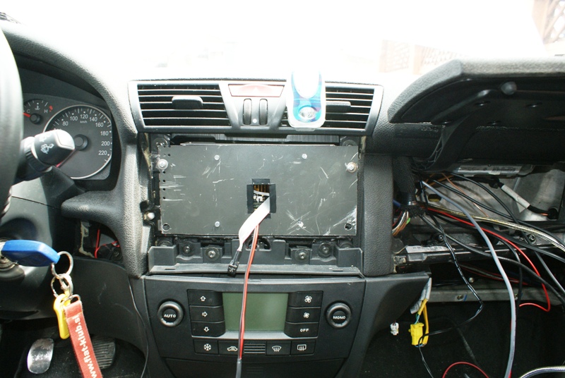

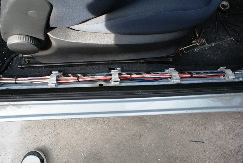

First Im little "edit" cables positions:

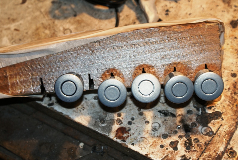

Then Im install PDC:
Connecting all together:

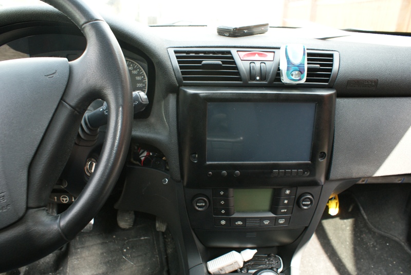

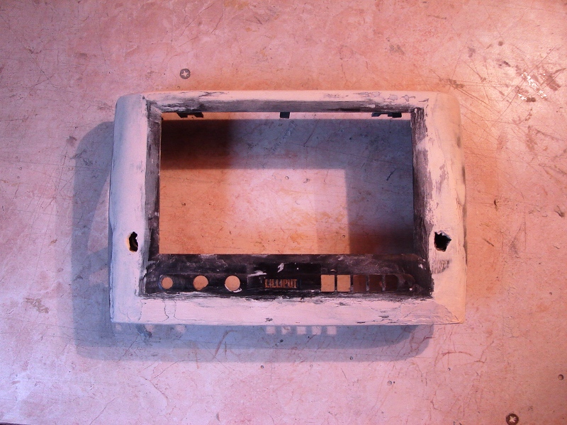

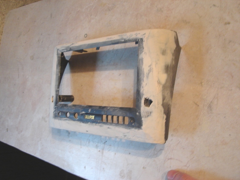

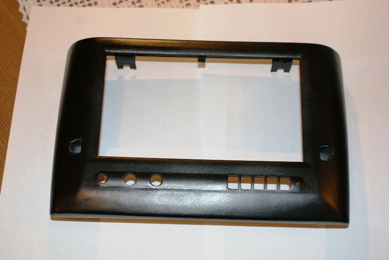

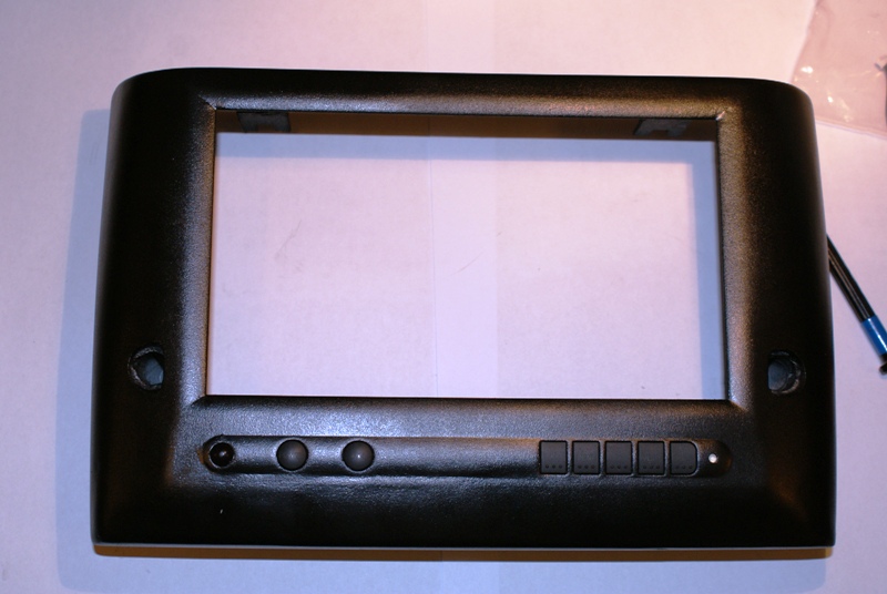

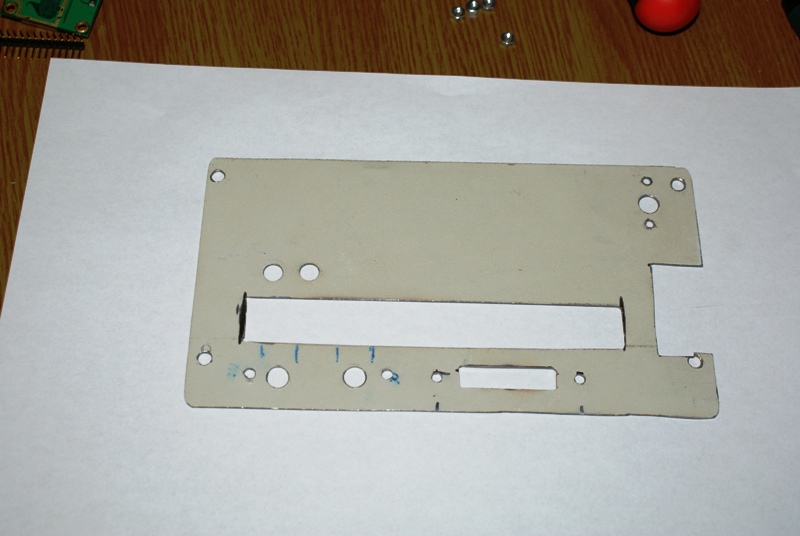

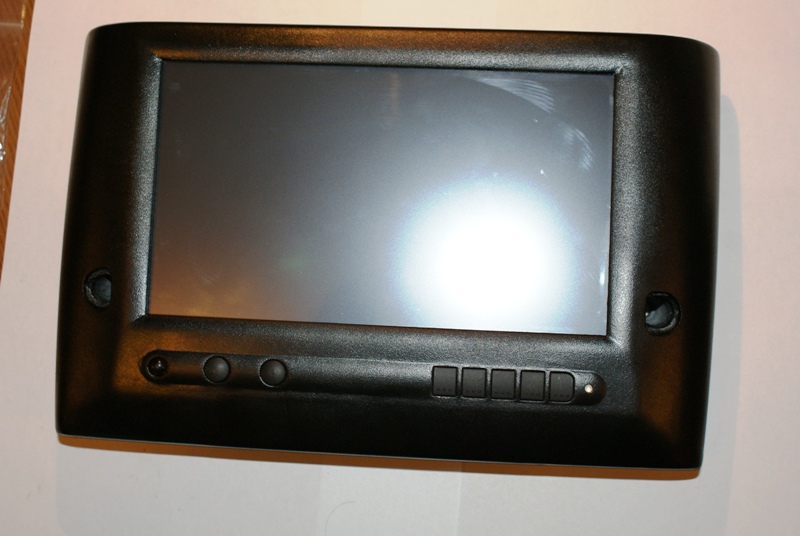

Friend is complete my LCD bezel and Im put all together:
Test CarPC Install(working ok but next week I must install GPS module):

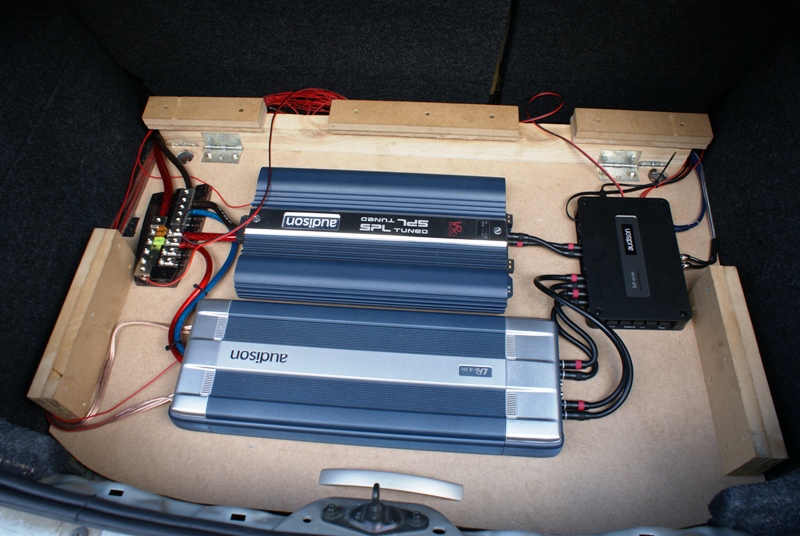

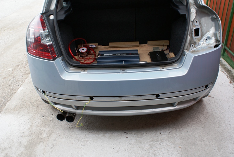

Little update in my car //content.invisioncic.com/y282845/emoticons/biggrin.gif.d71a5d36fcbab170f2364c9f2e3946cb.gif

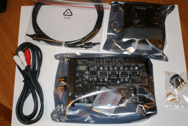

What is new? Im decide that I will make one step closer to SQ system...
Audison LRx 4.1k will not be anymore in my car and will be replaced with VRx4.300 and later will add VRx2.150.

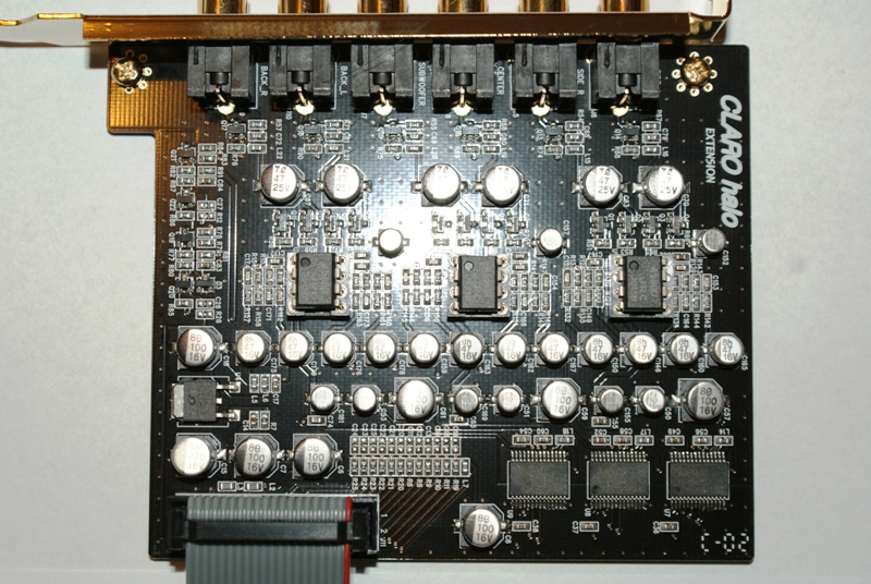

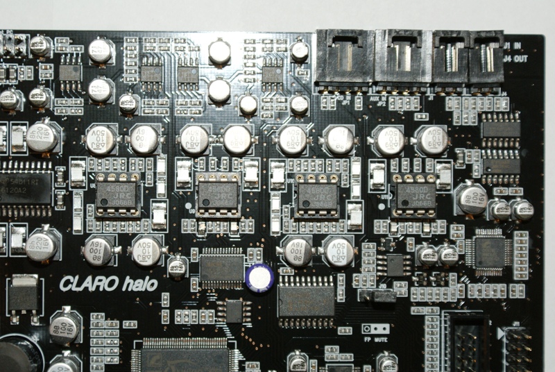

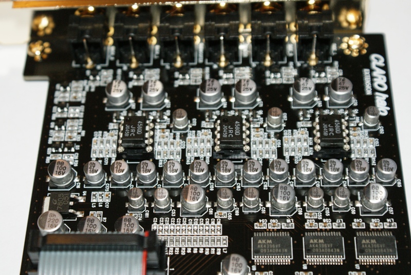

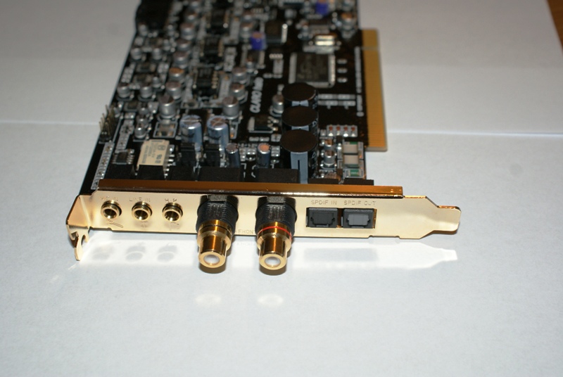

Onboard soundcard will be replaced with other one(All in right time)...
BitOne will not be anymore in my car(I think)...

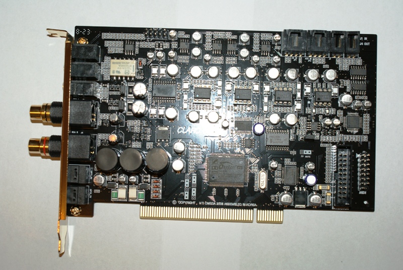

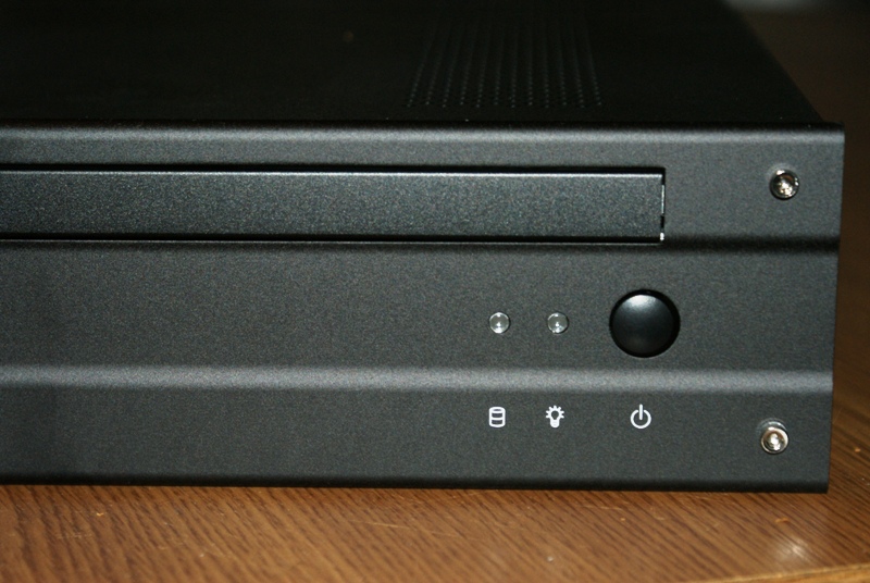

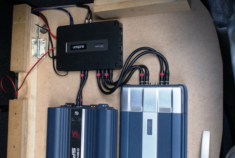

Few photos of new system:
Case have two PCI slots and sound card need two slot so is right choise
