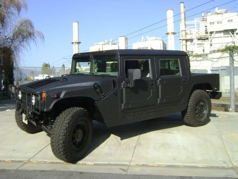

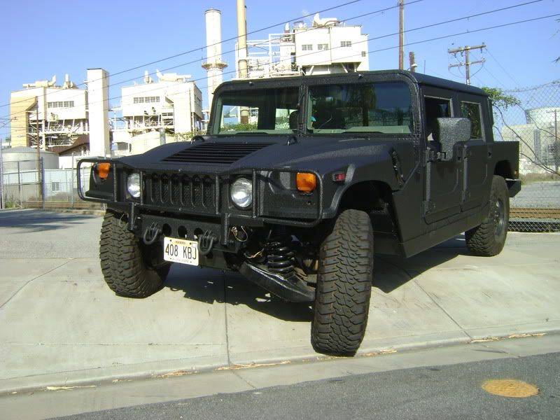

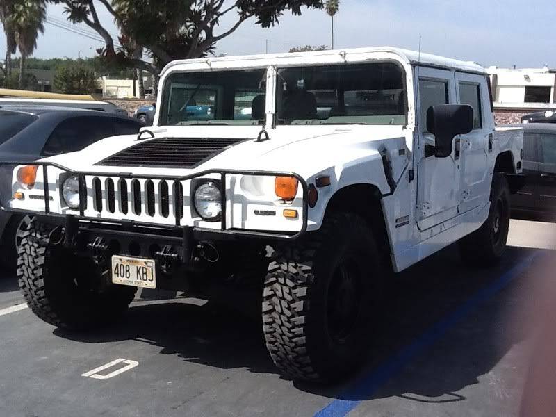

This is my friend's HUMMER that lives in Oahu. He shipped it over to have some work done.

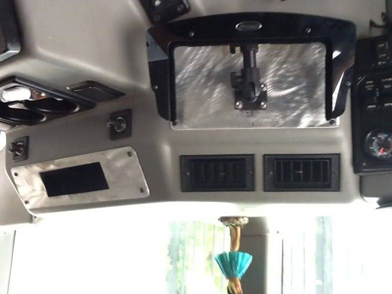

iPad Padholder

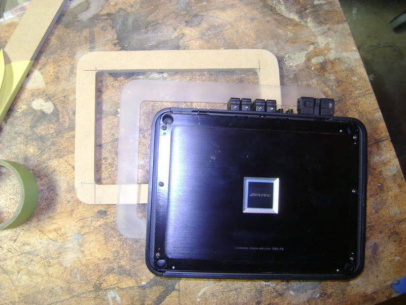

ALPINE PDX-F6
ALPINE PDX-M12

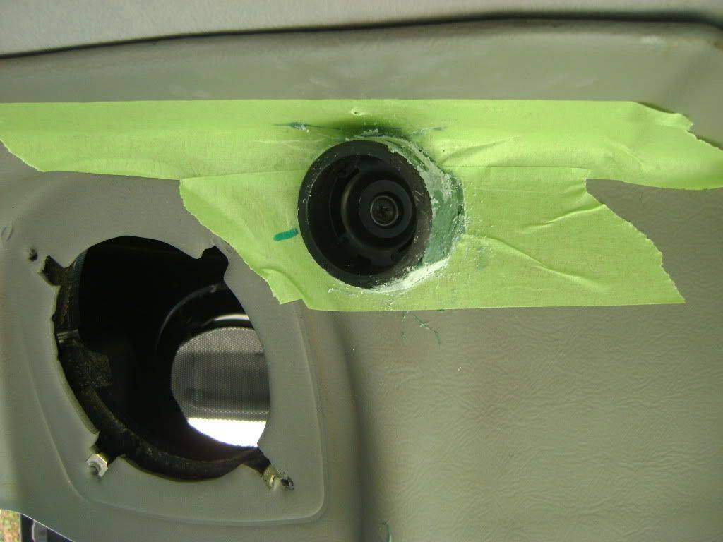

PAC rearview camera
Rear view mirror monitor

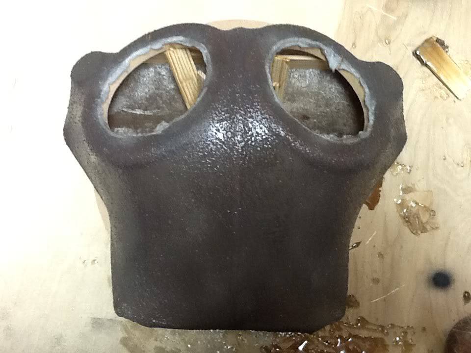

Exterior-Full Rhino Coat
OC Rhino

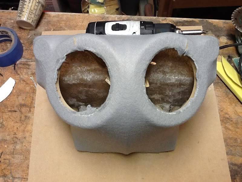

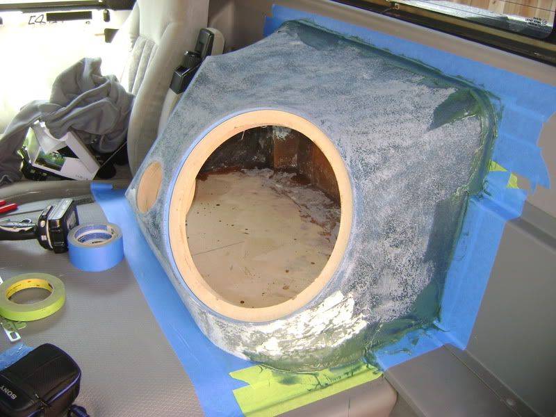

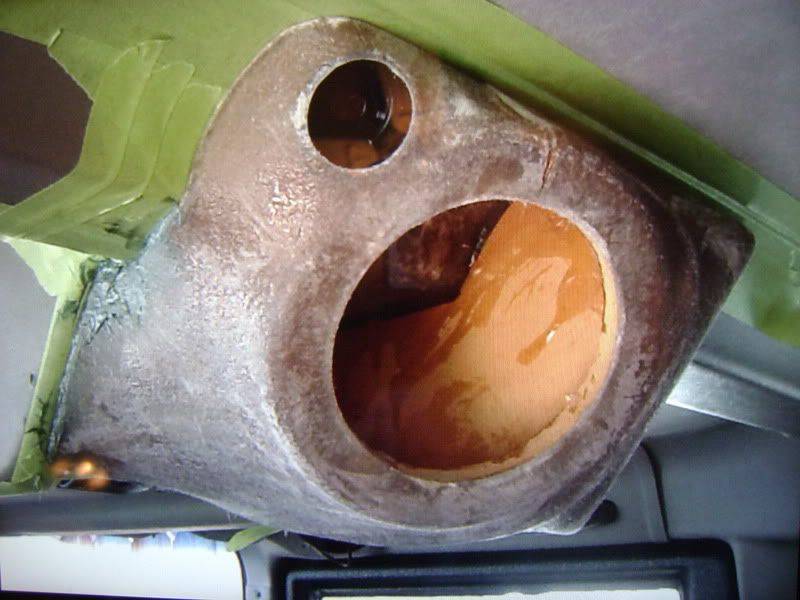

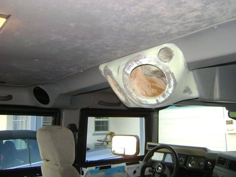

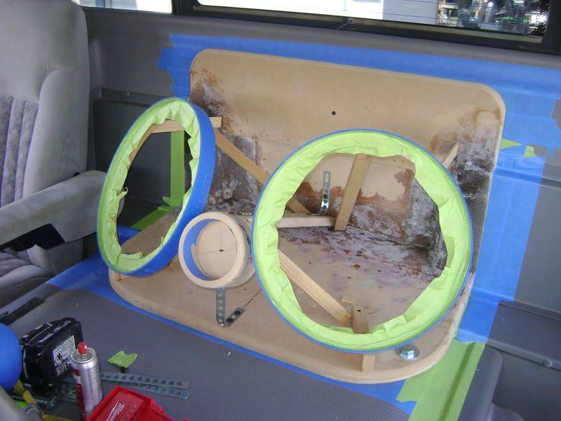

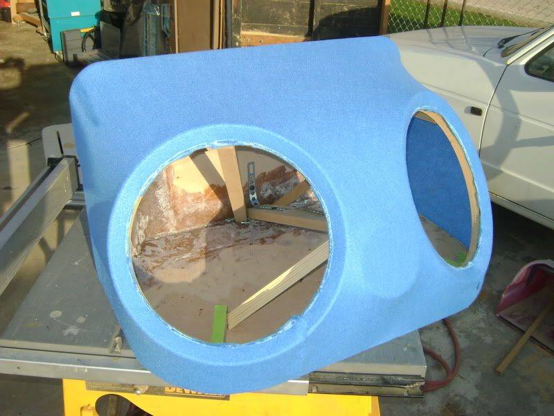

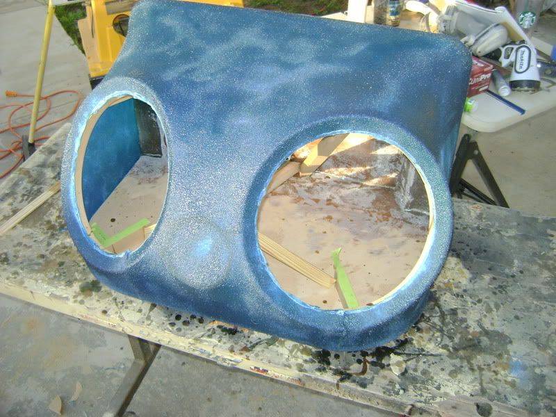

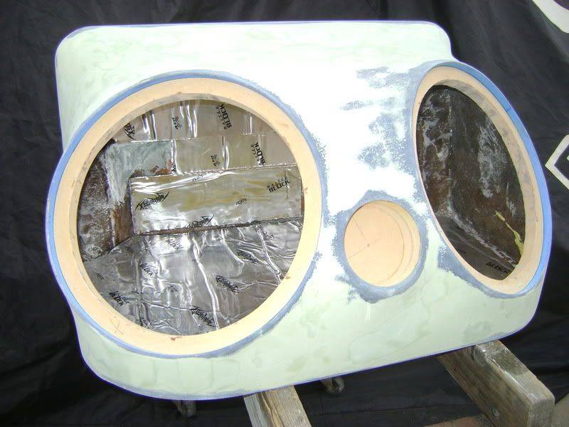

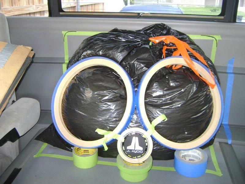

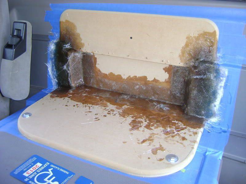

Sub enclosure measured with bean bag balls to 2.39cuft

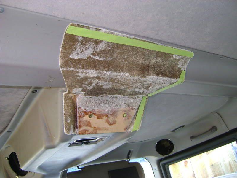

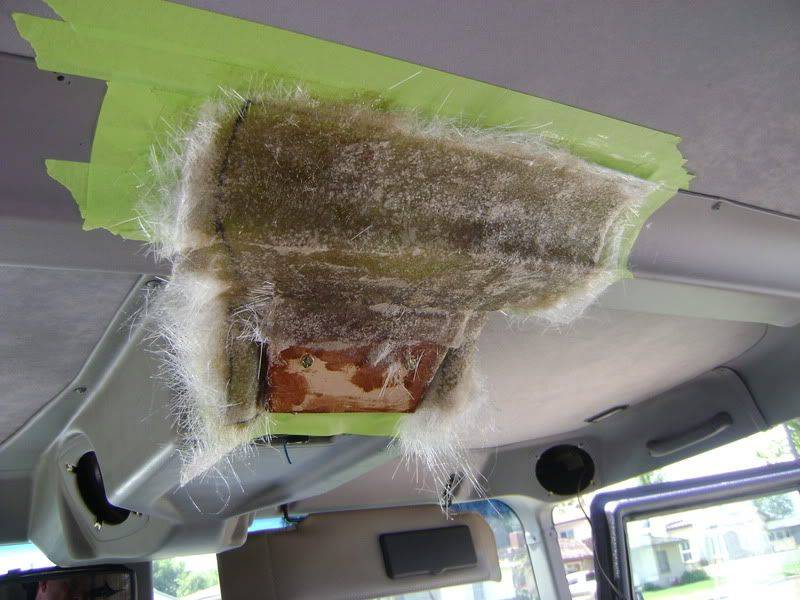

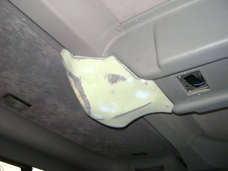

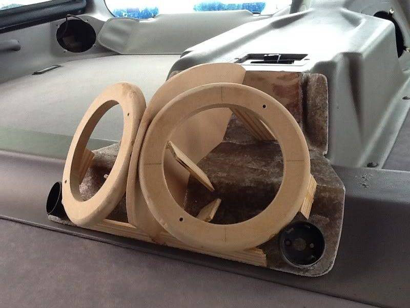

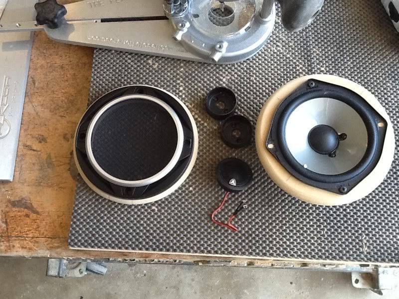

Flush mount speaker rings and holder for JL logo mocked up, felt stretched, resined, and layered up on the inside.
looks like its gonna be a fun Hummer, i like the rhino line idea that must protect you from all sorts of scratches, also acts like a sound deadener i would assume
