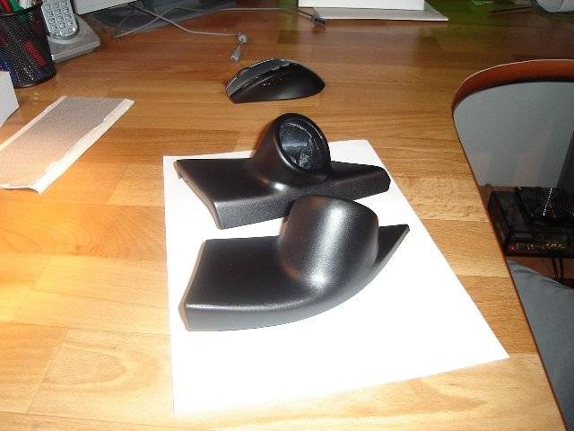

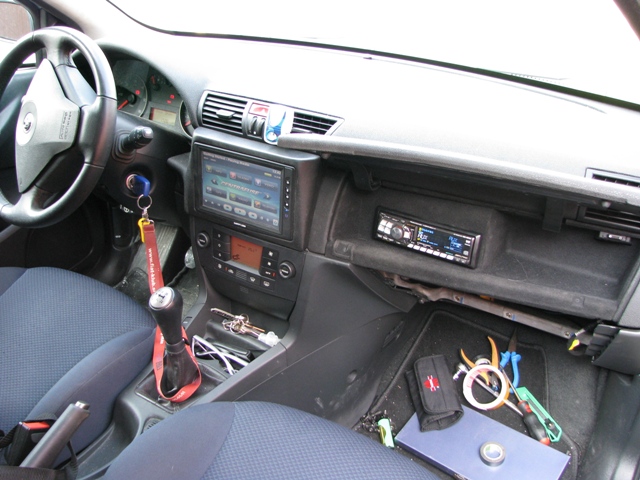

Bass is not so extreme/loud but on r'n'b go low and you can feel vibrations... This CarPc(trim panel) is in car so tight(Because is noot a lot of space) and I think now when Im connect subs are start cracking...

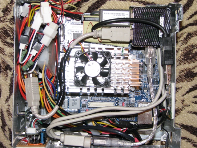

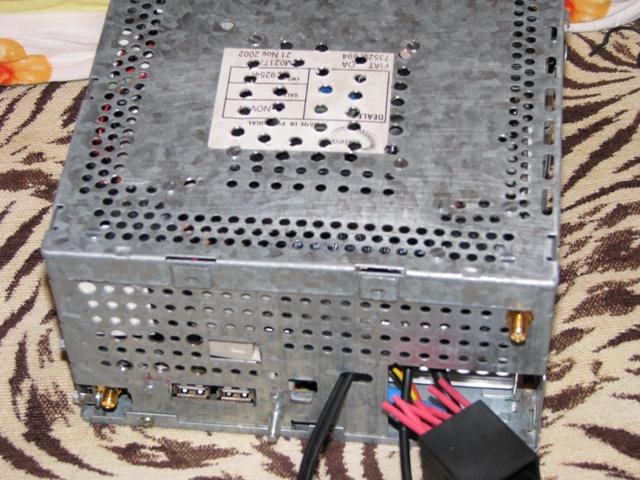

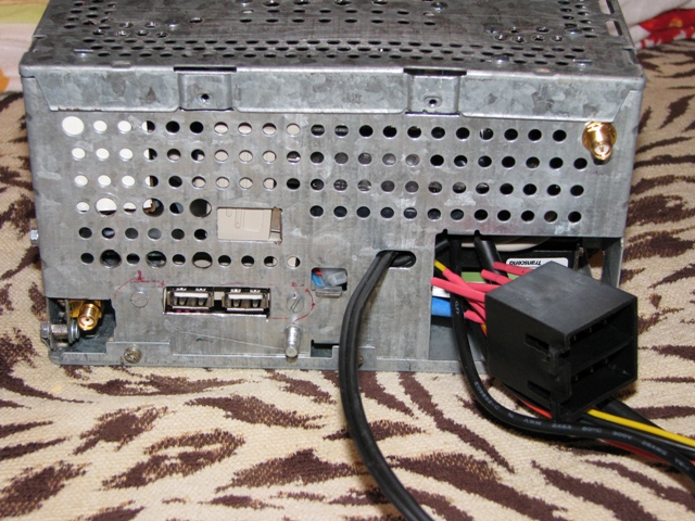

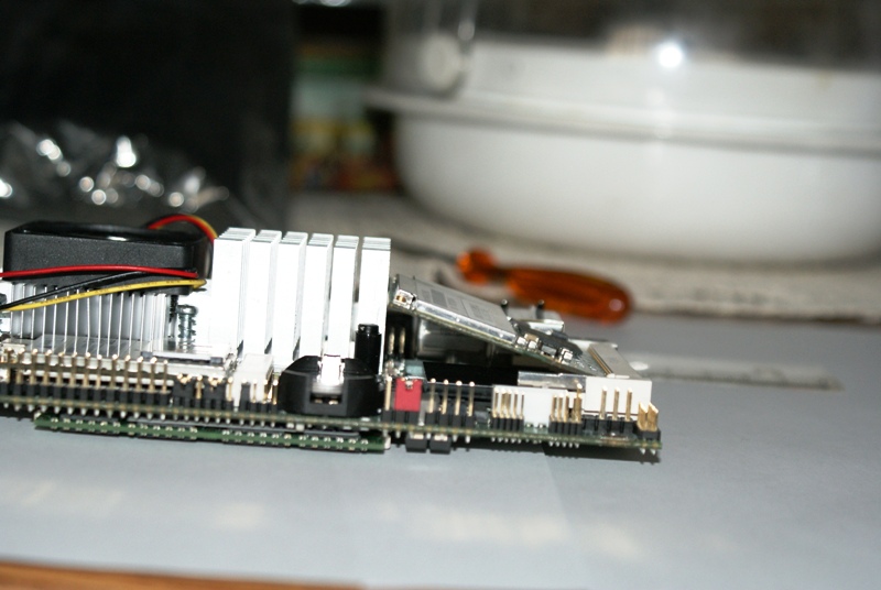

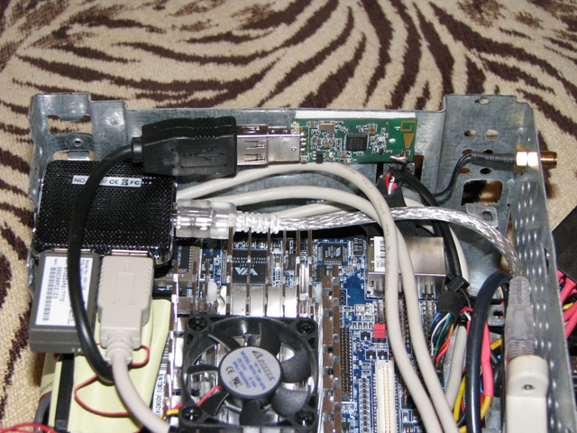

Few modification on case:

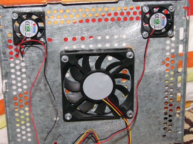

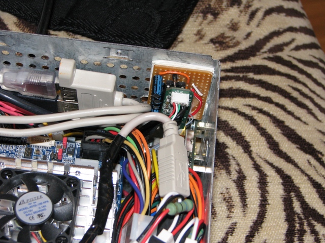

Im add Wireless card, build new USB->TTL converter for GPS modul, add few Fans, and add/change few components.

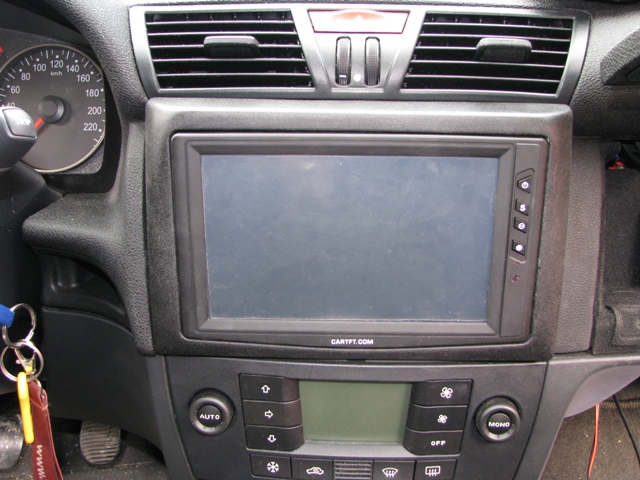

In car:

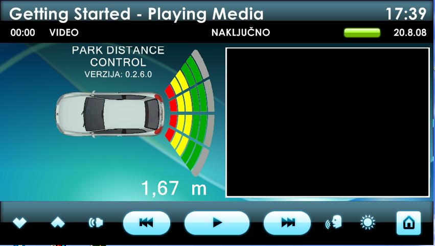

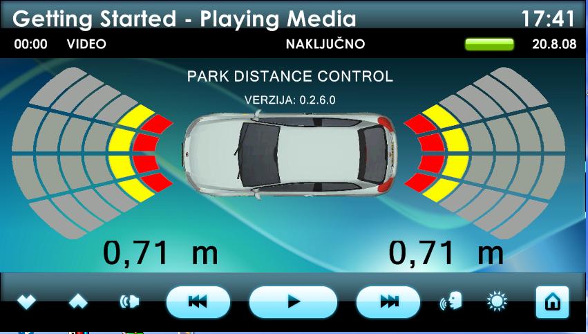

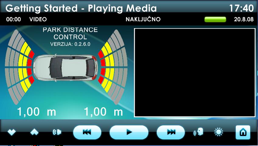

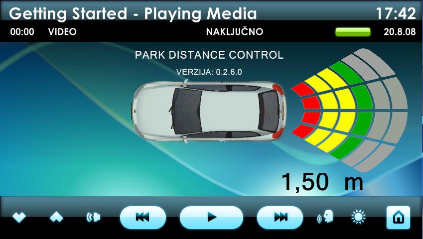

USB PDC - Parking distance system:
one quick movie how work this USB PDC:
Plugin for USB PDC is not finish yet, but we are working on it... Same is with plugin for power suply...

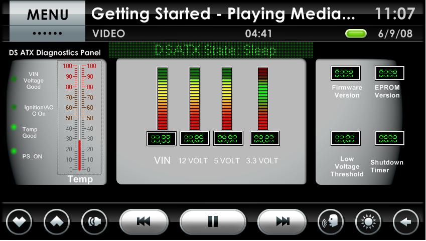

DSATX Plugin(Power suply):

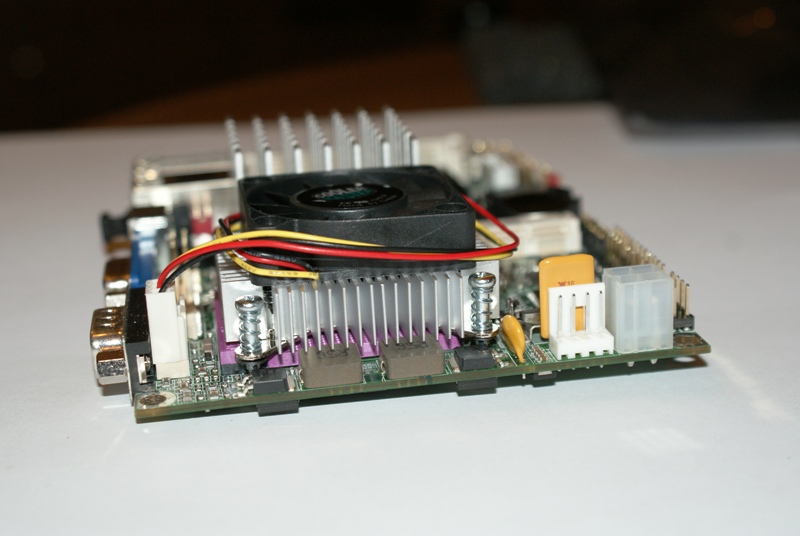

Here is few pictures of my new project:

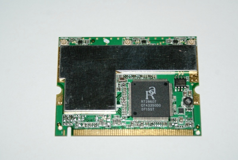

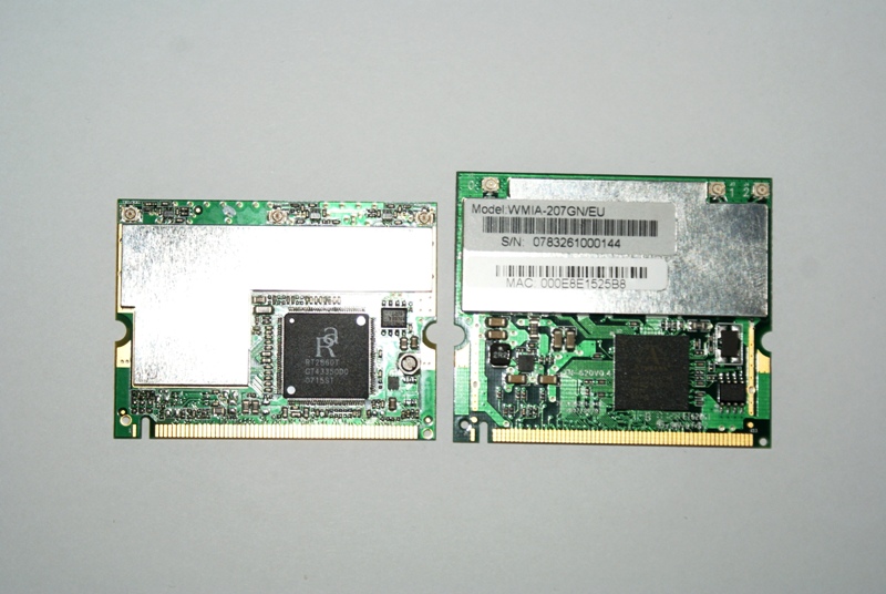

Mini PCI Wireless SparkLAN WMIA-207GN - wireless card which support n-draft standard(300MBps).

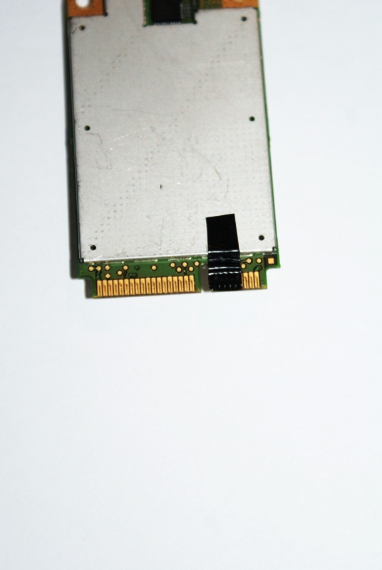

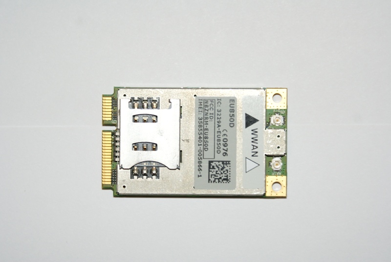

Mini PCI-Express Novatel EU850D - UMTS/HSUPA card with download up to 7.2MBps

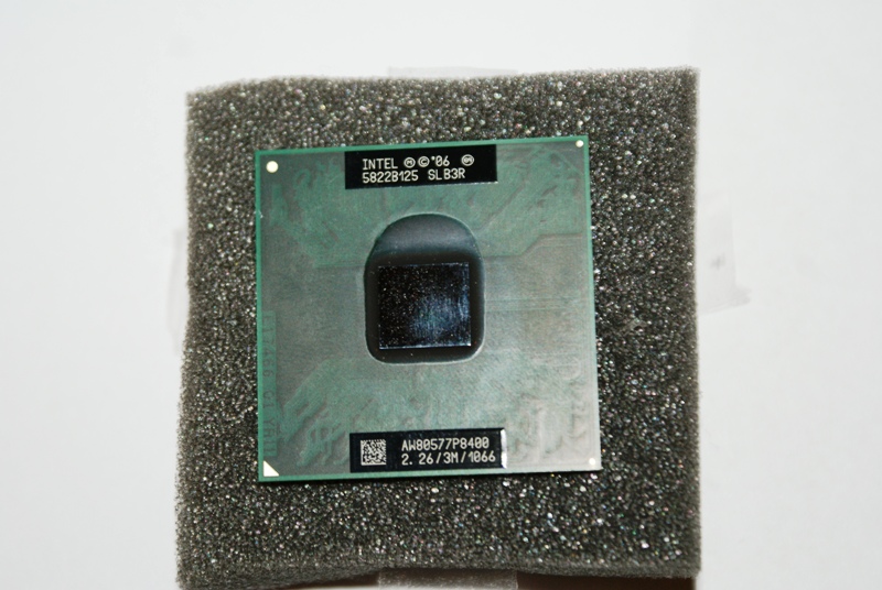

Processor: Intel P8400 (2x2.26GHz/3M/1066)

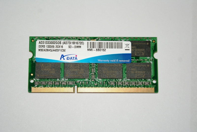

RAM: A-Data 2GB DDR3 1333(cas9) SO-DIMM

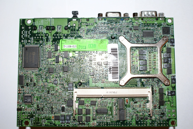

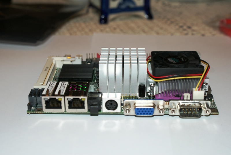

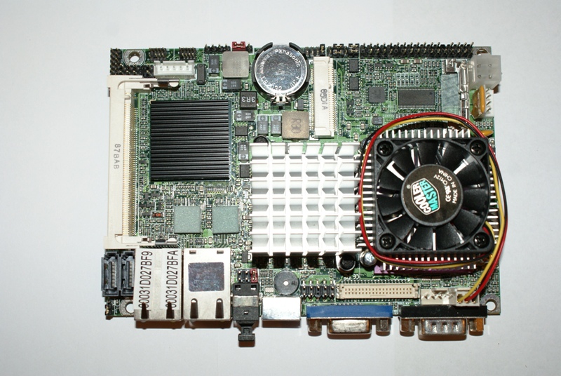

Motherboard: Commell LS-373 //content.invisioncic.com/y282845/emoticons/smile.gif.1ebc41e1811405b213edfc4622c41e27.gif

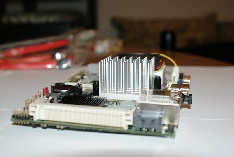

After 2 days searching solution, reading how work mini pci express, testing(Im install 3 diferent operating system - Windows 7, Vista and XP Pro) how to prepare my UMTS/HSDPA/HSUPA card that will normaly work. Im try 3 diferent SIM cards but for all Im receive that SIM is not inserted :S And then Im find simple solution:) You can see it in next picture:
Before this problem Im resolving next problem:
Commell LS-373 doesn't support minipci Type IIIA card!!! You can only use Type IIIB cards!!! Solution: Buying shorter wireless n - draft card:
Comparation new-left(Type IIIB) and old-right(Type IIIA) card:
