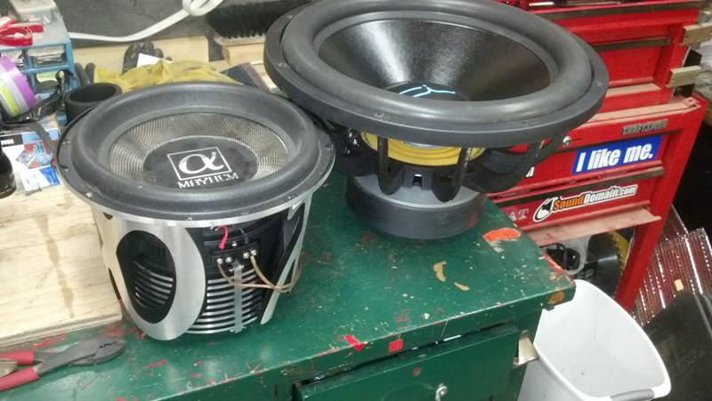

excellent topic. we have a 12 in there now and it's doing just fine. i'm not overly impressed with the cooling on the BL. it's pretty basic and old-school. nothing like the cooling on say, a ML3000.
sub in there now running fine (several years old)

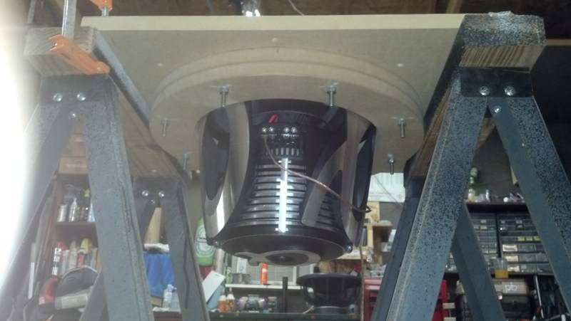

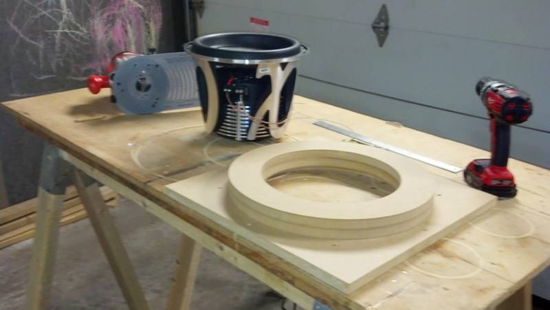

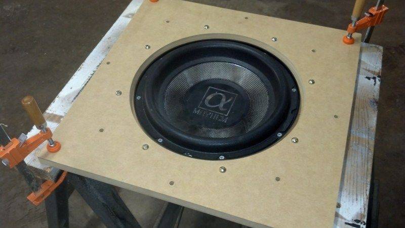

how i got it to mount using the holes for the 18:

Is that a mayhem? I buddy's got 4 12s still kicking
