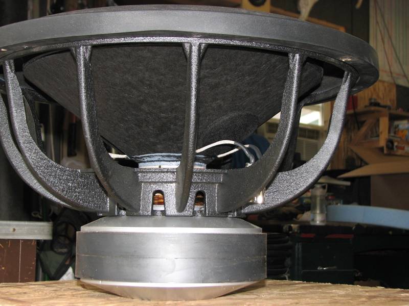

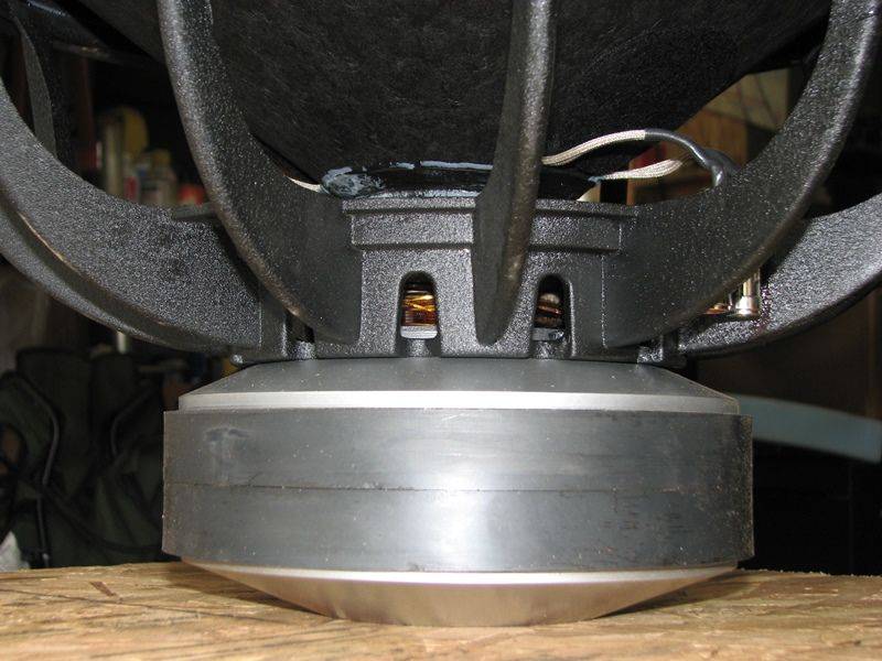

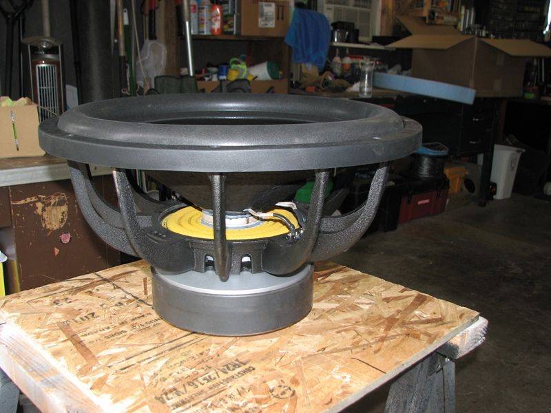

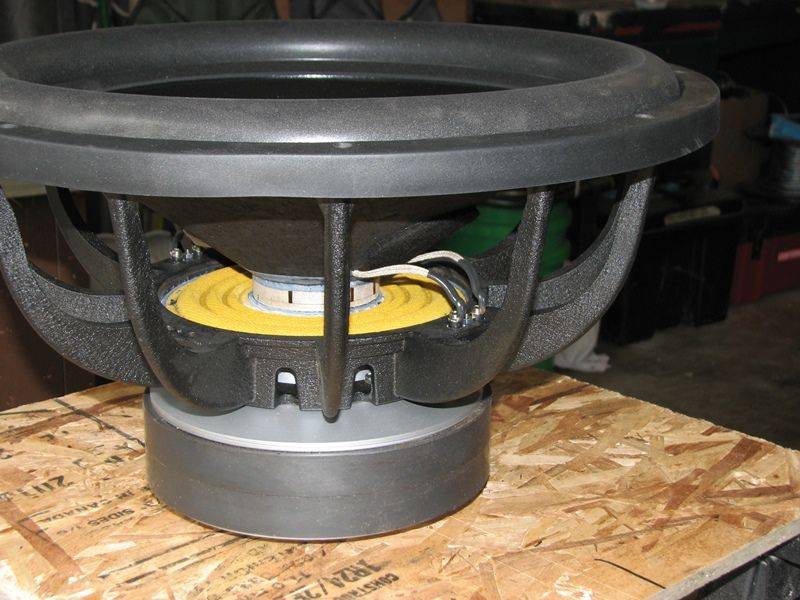

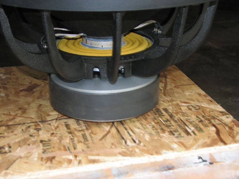

Fi Audio 18BL warranty issue - failed after an hour of use
bl uses a fatter 4 layer 3.250od alum coil with bout 2.250 ww.
i wanna see pix of the sub parts before i pass judgement.
Fi's fail most the time for ripped spiders or the leads damaged from being between the spiders.
Whatever it is its bad QC. I guess they needed something else since the spiders stopped catching on fire
Bad QC from whom - the company who assembled the product or the company who wound the voice coil?
I've reconed several subs with unwound coils for diff people. 8 out of 10 times it's clipping and the coil, or what's left is black. Other few times it's been thermal/over powering and glue heats up. These subs were seeing 2-3x RMS and playing music for extended periods.
My one question: wast most of the music/burps around 50Hz or so? If so did you notice very little excursion out of the sub as that will create a lot more heat with little to no movement to cool the sub.
Could just be a case of too much power/too little excursion and the sub overheated and let go. BL's aren't exactly killer strong subs...

pics are on a thumbdrive at work. i will post them once i get them off the drive.

i am curious if anyone else has had a coil let loose from the former, and what the circumstances were/are.
I have twice (and I break a lot of woofers), both 18" woofers, 5KW and up pushing hard, and they stunk bad before they let go.
Sounds like a lemon to me ....ive seen lots of spider issues but no coils lettig loose..esp on that power..and i kno this is far from ur first rodeo so id say they are just jewing u around ....every company no matter how reputable has issues like this..just ***** fi chose to go about it this way

how many have seen a coil unwind and what were the circumstances? how many have had a brand new sub fail within hours and why was it (besides pure SPL destruction purposes)?
obviously, to get the coils to unwind they need to be hot enough for the glue to let loose. the amps never went into protect and the coils aren't shorted. they weren't ran long enough to overheat from extended use (only pushed a few minutes at a time). if they coils were mis-matched, one coil would heat up more than the other. that is the only concrete evidence we have right now, mismatched coil DCR.
I've only ever had coils go slinky from gross abuse. I've had some subs break within a short time after building them, but that's mechanical from either me being abusive or trying to skimp on glue. Of course you would know if it was a glue issue.
My thoughts exactly, and a worthy topic. One of the reasons I don't like 18" woofers, really. Side by side a smaller cone will move more and cool better. I find smaller drivers hold thermal power noticeably better than larger (assuming same motor, coils, and suspension).
good questions. music covered a wide range and the tones weren't that long in duration. clipping didn't happen, i'm sure of that. scopes don't lie. and nothing was black, coil looks new just unwound.
there was plenty of cone excursion with initial testing around 50Hz, and i agree that the coil would heat up if the cone wasn't moving to create airflow to cool the coil.
maybe i need to take a closer look at cone behavior in the box and if the cone seems to "stall" around certain frequencies. even still, i would expect it would take longer, since the music was constantly changing and the tones were higher.
the intent is a daily system, not an SPL monster. Box is tuned around 28Hz. The sub in there now does just fine.
Coil does not need to look black to have failed from heat, though almost always you'll get some smell before they fail from over-heating. Consider smaller drivers move more on the same power and cool better.
If they are using 8-layer flat wind coils from Precision in Florida... the coil itself is 2.5-3x that much. A 4-layer round is still 1.5x that much if it's fairly long.
Either way -- they do use Precision coils at Fi; I am just not sure what type in that model driver -- Precision makes some of the best coils available and a coil that is simply defective is almost unheard of as far as a coil just sliding off of a former.
So that would leave us to figure out how the coil got so hot so quickly.
